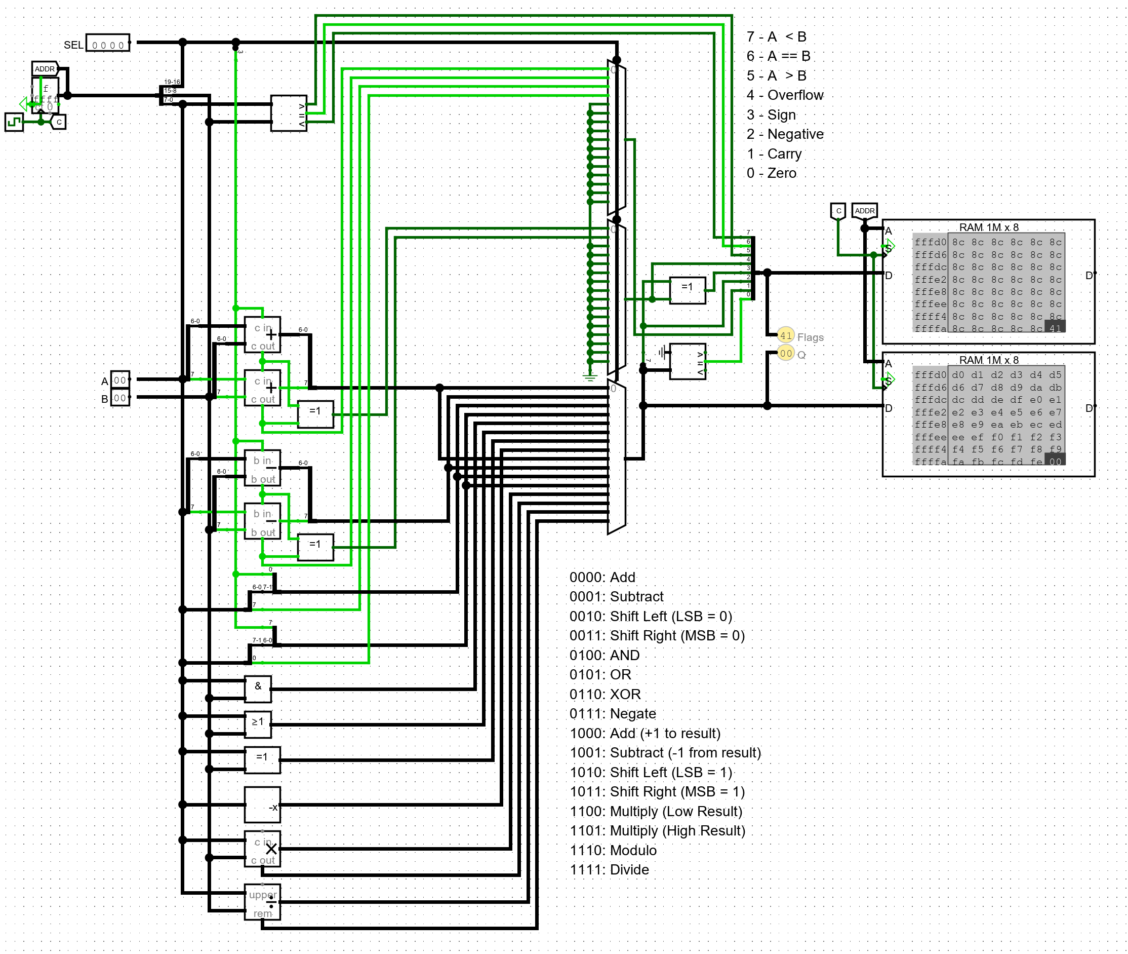

a RAM based ALU seems pretty doable. 512kx8 ICs are very common, cheap, and fast (usually 10-20ns).
Parallel Flash would also be an option, 55-70ns is not that bad if you aim for single digit MHz speeds. (plus while you don't need to preload Flash, you could still make it in-system-programmable via the 8153)
using 2x SRAM ICs in parallel to form a single 512kx16 chip (19 Inputs, 16 outputs) allows for a very basic 8 function ALU (Add, Subtract, Shift Left, Shift Right, AND, OR, XOR, Negate) with 2x 8-bit inputs, a 3-bit function selector, 1x 8-bit output, and up to 8 output flags. (i'd go with the basic Zero, Carry, Negative, oVerflow, and Signed Flags).
(the "Sign Flag" is from AVR and is just N XOR V, which makes some branches easier)
which should be more than enough functionality for a basic discrete Processor. main downside is that you have no carry input for rotates, Add/Subtract with Carry.
so those would have to be done in software or via special instructions.
alternatively, if you add 2 more 512kx8 Chips to get 1Mx16 (20 Inputs, 16 outputs) you can fit another selector bit, which can be used a pseudo Carry input when the selected function is Add, Subtract, Shift Left, or Shift Right. in which case the upper bit is used the carry input. but for all other functions the upper bit is just another selector bit, giving you the carry functionality as well as 4 additional slots for new functions.
in my case i added 8x8-bit Unsigned Multiplication and Division (which are very fast single cycle operations because there is no logic to run, only Memory to read from).
here an image of the described "2MB ALU" i built in Logisim, including a counter and some RAM components that were used to generate the binary files that could be written to Flash/RAM chips to implement it in a real circuit. (flags are described at the top, and selector bits at the bottom)
also it uses the 3 unused flags for basic input comparisons. no idea if it would be useful, but if you got extra bits you might as well use them.

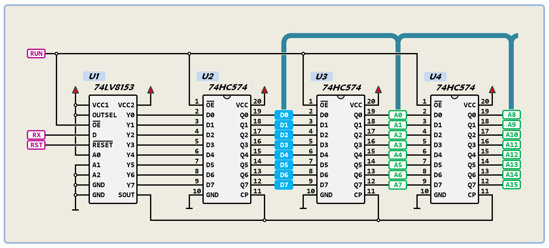

The 74LV8153 certainly is an interesting chip. Thank you for bringing it to our attention, Jeff. I also like your idea of using an '8153 to load a set of 74HC574's and I wonder if the timing would support loading them in cascade?
PostPosted: Wed Oct 04, 2023 1:29 pm
Posts: 3363
Hi, Michael. Nice idea! And I don't see any problem in regard to timing.
I like how this setup doesn't need any logic to individually address each of the 574's! On the downside, you will of course be obliged to send a full, 16-bit address every time, whereas with individual addressing you'd typically be able to increase speed by omitting the update to ADH 255 out of 256 times. But, depending on circumstances and priorities, this minor disadvantage may be deemed unimportant.

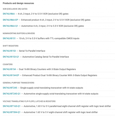

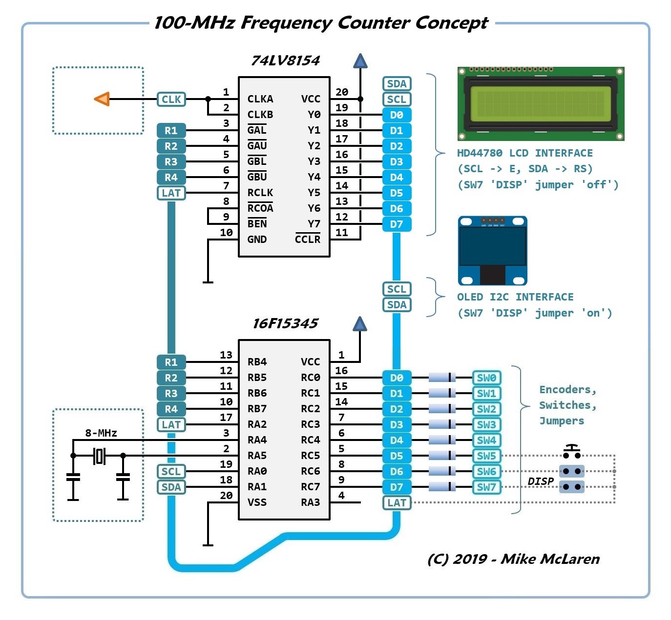

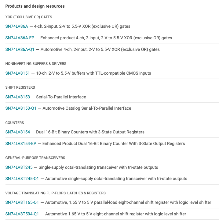

<Slightly off-topic, but...> is there a listing or data book somewhere describing the 'LV8000 series chips? I came across the 74LV8154 "dual 16 bit binary counter" IC a few years ago which, like the '8153, is also quite intriguing (to me) and now I wonder what other interesting ICs may be in this series.
PostPosted: Wed Oct 04, 2023 7:59 pm
Sticking "74lv8" into the search box on TI's website yields the following:
