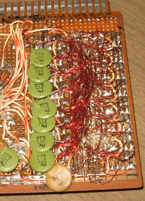

Dajgoro wrote:
I got 0.1mm copper enameled wire from ebay, and it looks kinda thin. It has about 3ohm/meter, and now i am wondering if it would work well if i used it instead of the ribbon cable that i usually use for building sbc-s.
.004"? That's less than half the diameter of wire-wrap wire. It sounds fragile. What did you have in mind doing with it?
PostPosted: Thu Nov 01, 2012 12:43 am
Posts: 808
Location: Croatia
Use it in places where ribbon cable would be impractical for point to point soldering(connecting 4 ram modules in parallel) or for some lines like r/w or phi2. I can always protect it with epoxy.
PostPosted: Thu Nov 01, 2012 1:05 am
Posts: 8541
I used that kind of wire on the board in the third picture at http://wilsonminesco.com/6502primer/WireWrap.html:
but I wouldn't do it again. It was too easy to break wires after they were soldered, while trying to access points to solder additional ones. If you're not making a printed circuit board, I would strongly recommend wire-wrap for digital circuits. Besides being less fragile, WW lets you get the wires shorter and straighter, improving performance.

It is thicker than the one i currently have, but in my case could there be any ac consequences from using such a thin wire(in our hi frequency sbc enviroment).
PostPosted: Thu Nov 01, 2012 5:50 pm
Posts: 8541
There are PCB traces with that width and even less thickness (.0014" for 1-ounce copper), so I think you'll be fine as long as you put the IC shoulder to shoulder (for short connections) and keep the wires fairly straight. Going really small affects the resistance a lot more than the inductance, and in this case mostly because of the skin effect, but it will be fine if none of your connections are more than a few inches long. Dr. Howard Johnson's articles on skin effect in high-speed digital designs are indexed at https://web.archive.org/web/20120302190 ... n%20effect .

Ok. Then i can use it to connect multiple rams in parallel, since using ribbon cable for that kind of thing gets really tedious and ugly.
