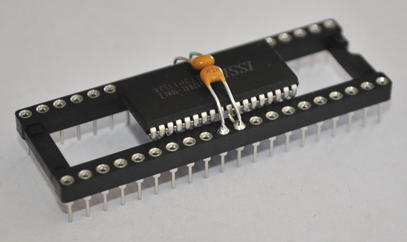

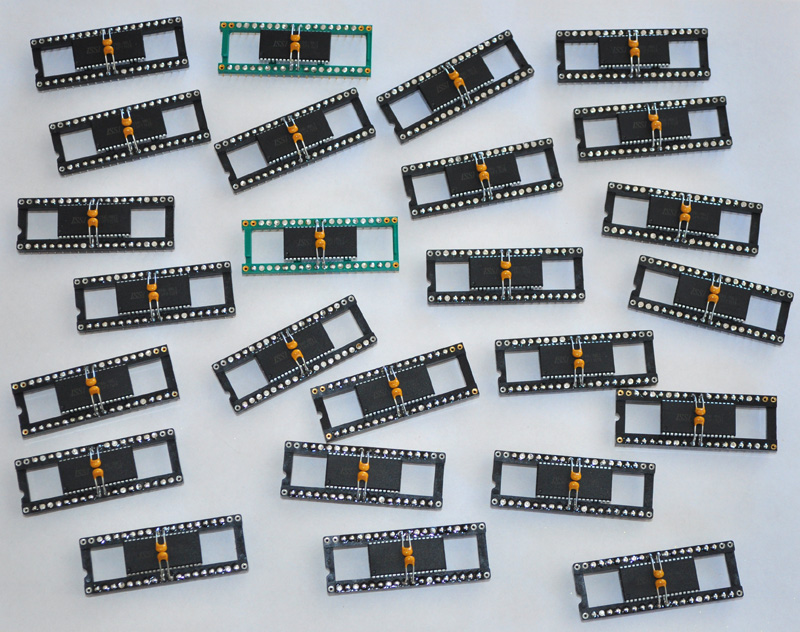

Since I am hosting a nasty flu, some quiet time in front of the wood-stove with 25 SRAMs has been very relaxing.
I actually made some progress, but the task does seem monumental!

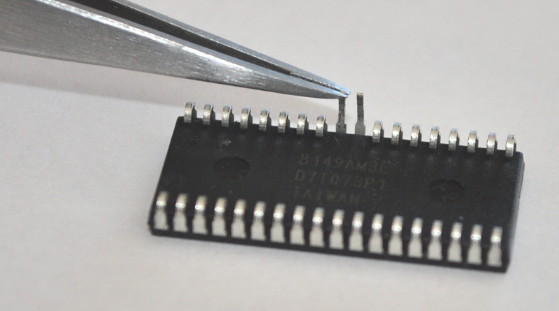

First, the middle pins are bent outwards (this is VCC and GND on both sides)...
Then, I add the decoupling caps on each side and bend them towards the IC...
I then add solder to each of the socket pins and onto the IC pins.
So far, I have all 25 SRAMs on their sockets...
Now the task of cutting 900 tiny wires to connect all the pins to the DIP sockets!

I am cutting the wires now, and have it down to assembly line speed!
Brad

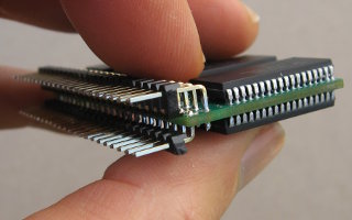

Or you could use three of my 4Mx8 5V 10ns SRAM modules (each one using eight Cypress CY7C1049D-10VXI 512Kx8 5V SRAMs, four
on each side), now available with .300" row spacing.
PostPosted: Sat Mar 11, 2017 10:09 pm
Posts: 8507
Are you referring to the SRAM packages?
PostPosted: Sat Mar 11, 2017 11:01 pm
Posts: 8544
No, the module itself. I was reluctant to do it, but due to demand, it's now available (for $10 extra, since it's more work for me). The picture shows the module pins with .300" row spacing. The SRAM ICs are still SOJ.

These are the ones I am soldering down right now.
Actually just finished the first one, and it has passed the video test.
Now that I have all the wires cut, it looks like I can complete one SRAM every half hour or so.
If my flu hangs on, I may just go at it all day tomorrow. Only 12 more man-hours of soldering!

3 Working SRAMs mounted now. It's very relaxing work, and a great way to spend a flu weekend.
Brad
