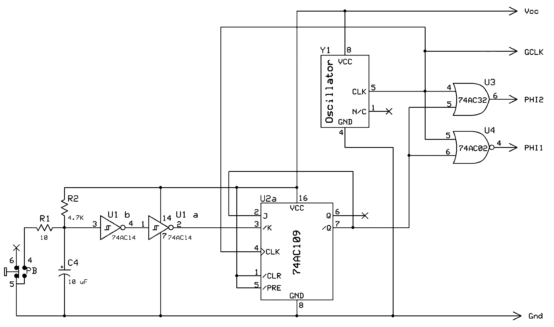

PostPosted: Sat Oct 28, 2023 10:17 pm
Posts: 8503
Restlessness in the middle of the night caused me to think some more about this clock situation and how to make a circuit that would be faster to respond to the need to stretch the clock during a ROM or I/O access.  When I wake up during the wee hours and it’s not due to a call of nature, I go down to my office and work on something until sleepy.  So it was with the clock thingie.
File comment: Alternate Stretchable Clock Generator
Above is a one-wait-state test circuit that I may build to see what happens.  For easy of construction, I would tap into my supply of PDIP gates.  A practical application would likely use some of those dinky 1G gates to save space and reduce prop delay to a low single-digit value—although prop delay is not really a concern if it’s roughly the same for both clock signals.
Incidentally, the observant will note that GCLK will slightly lead Ø2 in the above circuit.  That lead could be minimized by deriving GCLK from yet another OR.  I think that leading signal would be more a concern in a system that has a VIA or other 65xx silicon that is slaved to Ø2.  I’m thinking the lead shouldn’t upset the wait-state timing, since the 109 flop’s response time to a low on /K when GCLK goes high ranges from 3ns to 9ns on 5 volts.  If it does prove to be an issue, then I would insert the OR into GCLK.
PostPosted: Sun Oct 29, 2023 1:14 am
Posts: 741
This looks pretty fast, and even slightly simpler than V1.3's I think - at least, using more primitive gates!
I don't think GCLK leading PHI2 will upset the timing per se, but I think this circuit still requires being sure about the need to wait-state long enough in advance of the rising edge of PHI2. I guess the Schmitt triggered inverters won't be there in the final circuit, so your wait-state enable signal just needs to satisfy the setup time for the 74AC109, ahead of GCLK, which also leads PHI2's transition by about one 74AC32 gate delay. So I think the sequence is:
GCLK falls => 74AC32 gate delay => PHI2 falls => 65C816 bank/address delays => decoding propagation delay for /WSE => 74AC109 setup requirement => GCLK rises => 74AC109 clock triggered
And that needs to fit within half a GCLK cycle.
I don't think you used GCLK externally in V1.3, but adding the extra OR gate might help here within this circuit by delaying the 74AC109's clock being triggered, giving you more time for the wait-state enable logic to complete. It doesn't seem necessary to align with PHI2, it's probably OK and even beneficial to delay even further. There's a limit though, because of course you still need the address decoding to be more or less complete before you start anything like a RAM write operation - the value of a delay here is just to cover the cost of the wait state logic.
PostPosted: Sun Oct 29, 2023 3:43 am
Posts: 8503
gfoot wrote:
This looks pretty fast, and even slightly simpler than V1.3’s I think - at least, using more primitive gates!
One paper, it is faster and also less timing-critical, since the prop time of the (N)OR gates is largely irrelevant.  As long as the 109’s /Q goes high at least one (N)OR prop time before the next fall of Ø2, the clock will be held in the Ø2-high condition in time for the next cycle.
I don’t think GCLK leading PHI2 will upset the timing per se...
However, I think GCLK leading Ø2 could (theoretically) result in a glitch in the middle of the stretched cycle.  The critical condition would be if the 109’s tPLH on the /K input was at the fast end of its spec (~3ns) and one of the gates was also fast.
...but I think this circuit still requires being sure about the need to wait-state long enough in advance of the rising edge of PHI2.
Yep, that requirement still exists.  However, everything is now running at the oscillator speed, which is the same as the unstretched Ø2 frequency.  That provides some timing relief to the glue logic.  In V1.3’s circuit, with the AC74 flop subdividing the oscillator, the 109’s Q has to go low at least the AC74’s /PRE prop time before the rise of the oscillator signal, which is transitioning at Ø2 × 2.
I guess the Schmitt triggered inverters won’t be there in the final circuit...
Correct.  The Schmitts are there only to debounce the push-to-test button.
...so your wait-state enable signal just needs to satisfy the setup time for the 74AC109, ahead of GCLK, which also leads PHI2’s transition by about one 74AC32 gate delay.  So I think the sequence is:
­¡Exactamente, amigo mío!  Only, with this circuit, a GCLK half-cycle is the same duration as a Ø2 half-cycle, so the timing is more relaxed.
I don’t think you used GCLK externally in V1.3...
I didn’t, because there is no 65xx I/O hardware.
...but adding the extra OR gate might help here within this circuit by delaying the 74AC109’s clock being triggered, giving you more time for the wait-state enable logic to complete.  It doesn’t seem necessary to align with PHI2, it’s probably OK and even beneficial to delay even further.
As I previously noted, as long as the 109 responds before the end of Ø2 high plus a gate delay in the first of the stretched cycles, the circuit should fly.
When I build the test rig, I’m going to arrange things so I can insert one or two of the extra OR gates in series with GCLK to see what happens with varying GCLK’s phase relative to Ø2.  The logic analyzer should tell the tale.  :D
I've moved further blather about this clock stuff to Generating Wait-States with Clock Trickery, since clock generation of any type per se is not specific to my POC contraptions.
