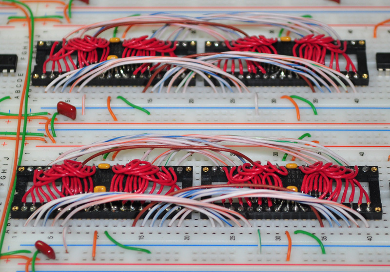

There are 2 ways to get a 16 bit SRAM : using actual 16 bit SRAM, or by doubling up on 8 bit SRAM. I chose the later.
A series / parallel configuration to create a 1MB x 16 SRAM.
SRAM can be connected with the data bus in series or parallel to create just about any configuration.
Four 256K x 16 SRAMs make up a 1MB x 16 memory when their CE lines are tied together with a 2-4 decoder.
In my case, I paralleled the address busses on two 512K SRAMs, and then used their data ports in series.
I then tied their CE lines with an inverter so that I had a 20 bit address bus and a 16 bit data bus (1MB x 16).

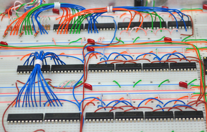

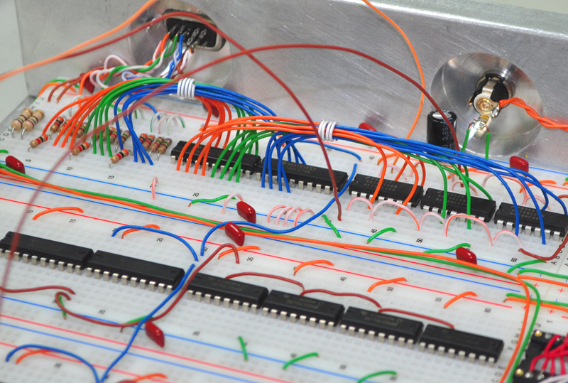

The photo above shows the color bits as being Red, Green and Blue wires.
To "sync" up the blanking time with the pixel clock, color bits are ANDed with the pixel clock using the 74HC08 AND gates.
After syncing the bits through the AND gates, they are then driven out to the DAC through the two 74HC574 registers.
This system has worked perfectly in all previous designs as well. Even a 1ns delay between blanking and pixel is highly noticeable on the screen!

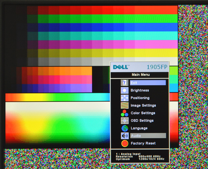

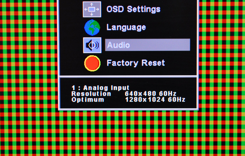

After doing some successful testing with 640x480 resolution, I decided that 400x300 resolution was better for a game system.
The main goal is to deliver high speed Sprites and Images, and at 640x480, the number of pixels per screen is so much larger.
Although the VGA Generator worked perfectly at 640x480, the amount of SRAM required was huge, and the frame rate was much lower.
Now that I have 4096 colors instead of only 256, the image quality will stlll be much better, so I settled back to 400x300 resolution.
As shown above, the monitor had no problems with 640x480, although I would say this is the upper limit for 74HC logic!

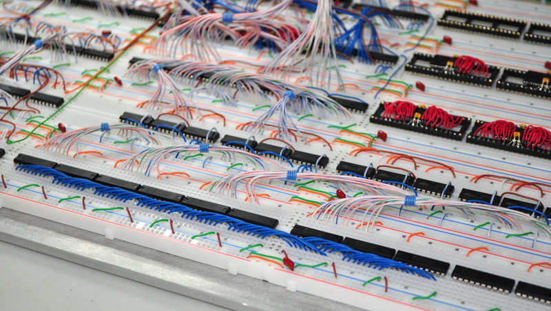

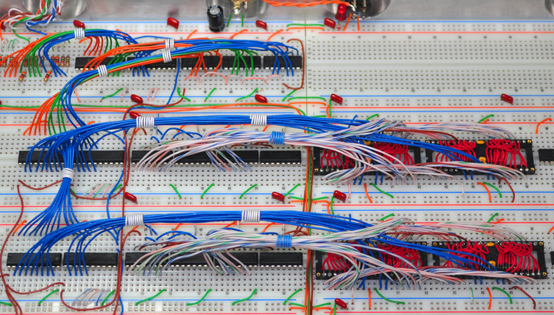

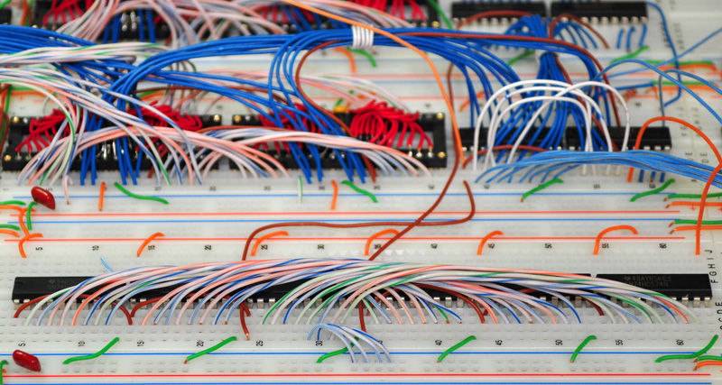

One of the most time consuming aspects of bread-boarding a 16 bit, high speed Video Game System is... so many wires!
In the photo above, I have connected the switchable address counters to the double Video Memory Banks.

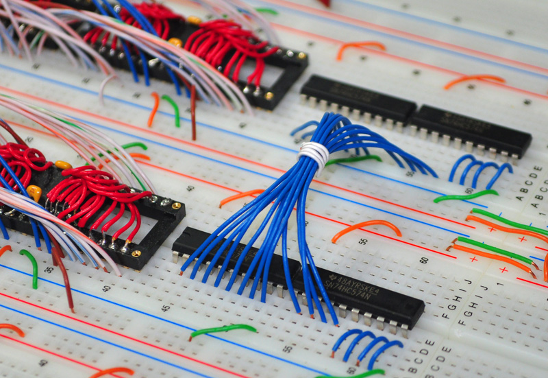

Connecting the Data Bus Switches to the Video Memory.
When the counters to the left of the SRAM are active, the 74HC574s to the right are disabled, and the opposite is true for the other bank.
The photo above shows the 12 Data Lines that feed into the Video Memory Bus Switch.
Only 12 bits ever reach the Video Memory, since the other 4 special bits are used internally by the Sprite Generator.
The completed Dual 12 Bit Switchable Data Bus.
As you can see, I always use Blue wires for Data Lines, and White wires for Address Lines.
Brown wires are control lines, and the VCC and Ground connections are Red and Green.
The single Brown wire shown heading into the Bus Switch controls the SRAM Write Enable Line.

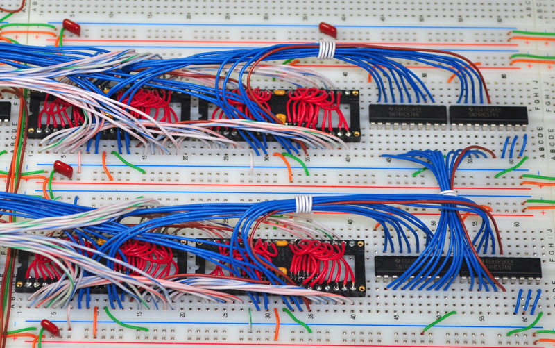

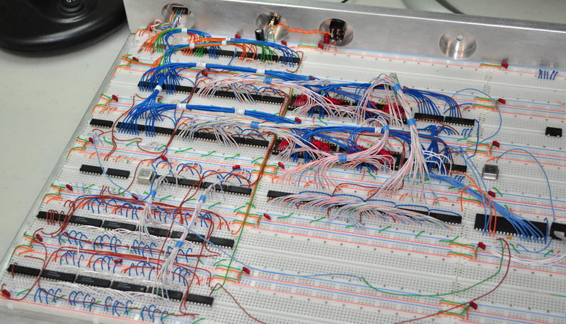

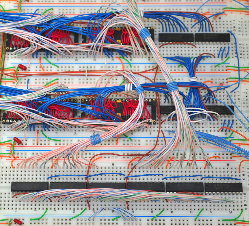

Adding a Switchable 18 Bit Address Bus.
The six 74HC574s shown above will create a switchable 18 bit address bus into the double buffered Video Memory.
The address is split into X (9 Bits) and Y (9 Bits), since the addressable box is 400 x 300 pixels.
Just like the 574s the swap the Data Bus, these 574s do the same with the incoming Address Bus from the GPU.
This switch works along with the Counter Switch, making sure only opposing sets are active.
The Complete Address and Data Switch into the Video memory.

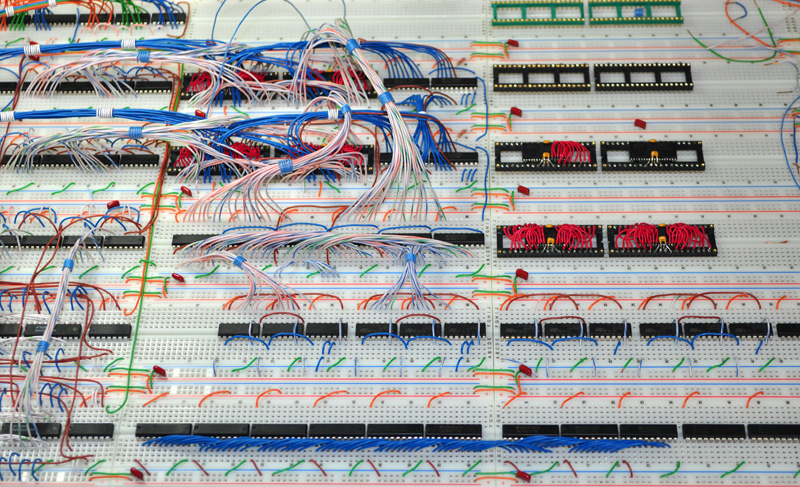

Did I mention that this type of prototyping requires a LOT of wires??
I cut every single wire to the required length by hand, and then bend them into shape for a neater appearance.
Does it really matter if the final wiring looks neat?... it does to me!
Perhaps this careful planning of wiring is why my breadboard can run reliably up to 32MHz? Who knows!

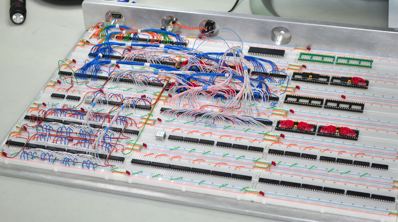

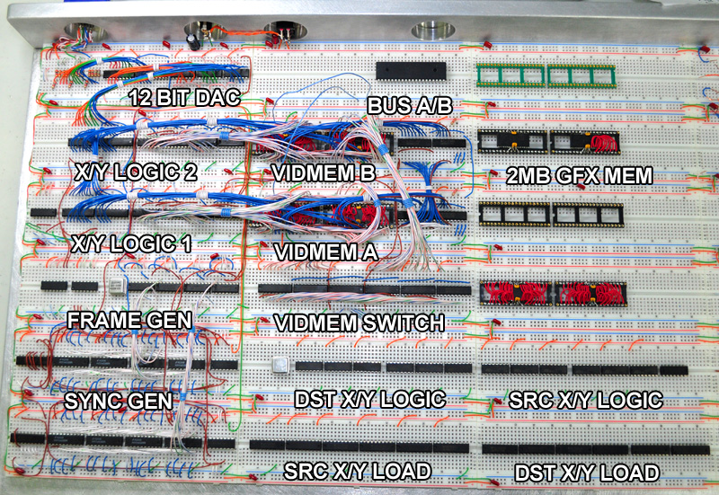

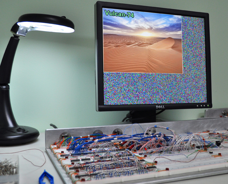

The New 4096 Color Video Generator is now ready for testing..
The only part of the entire design that remains original are the bottom left 2 rows of X/Y comparators.
Everything else is completely redone, and rewired from scratch.
The photo above shows the bare-bones VGA Generator along with the input switch that the GPU will connect to.
For testing, I put my 6502 simulator (AVR 1284) back on the board and loaded it with a 12 bit image.
The AVR pretends to be a 6502 by emulating the address, data, and RW lines of a 6502.
Using the AVR for testing is nice because I can directly load it from the PC, and it has 128K of internal EEPROM space.

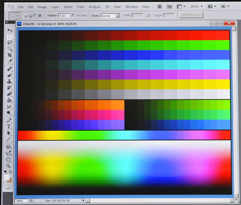

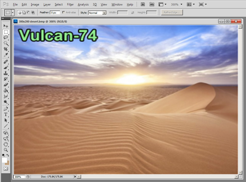

Now for some real image testing. At this point, I did not even know if the new 4096 color VGA Generator would work!
A 12 Bit Palette image to be used for testing.
I found a nice bitmap showing a 12 Bit Color Palette online, and saved it as a 300x200 image from Photoshop.
There as certainly a much richer variation of colors in the palette when compared to the limited 256 (8 bit) palette.
I also recoded my Sprite Converter Program to handle the conversion of 24 bits to 12 bits.
This program takes any Bitmap and then spites out assembly or C data that can be store in a micro-controller.
4096 Colors looking great on the new Vulcan-74 VGA Generator!
it was a pleasant surprise to see the new Video Generator come up for the first time and display an almost perfect representation!
The monitor reported 800x600, which is what my timing is generating, and the colors looked the same as on the original PC image.
The random pixels shown around the image are there because an SRAM contains random data when it is initially powered up.
Proof that 4096 colors could be displayed has now been confirmed!
Another image to be converted and displayed.
The color palette looked so good that I needed to try a previous image so I could compare the difference.
The image above was displayed on the old version using only 256 colors, and it still looked pretty good.
Most of the small variations in color shades were lost though, and the image almost looked "posterized".
As you can see in the 24 bit original, the image is perfect as seen on the PC monitor.
Vulcan-74 displaying a very clean 12 bit image.
When converted and loaded through the 6502 simulator, the resulting image looked great.
There is no comparison... 4096 colors blows 256 colors away by a huge margin.
The image being displayed on Vulcan-74 looks almost as good as it does on my PC monitor.

Here are the new chips that comprise the Sprite Generator...
Planning a new silicon subdivision in Vulcan City.
The 43 new ICs outnumber the 40 ICs that make up the VGA Generator now.
The Sprite Generator is basically 2 large high speed X/Y counters that are "content aware".
Content aware meaning that alpha color and X/Y status are actually stored in the sprite data now.
Hopefully, this new design will translate well from paper to breadboard as it is a LOT to wire up!
Here is what each row of ICs currently do in the new design...
Each row of ICs have a specific job to do.
SRC and DST stand for Source and Destination.
Source Memory is the Sprite SRAM, and Destination is the VGA Memory (dual buffer).
You will notice that only 2 of my 8 SRAMs are presently wired to the sockets.
This is a time consuming job, and I have just finished cutting the other small 320 wires required.
In the old design, the Sprite Generator only had two 512K SRAMs, and now there are 8.
To get 16 bit SRAM, I have to double them up, and this time I also want twice the memory.
Expecting a massive speed increase, I am merging the PLayfield Generator into the Sprite Generator.
Image being able to scroll a huge 2048 x 1024 bitmap with 4096 colors around as a game background!
Even my current PC probably couldn't do it at 60FPS without missing a beat here and there!

The second row of chips from the bottom make up the Source and Destination X/Y counters (12 74HC163s).
The row of 12 chips at the bottom are needed just to allow latching of the reset (Load) data into the counters...
Adding the Counter Reset Registers.
Since the data to Load/Reset has to be present during a clock transition, it all has to be latched by the 6502 first.
The Blue wires represent the 8 bit Data Bus, and the white wires are address / counter outputs.
Destinations Counters connected to Video Memory.
The Address, Data, and WE lines are all fed into one last row of 74HC574 latches before hitting the SRAM.
I am still adding wires to do a basic test of the counters and latches.
Once I know what kind of speed to expect, I will add the automatic X/Y Wrap / Reset control logic.
