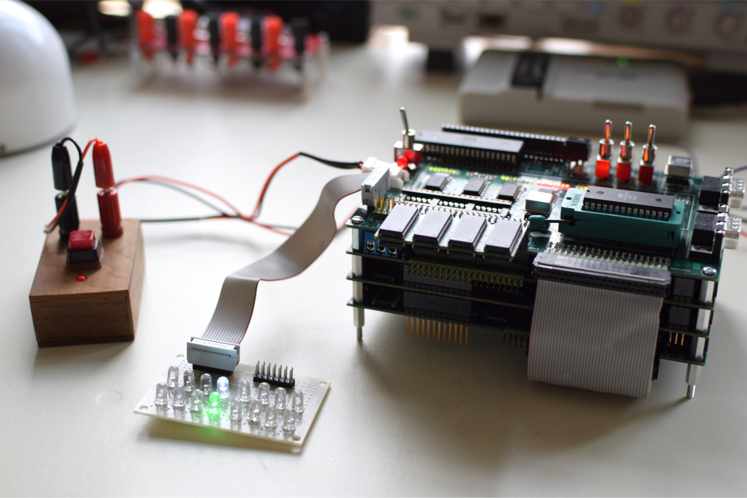

From the point of view of the project, going to 16-bit registers would have required reworking the guts of the CPU. Adding an extra 8 bits to the address bus, on the other hand, was very manageable and could be achieved through an optional PCB. ttlworks did a great job of pulling out just the right bits of 65816 functionality, and the result is a very nicely enhanced 6502 that can access lots of RAM. I like BigEd’s “K24-6502”, which is an apt name for it.
I have now added Garth’s 4MB WM-1 module to the mix, and extended the tests to use it. Here is a pic of the SBC stacked on top of the CPU, and the WM-1 module installed (shown just right of center). The LEDs flashing indicates a successful test.
Note the ribbon cable carrying the ADX (Extended Address Bus) from the K24 card at the bottom of the stack to the SBC on top.
There is a bug in the address decoder of the SBC, so only the first 16 banks of 64k are addressable at the moment. Still, it proves the point and I can now move on. Next step is to test the SPI port. Currently contemplating using this nifty accelerometer/gyroscope as an easy-to-get-working but kinda cool device for testing. It’s 3.3V, so some level-conversion will be necessary. Still, could be lots of fun, which is after all the whole point! :)

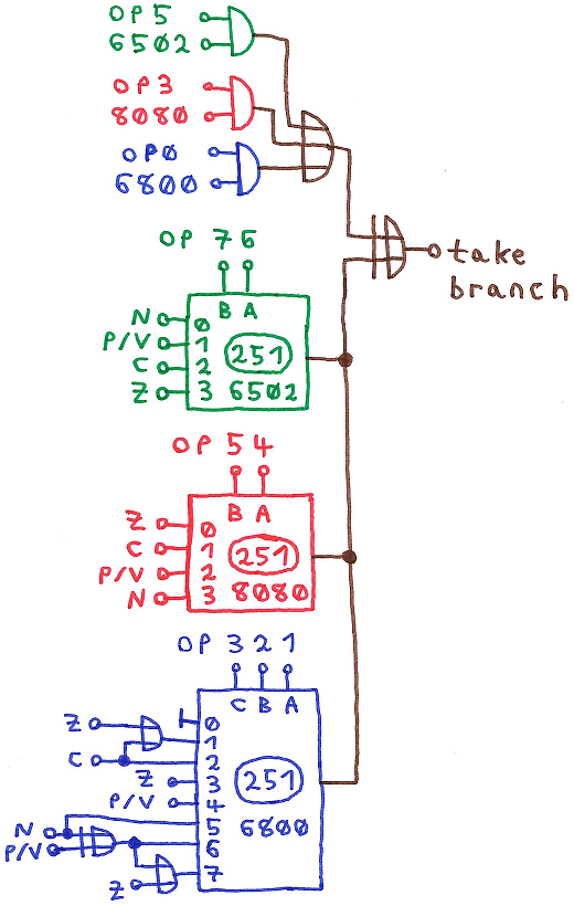

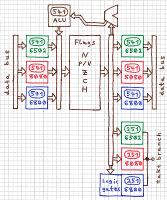

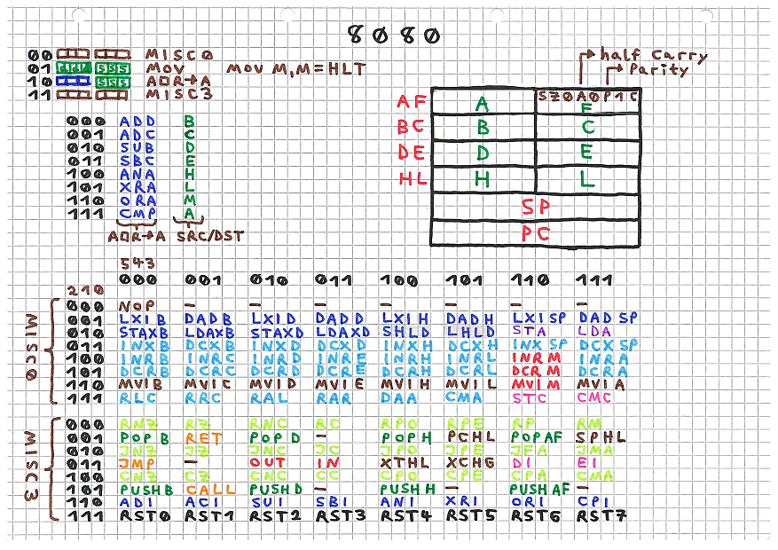

But just in case he goes for it, I would like to put a provoking thought to discussion here.
With K24, we have a mechanism for switching the instruction set (selecting a different microcode)
during run time... but it all is 6502 related.
What, if one would be trying to switch to a non_6502 related instruction set ?
I'm not talking about trying to be cycle or timing compatible to a non_6502 CPU,
it's just about the possibility of being able to run the legal instruction set of a non_6502 CPU.

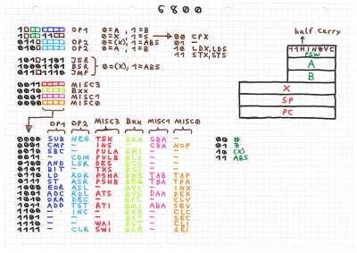

Let's start with the 6800.
Simply because the design team that did the 6800 later had some 6502 relevance...
Unlike the 6502, 6800 is big endian (high Byte first).
Stack operations seem to be post_decrement and pre_increment, like with the 6502.
What happens during the interrupts still needs to be investigated.
Conditional branches are a little bit more sophisticated than with the 6502,
on the other hand there is no decimal mode: just DAA and a half carry flag.
To me, the rest of the 6800 instruction set looks somewhat trivial:

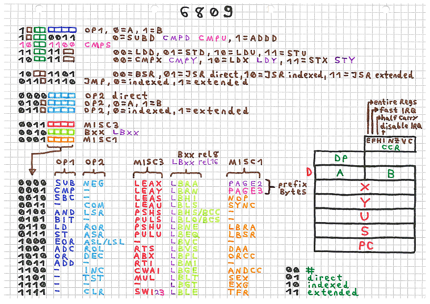

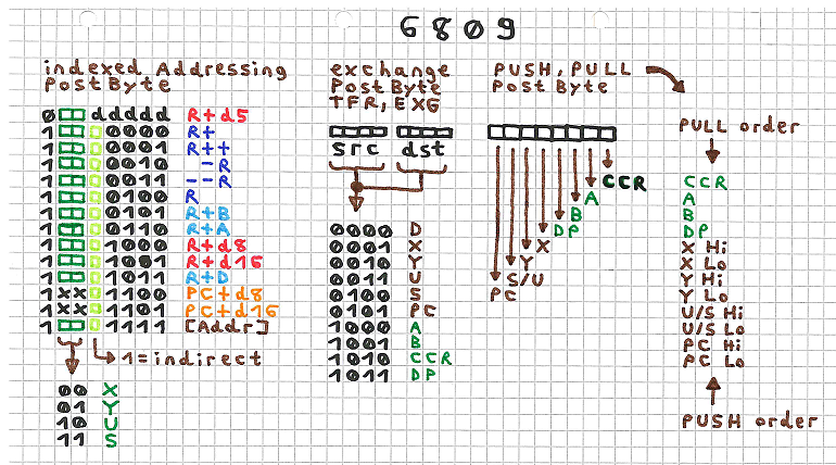

6800 would open a vector to implementing something like the 6809.
A TTL CPU designed to run the 65816 instruction set almost would have enough registers for a 6809 emulation.
6809 is big_endian, too.
But unlike with the 6502 and 6800, Stack operations seem to be pre_decrement and post_increment, like with 68k.
6809 is NOT binary compatible to 6800, because some of the opcodes have moved places in the table.
6809 is a complicated beast, with two prefix Bytes, and with two post Bytes (PUSH\PULL, and indirect addressing).
Some time ago, I had sent BigEd a scan of a flow diagram from SGS Thomson about the EF6809 bus activity,
which (to me) looked complete, and it was rather big.
IMHO the microcode sequencer of the TTL CPU we have now won't be up to the task of cutting something like this:
8080, and sorry for posting this heresy in "the 6502 forum of all 6502 forums".
Just ahd to post it because the C128 has a Z80 inside for running CP/M.
A TTL CPU designed to run the 65816 instruction set almost would have enough registers for an 8080 emulation.

Now for a crude block diagram for the status register area of a hypothetical TTL CPU,
able to run 6502, 6800 and 8080 machine code.
We need an additional flag, the half carry flag.
Regarding the Z80, the V flag we know from the 6502 now also works as a parity flag.
//Parity checking could be done with a tree of XOR gates tied to the ALU output).
Basically, the "data bus connection" for the Bits of the status register just is "formatted"
by using buffers to fit to the CPU instruction set which currently is selected.
A crude (but more detailed) block diagram for handling the conditional branches,
which BTW does not include the 65C02 "test Bit and branch" instructions.
