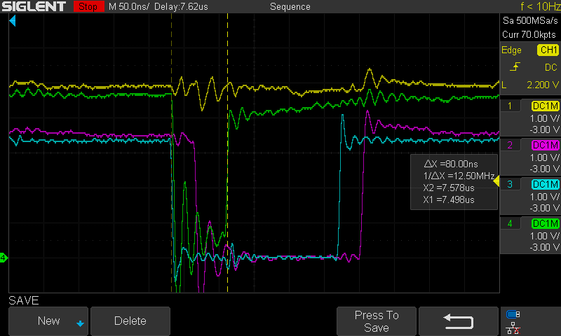

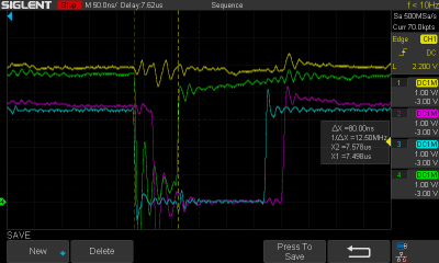

It’s been a busy few weeks, and the focus continues to be testing with the Commodore 64. I’ve now worked through quite a few games from various “best of” lists, and TTL CPU has run everything I’ve tried! :D I have a 1541 Ultimate cartridge on order to be able to run a few of the more demanding demos as a final test, but all indications are that the CPU is indeed cycle-accurate at this point.
Speaking of cartridges, sjgray had mentioned at WoC that the C64 EasyFlash 3 Cartridge by Retro Innovations would make an excellent test case. (Thanks for the tip Steve!). Well, he was right; I finally got my hands on one and indeed the TTL CPU failed to work with it. (For those interested, the cartridge’s function and logic are explained in detail in this brief paper by Thomas Giesel. It’s very clever).
In a nutshell, EasyFlash replaces the C64’s Kernal ROMs from the expansion slot. To do so, it takes over the bus during Phase 2 to (among other things) interrogate the state of the internal memory map in the C64. It does so by pulling A14 low and watching /ROMH on the expansion port to get its result. It then releases A14 to let the CPU complete the memory access. Here is a what that looks like on the scope with the 6510 installed (A14 in green, /ROMH in red):
By contrast, here is the same trace with the TTL CPU installed:
A14 goes low with the TTL CPU, but there's *a lot* of oscillation on the signal and the voltage settles at around 2V! That’s kinda no man’s land, and could easily be read as a “1” by the C64’s TTL level logic. Indeed it looks like that’s exactly what happens, and /ROMH remains high and the cartridge fails.
Kicking it around with ttlworks and dr Jefyll, we theorized that this was evidence of a collision on the address bus on A14, with the cartridge pulling low even as the CPU pulls high (AEC is high throughout, so the CPU’s bus driver is definitely active). The cartridge seems to be simply overwhelming the weak NMOS driver on the 6510 to land at a logic 0, but fails to do the same with the 74AC541 in the TTL CPU.

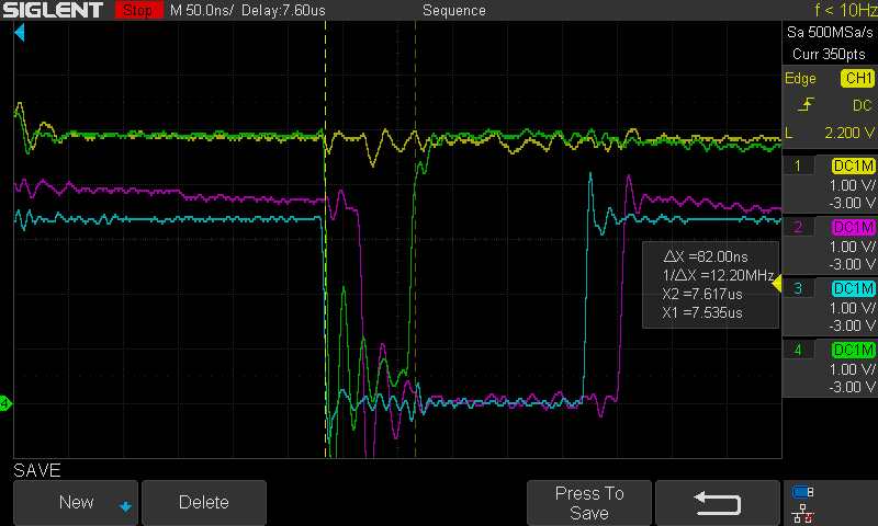

The solution was to install a 100 Ohm series resistor on the A14 pin at the CPU to “weaken” it a little. Here is the capture with the resistor in place:
A14 is being pulled low much more decisively now, and /ROMH reflects that. It’s an almost perfect match to the 6510, and the cartridge now works perfectly with the TTL CPU. :D Looks like it wil be worthwhile to allow for some series resistors on the socket adapter of the CPU to better emulate the NMOS “weak” drivers. The objective here is to be “pin-compatible”, so I’m glad we caught this detail.

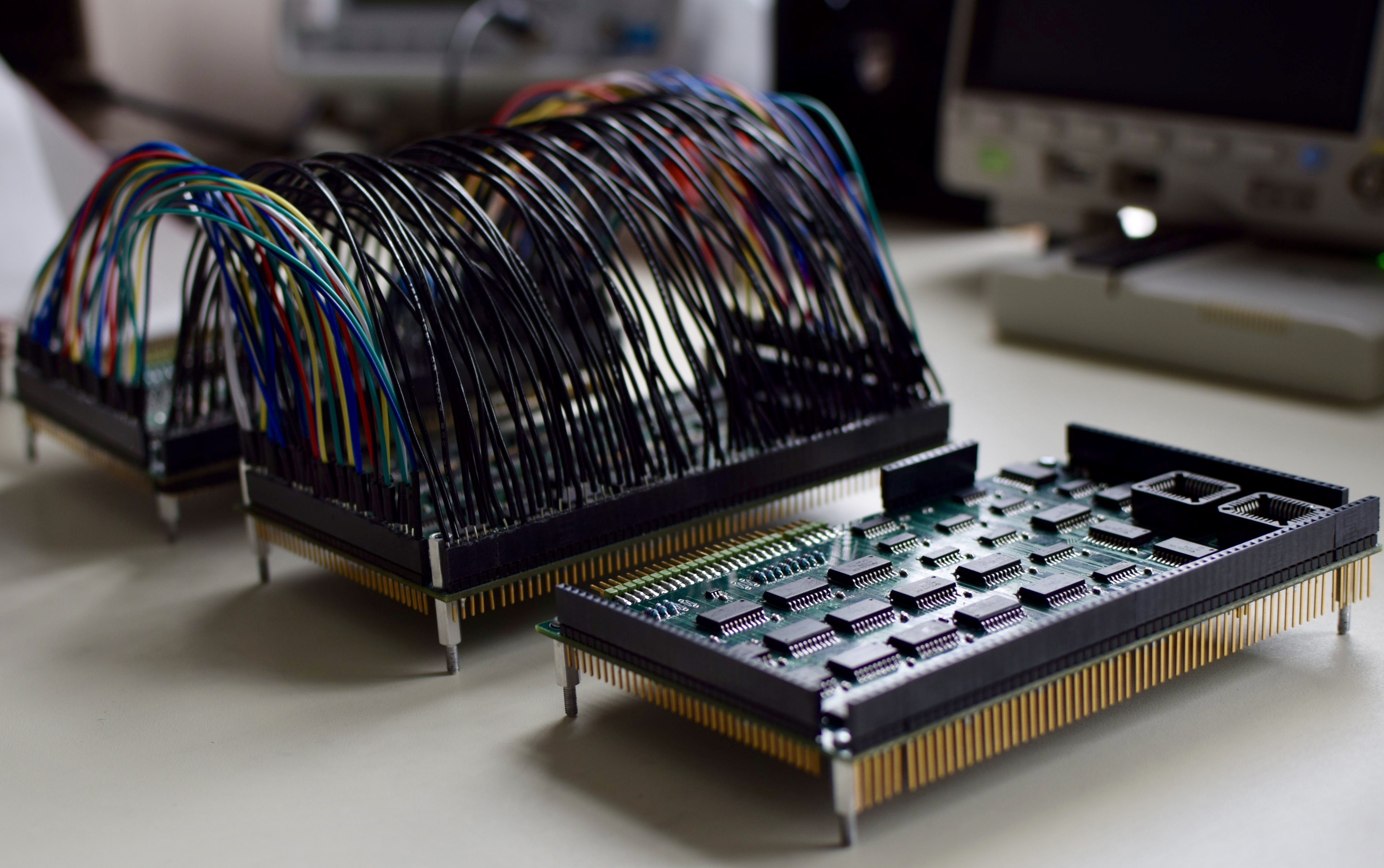

Beyond that, I’ve made a solid start on the K24 card, and nearly completed assembly. I’m still awaiting the arrival of a 74VHC27 IC which has since become an out-of-stock item from the usual sources. I’ve used this IC (a 3-input NOR) in the other cards as well, so I’ll have to pick a suitable replacement for the final iteration of the CPU. It is a bit distressing to see these chips go out of production. (Toshiba seems to be manufacturing it still but in a TSSOP package only). Anyway, it’s the first time I see this happen so I was more than a bit surprised.
Incidentally, Dr Jefyll suggested I take a look at https://www.findchips.com, which turned out to be a great resource. You type in a part number, and it shows you a list of suppliers, along with pricing and current inventory. Very handy. As a last resort, I do have a 74HC27 I can use. It will be slow in this design, but at least it would allow me to get K24 tested, even if at slow speeds only. Hopefully, the part will arrive soon and I won’t have to resort to that.
In the meantime, here is a pic of the new upstart, eager to join his peers in the line of duty:
