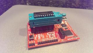

I too can confirm that the green 3M ZIFs are poor quality. One came fitted to my programmer, and I have to do the scrape trick too, a lot of the time. I thought that was an isolated incident. I might consider retrofitting a better one now that I know it isn't, because it's a decent programmer, otherwise.

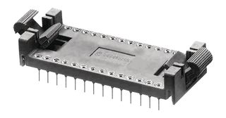

Not sure if it helps but I've been using an Aries Eject-a-dip for my ROMs which is a bit cheaper than their ZIF sockets.
Haven't had any problems for the last couple of years with these, It also does a good job of holding the DIP plug in for my rom emulator

Yep! I'm familiar with that part. Unfortunately, it hogs quite a bit of space on the board, as clearance has to be provided for the ejection levers. It won't fit on any of my POC designs.

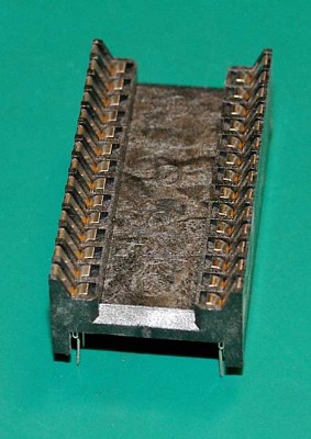

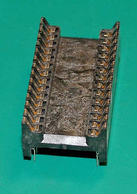

In future endeavors of this kind, I will solder the ZIF socket into the prototype's PCB instead of piggybacking it on the ROM socket. The only reason I didn't do that with POC V2 was the frugal Irishman in me didn't want the 15 dollar ZIF socket becoming a permanent part of the assembled unit.
I have had some luck with using the $1 (or so) cheap 3M knock-offs in prototypes. For the price they usually work long enough to get things working, then I don't mind tossing them when I'm done.
I also found a stash of these on eBay a few years back. I only have about 8 left and don't know where to get more of them, but they are fabulous for EPROMS and endure countless insertions without failing or harming the chip. They are marked only with a stylized Robinson Nugent "RN" - no part number.
