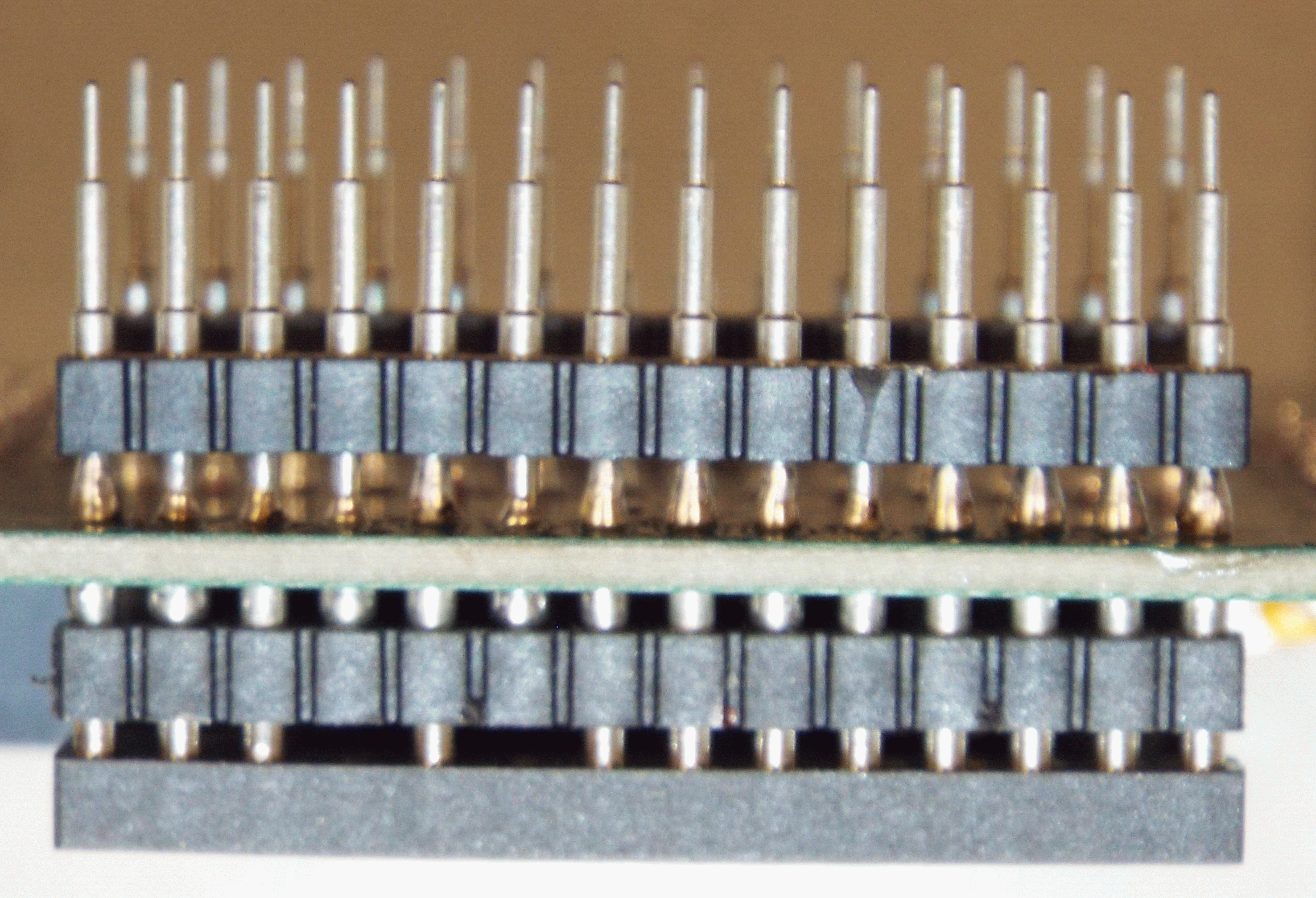

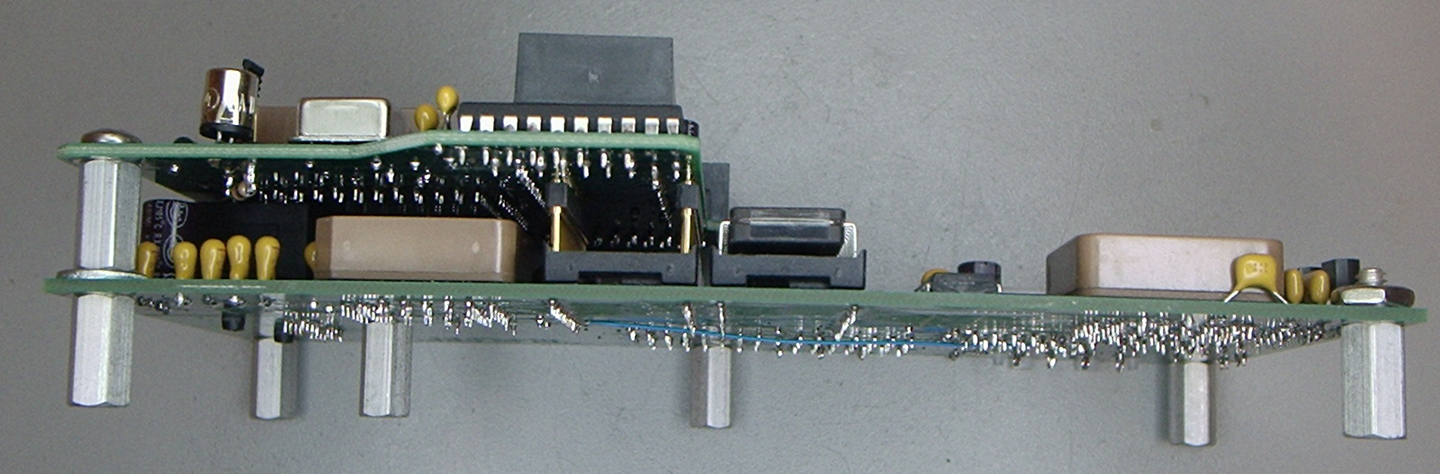

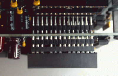

The V1.1 HBA is electrically compatible with POC V1.2 and V1.3, but none of the mounting holes align with their equivalents on those two units. The mounting differences were not a design goof. I decided starting with POC V1.2 that a different layout was best. Among other things, the new layout would use four screws to secure the HBA to the rest of the unit, thus eliminating a tendency for the HBA to occasionally unseat from the mainboard expansion socket. Also, during the layout work on V1.2, I had found it expedient to relocate the expansion socket to accommodate the two DUARTs that would give me four TIA-232 channels.
The plan was to build a mechanically-compatible HBA as soon as V1.2 was up-and-running. What derailed this plan was a change in status of the Mill-Max 351-10-114-type extender pin assemblies used to connect the HBA to the expansion socket. See below.
File comment: HBA-to-Expansion Socket Interface

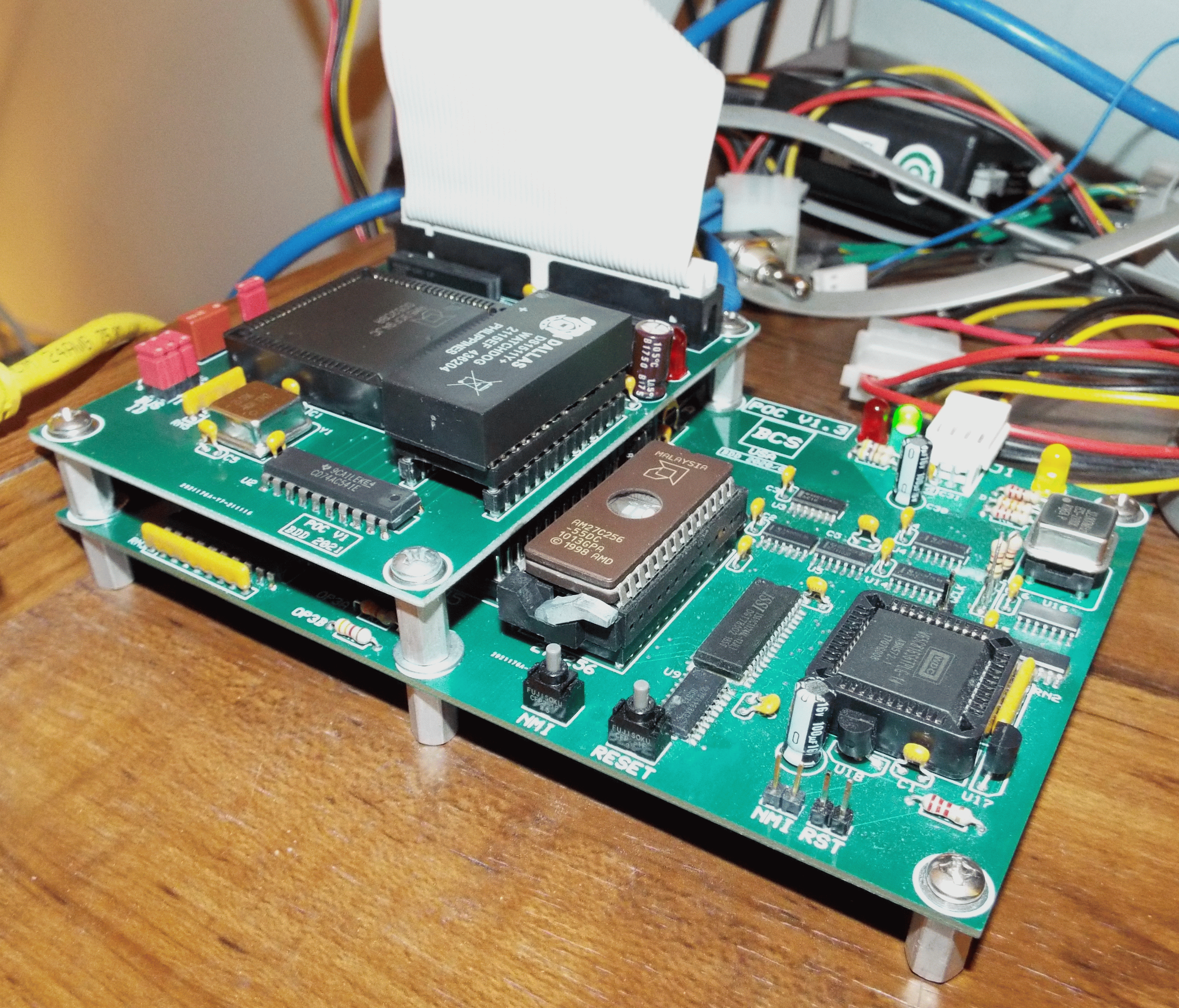

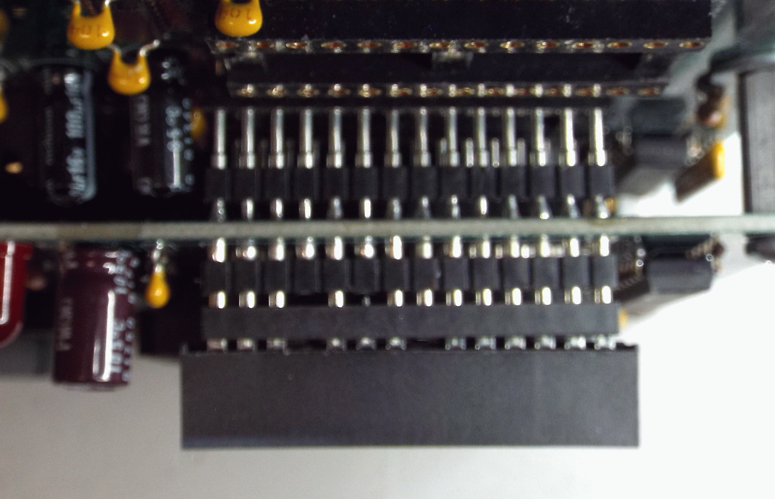

These assemblies were production items at the time I designed V1.2 but went to "special order" status right after I had completed V1.2 and had it operational. I had finished the new HBA layout and immediately before I placed an order for PCBs was when I discovered I could no longer order the extender pin assemblies from distribution. A query to Mill-Max confirmed that the part was now special-order and could be had in a 50-piece minimum order—which amounted to over 700 USD. So much for that idea! :( At least I discovered this before I had placed a PCB order. :shock:
I also did a search for compatible alternatives, but ran into the same problem: non-stock parts with a minimum order requirement. Evidently, everyone decided at the same time that no one needed these parts anymore. :evil: Almost makes me wish I had stocked up on them when they were readily available. :D
Meanwhile, I had commenced work on the design of POC V2.0, which was planned to use the same mechanical layout as V1.3, including the DIP28 expansion socket. That the extender pin assemblies had effectively become “unobtanium” prompted me to come up with a different expansion connector arrangement for V2.0. That, however, wasn't going to be helpful with V1.2 or V1.3. So what to do? :?:
The “solution” was to monkey-rig the V1.1 HBA onto V1.3 with some long, skinny cable ties cinched so the extender pins would stay seated in the expansion socket. The only bad thing about this arrangement is the ties pass over the socket into which the real-time clock (RTC) plugs in (originally, the expansion socket was the RTC socket). Okay, I can live without the RTC; nothing in the firmware is dependent on its presence. It's an ugly arrangement but it mostly keeps the HBA in place, as long as I'm careful with handling the unit.

A scratch-written SCSI driver is now part of V1.3's firmware, and I have video of POC V1.3 coming up from a cold start, bringing the disks online and trying to boot from one of them. The driver only supports block devices at this time, meaning disks and CD/DVD drives. The old driver could work with stream devices, such as tape drives, but that was a capability I hadn't used. So I left it out in the interest of expediency.
As an aside, I decided to design and build a host bus adapter (HBA) specifically to be mechanically compatible with POC V1.3 (and V1.2, although I'm not contemplating doing anything with that unit in the near future). The reason is my makeshift setup with V1.1's HBA is not very satisfactory. It's too easy to accidentally unseat the HBA and crash the computer. The new version will be physically secured to the mainboard. Although I can't get the Mill-Max extender pins I used with V1.1's HBA, I did come up with an alternative involving some strip headers. It's a little Mickey Mouse but should work.

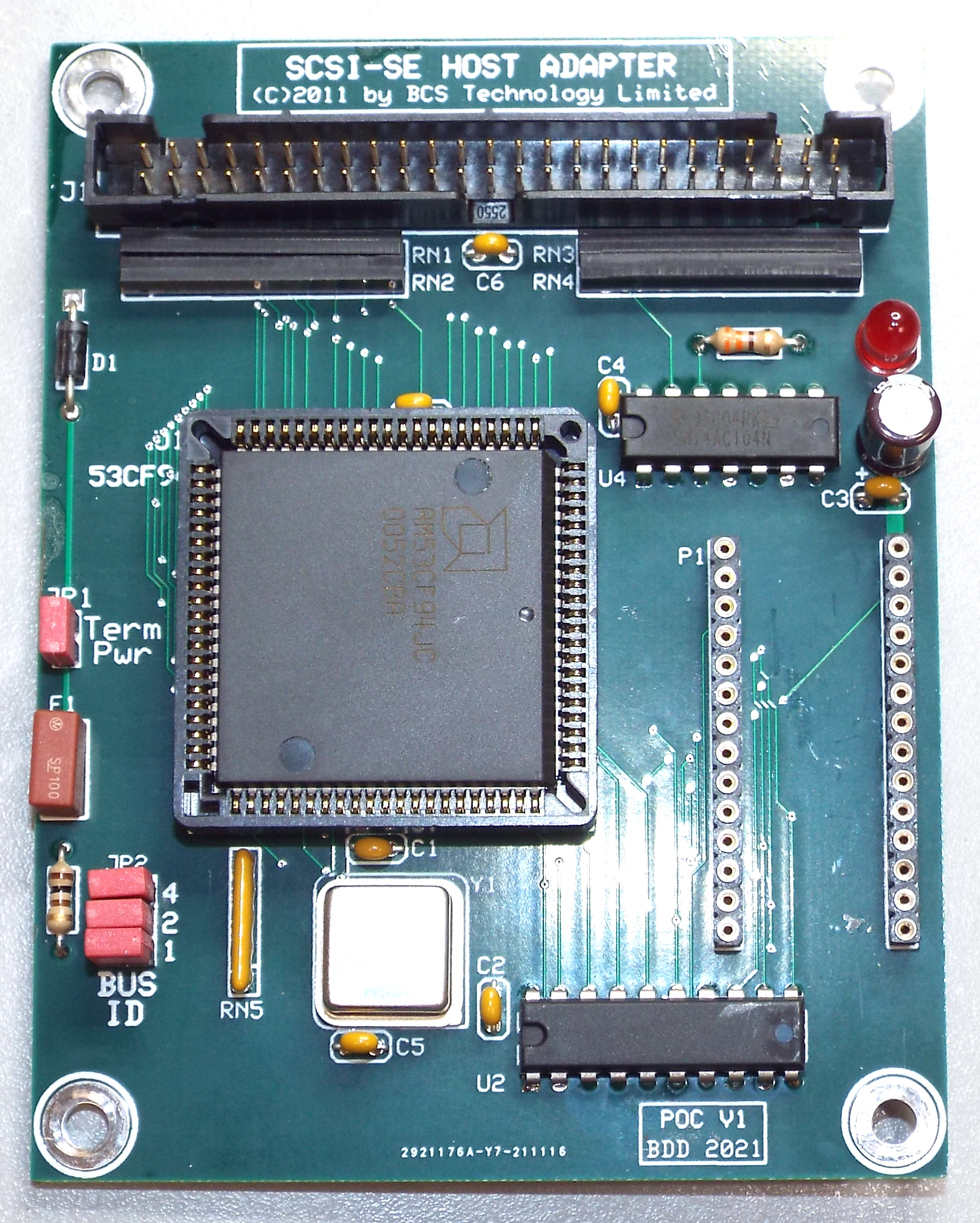

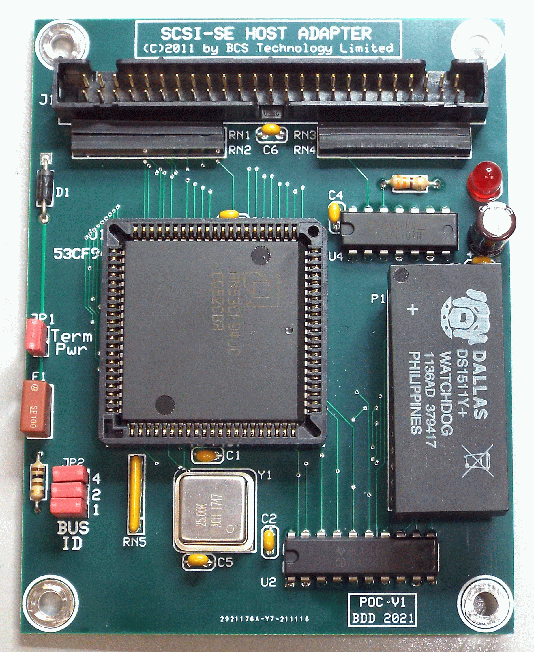

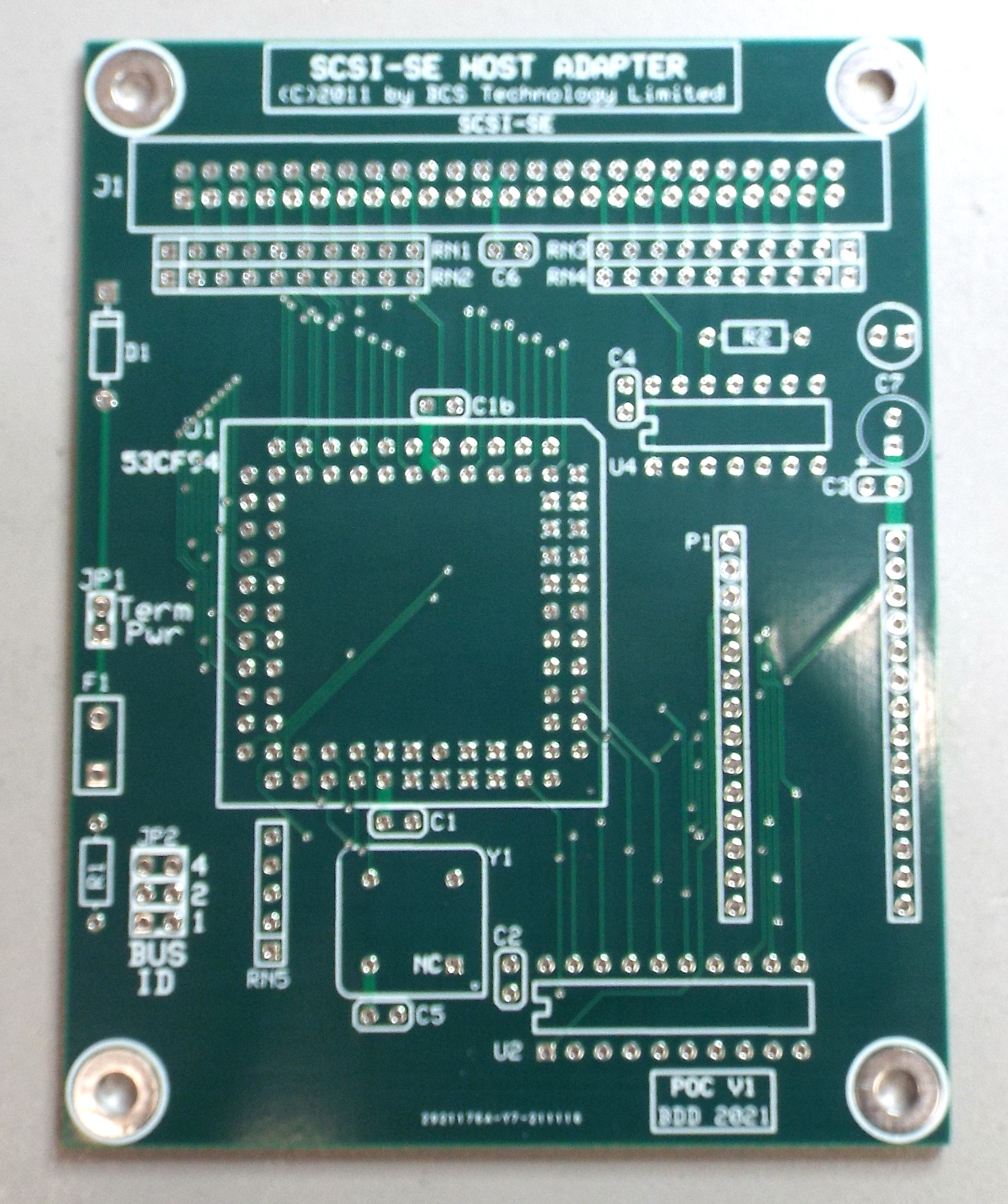

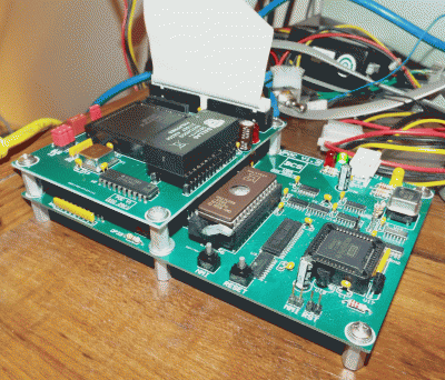

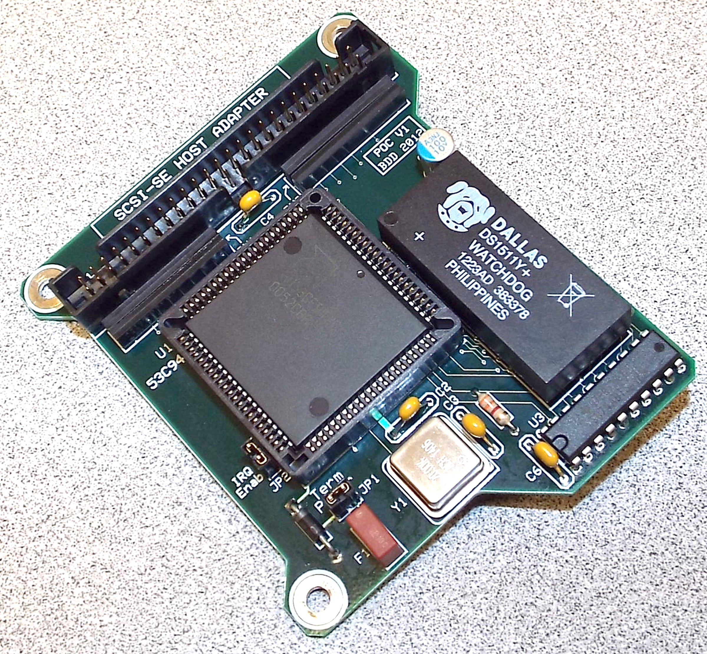

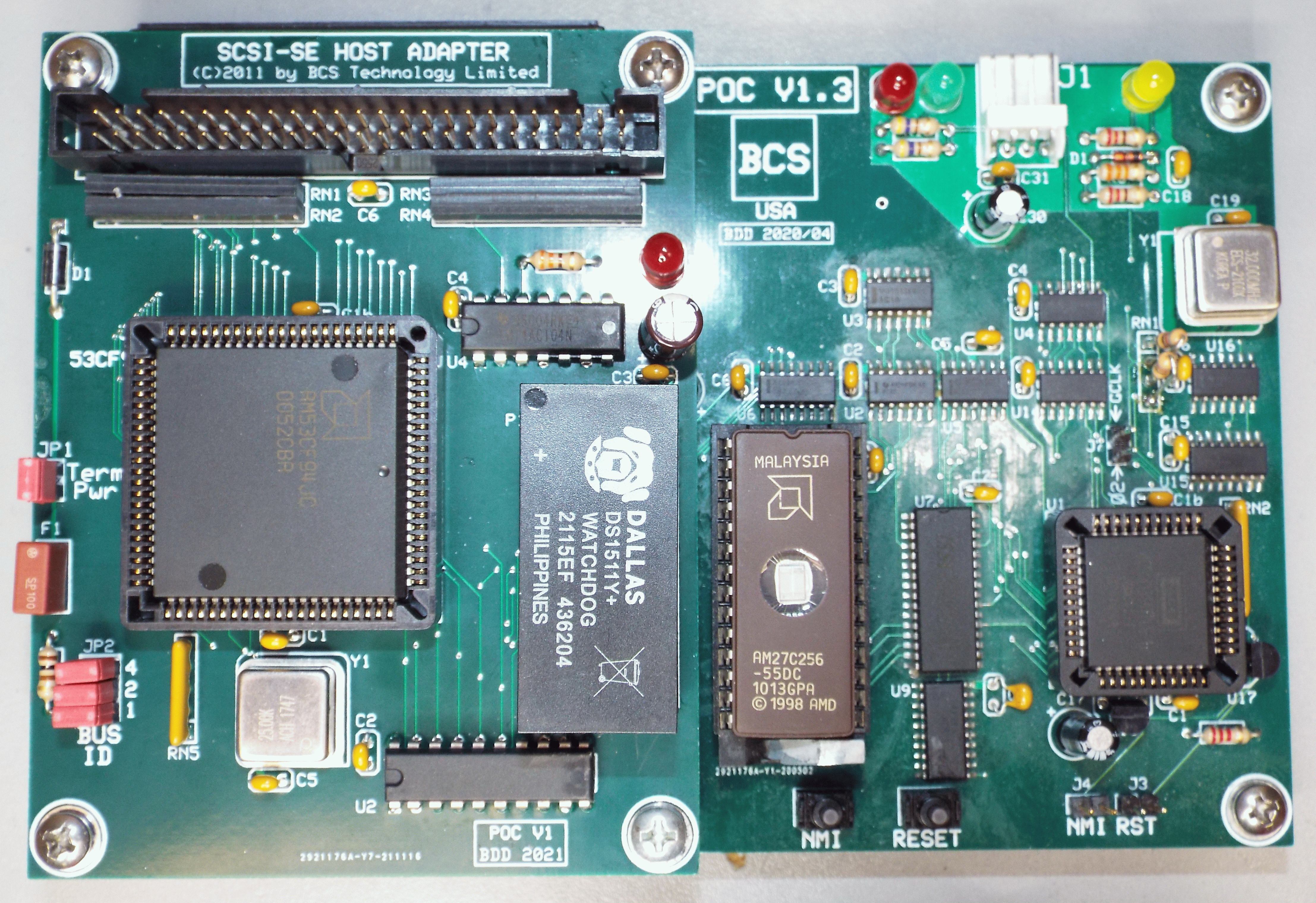

As an aside, I decided to design and build a host bus adapter (HBA) specifically to be mechanically compatible with POC V1.3...
The new SCSI host adapter has been built and tested. Everything appears to be copacetic.
File comment: Host Adapter Bare PCB
File comment: Host Adapter Assembled w/No RTC Socket
File comment: Host Adapter Modified RTC Socket
File comment: Host Adapter System Bus Interface
File comment: Fully-Assembled Host Adapter
File comment: Host Adapter Mounted on POC V1.3
File comment: Host Adapter Undergoing Testing

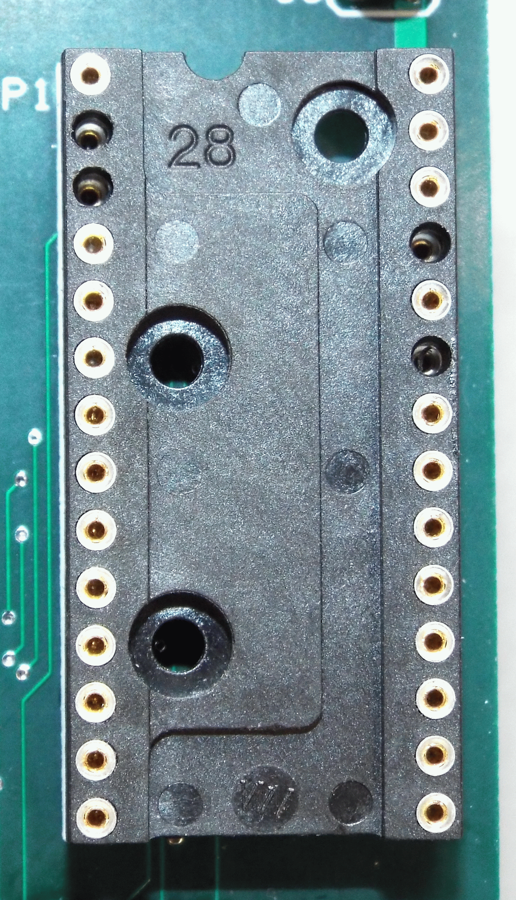

About the RTC socket. Some pins on the RTC are no-connects, but it wasn't practical to place the socket elsewhere on the host adapter so the no-connects would be isolated from the bus interface. So the solution was to extract some pins out of a socket that was then plugged into the bus interface headers. As I said in my previous post, the bus interface is a bit Mickey Mouse.

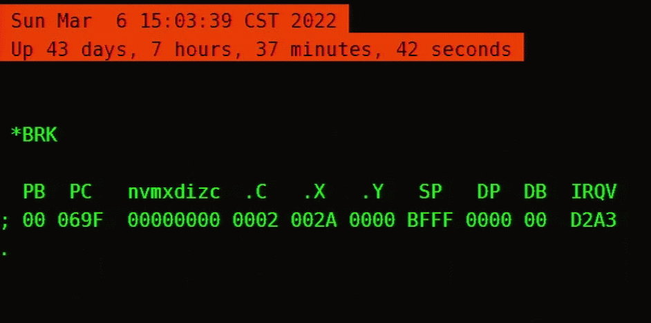

POC V1.3 has been running in an exemplary fashion as I create the bits and pieces for my 816NIX (version 2) filesystem. The V2 SCSI host adapter is doing fine as well. My only immediate wish is that I had a DMA controller to speed up SCSI transactions. Right now, V1.3 has an Autobahn on which to travel (SCSI bus, good for 10 MB/second), but is driving a 1950s-era Volkswagen Beetle. :D
