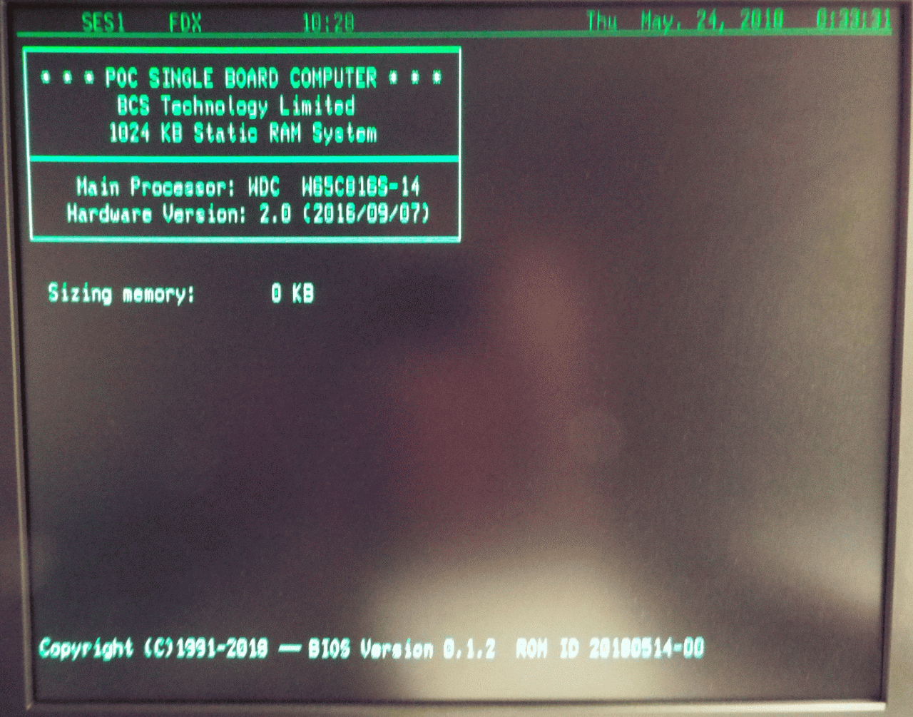

PostPosted: Thu May 24, 2018 6:38 am
Posts: 8505
GaBuZoMeu wrote:
At the moment I believe it is not a hardware problem (just a feeling, may be wrong).
I echo GaBuZoMeu's comment about it not being hardware problem. (And the part about maybe being wrong, too! :P )
I'll come back to this below.
Are there multiple interrupt sources active when these crashes occur?
In the minimalist firmware I'm running right now, there are three active interrupts: channel A transmitter empty, channel A receiver full and timer A underflow, all coming from the QUART. All other QUART interrupts are disabled, and there is no other hardware in the system that can generate an IRQ.
At power-on, the firmware does a memory test of the critical RAM areas (direct page and stack), configures the UART, sets up the driver tables, starts the UART timer to produce a 100 Hz jiffy IRQ and then outputs some text to serial channel A. I've got a dumb terminal connected to channel A, so I get a display on the screen.
File comment: POC V2.0 Serial I/O Test Display (ROM ID 20180514-00)
With those steps completed, the firmware just spins in a tight loop (HERE: BRA HERE) and does nothing else. I can see if the jiffy IRQ is running by observing /IRQ with one of my logic probes. The circuit appears to be high, but the pulse indicator flashes, indicating activity. This is the same behavior I see if I probe /IRQ on POC V1.1 when it's sitting idle awaiting input.
I also have another logic probe hooked up to monitor RDY. RDY spends most of its time low, since the spin loop is executing in ROM and each ROM access incurs a wait-state. That is evident with the pulse indicator flashing on the probe.
As I write this, the unit shows activity—it's been running for about 30 minutes, following updating of the CPLD code. If and when it goes kaput, /IRQ will go low and the probe's pulse indicator will cease flashing.. At the same time, RDY will go high and the pulse indicator on that probe will also cease flashing. A check of RWB and a couple of other signals generated by the MPU will indicate complete fatality. Just to eliminate the MPU as a possible suspect, I've swapped the '816 with the one in POC V1.1, with no effect.
I was gonna suggest taking one source at a time and, as a test, drastically increasing or decreasing its frequency to see if the crashes also increase/decrease.
I can disable the receiver and transmitter interrupts and just let the timer IRQ continue, but at a much higher rate (up to about 921,000 IRQs per second). If it's an interrupt issue that should provoke it pretty quickly, one would think.

The reset circuit is solid—I observed it on the scope for both initial power-on and manual reset. The reset circuitry is identical to that used in POC V1.1, with which I have never had any trouble.
It's pretty puzzling at this point.

Agreed. And thanks for the extra info. It's helpful to know what the system is actually doing. I'm gonna unpack that, just to list the details and maybe (hopefully!) tickle an insight. Before a failure the system will...
  • fetch and execute a BRA (repeats zillions of times, until... )
  • IRQ goes low and firmware decides which interrupt(s) it thinks need service
  • the corresponding service routine(s) are executed
  • an RTI occurs, which ought to take us back to the BRA loop (unless the stack's corrupted)
Only one link in the chain needs to break. Might there be, or appear to be, a spurious interrupt (ie, not the timer/jiffy) from the UART? If the code that determines the interrupt source had a bug, what would happen if an inappropriate routine were called? Are there calls to RAM for any of that stuff?
The reason I ask about RAM is because that's where PC apparently points after a failure (as shown by RDY going and staying high).
Just a reminder: WAI and STP are the only instructions that can cause your CPU to actually cease the fetching and executing of instructions. Otherwise it is surely fetching and executing something, whether it's data, a loop it can't escape, or code that's entirely irrelevant. The distinction between these different "fatalities" is meaningful.
That's why I'm curious where PC points after a failure. You may find PC points to (actually just past) a WAI or a STP instruction. Or, possibly something else. I admit this is fishing for clues. The results could be helpful or not.

Yes. My main focus was on pointing out that a crashed CPU usually keeps executing something. It's true I didn't thoroughly discuss the two exceptions, STP and WAI. (It occurred to me to wonder about BDD's CPLD logic, which sometimes actively pulls RDY high. But if a bug in that department resulted in a tug-of-war on RDY then I think there'd be some noticeably hot chips, or a loss of +5.)
@GaBuZoMeu, great suggestion about using NMI and stashing the saved info in RAM to be viewed after a reset! BTW and FWIW, the ABORTB input could be used instead (if for some reason NMI isn't convenient).

The oscilloscope says there are no spurious IRQs. After the POST screen has been displayed and the firmware goes into the spin loop, the only activity I see on /IRQ is a series of very short duration negative pulses spaced exactly 10ms apart. As the jiffy IRQ rate is 100 Hz, that pulse spacing is correct.
The entire IRQ handler (ISR) is in ROM but of course, accesses both direct page and stack space. There is no code in RAM, however.
At present, the ISR only knows about the three programmed QUART interrupts: channel A receiver full, channel A transmitter empty, and timer A underflow. Were the QUART to generate a spurious interrupt, the MPU would repeatedly execute the ISR in a futile effort to find and service the IRQ. That condition would result in /IRQ being continuously low, with no pulse activity, and RDY mostly low, but with pulse activity. Since IRQs are not unmasked until SR is pulled by the RTI instruction, repeated attempts to service a spurious IRQ will not underflow the stack.
Both direct page and the stack are located in a block of RAM that extends from $00D800 to $00DEFF, with the stack pointer initialized to $DEFF during the early stages of POST. The memory map for that range is as follows:

The CPLD is the biggest power-consumer in the unit and is slightly warm to the touch after a period of time. All the other major chips are barely warm to the touch. While that isn't a scientific test to determine if something is using too much juice, it's reasonable. Power at the input jack on the unit is 5.02 volts, which is what I have been seeing all along.
Now, here's where it gets curiouser and curiouser. I powered up the unit at 0638 ZULU time last night (May 24), right after I had reprogrammed the CPLD with my tidied-up code. As I write this, it is 0611 ZULU time on May 25, the unit has been continuously running since that startup the previous night and is still alive. The probe on /IRQ shows normal activity, as does the probe on RDY. In other words, everything appears to be copacetic right now. I'm wondering if reprogramming the CPLD accidentally fixed the damned thing. :shock: :shock:
