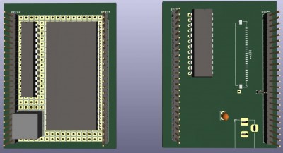

you can get the Q71 in 48 pins or less, its very compact, however it is more the physical size and the cross connections for the busses, this gets very complex very quickly and again, introduces a secondary architecture to the system. Physical Size and Intentional Design constraints limit the build in many ways. A PCB with pre-soldered components and sockets would support what is likely an order of magnitude more components and chips to the device overall. I am also looking at the 65134 just for kicks, it might work...
so normally I think Id put these going the other way, this shows the layout more clearly than the plain side:

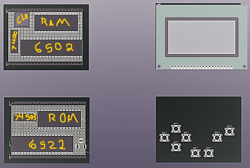

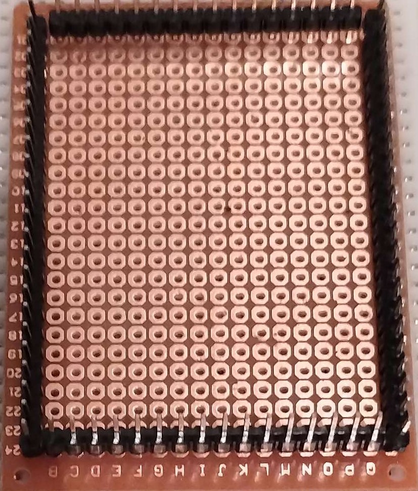

Here are several photos of possible options.
File comment: there are a couple of ways to get the pins on the perfboard, these line up to breadboard okay
the long or vertical orientation gives more than enough for 16 address, 8 data, CS and other bits, its 48 pins total, and will support a 40 pin DIP long ways

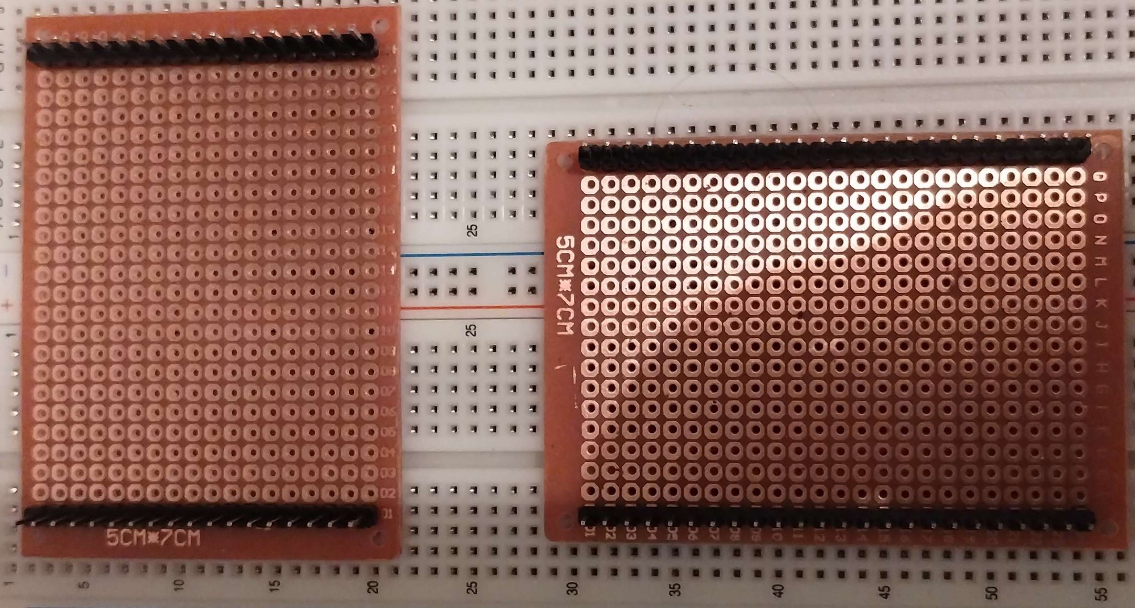

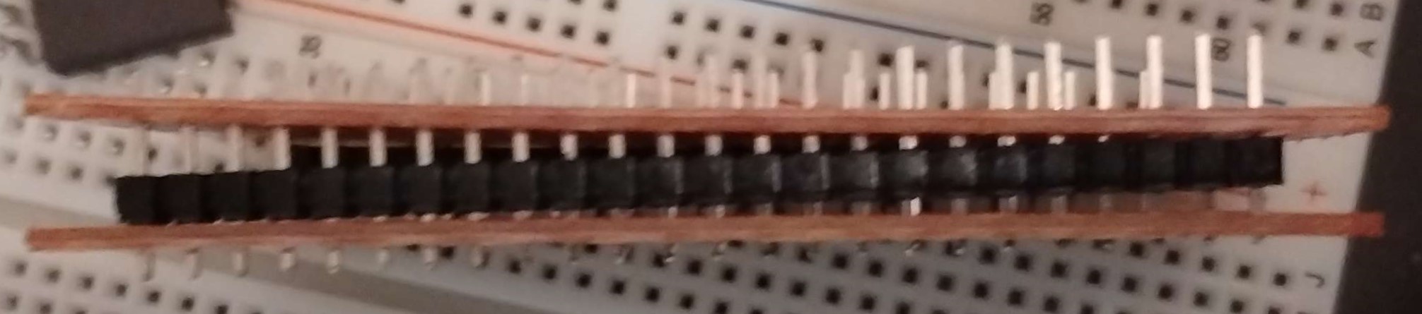

File comment: its kinda funny, the basic pin header rows i got break so two of them make a full circle around these 5x7cm perfboards
File comment: so the fat DIP isnt quite 40pins like the 6502, either way, these boards can run two rows of up to 24, and there is a little room for support chips, Im thinking 6502+RAM on one, and "everything else" on the other, with the two rows of pins basically the address and data 'sides' of the system, though it will map to the physical IC

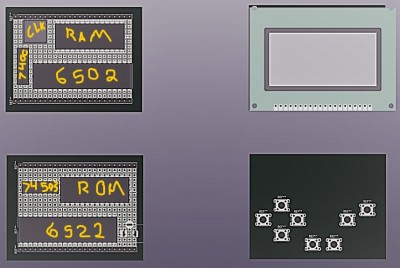

File comment: I am going to put 'connections' on the inside of the two boards and components on the outside, there will be a paper card in between them or other insulator, this creates a two layer board (actually like 4 layers almost) out of two perfboards and pin headers, which make a basic buss system for an altoids can PC
File comment: so here on the left side you have a 6502 and a clock can a 28 pin dip (might be too thin?) for the RAM.
On the right side you have the outline for the display thin film connector socket (not sure on this yet, it varies, about that big)
you have a 28 pin ROM, a power connector, and room for a noise diode and maybe a buzzer or audio out, probably a 16 pin dip audio IC if careful, I'll see

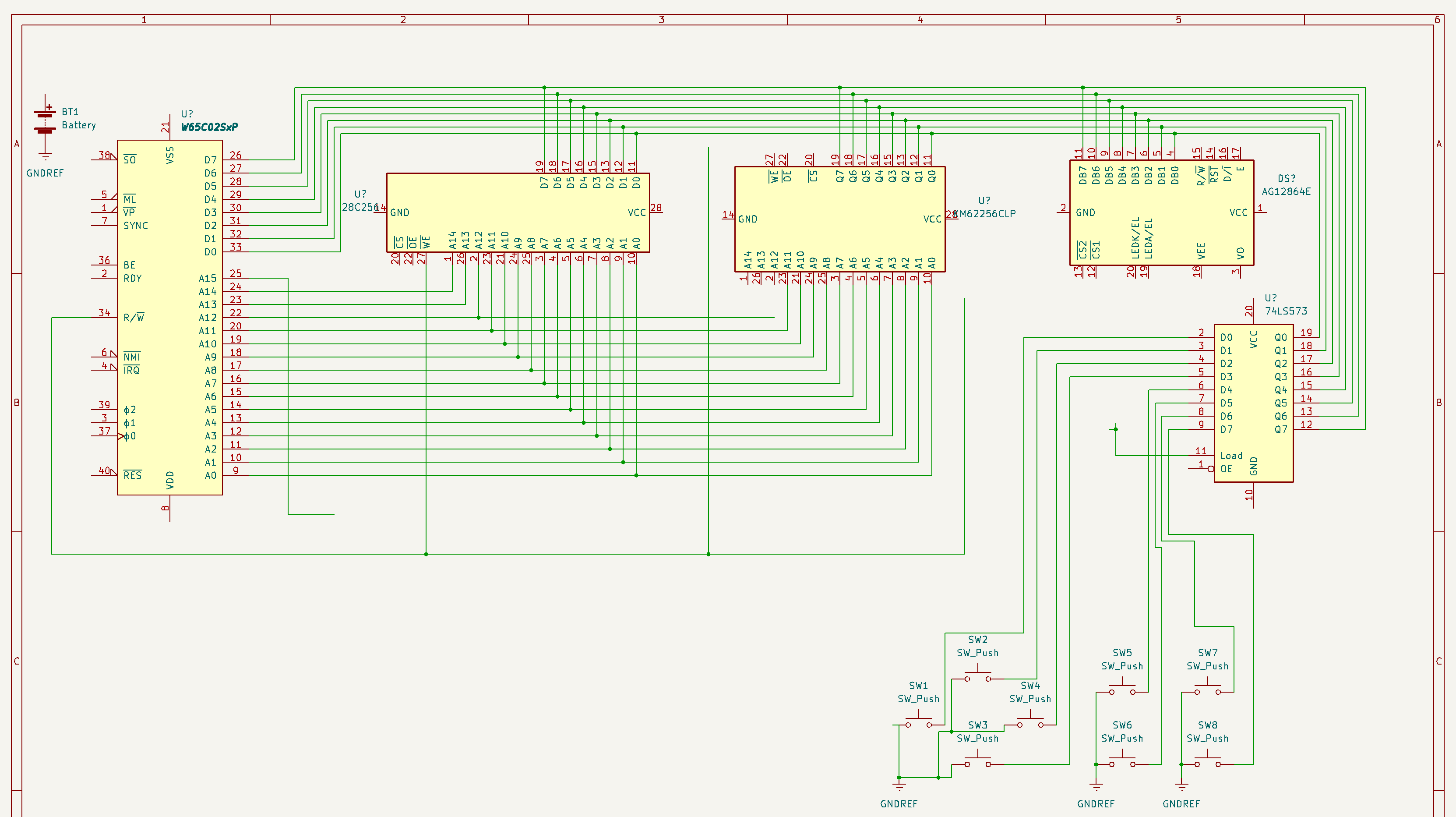

so there is still a lot missing and I want to go over several designs again, this is however as good a start as any and I am fairly certain this problem I face now is one to solve early.
in this schematic you have right to left:
6502 = RAM = ROM = Generic Display Controller.
I do not have adequate buss control, or clock signals yet I am sure. I am not 100% on ram, rom, or other devices yet, each thing in its own time...
In the bottom right, is 8 buttons, that map to a 'controller' on the front. how do I make that an address in RAM?
I think I need a tri-state buffer/driver, one that is a latch?
a 74xx573 or do I want a 74xx259?
what I am after is when a button is pressed, it latches to an input. polled by the CPU every so often and clears the buffer. this should be the easiest, can be tied to the main loop and screen updates easily and needs the least debounce hardware. I do not want to generate an interrupt and debounce 8 switches, I want to poll the controller like 30 times a second or so. maybe 16 or20.
so, if I have an 8-bit latch tied to a set of 8 buttons, how do i make that byte... $FFF1-FFF2 or whatever that is available to the CPU to read?

ok now i need to ask what is happening with the address bus on your ROM in that schematic. specifically A0 on the ROM is connected to the CPU's A15. and the CPU's A0 is not connected at all.
i assume that's a small mistake, because that would causes the CPU to access the ROM out of order.
for example if the CPU reads from Address $FF00, then $FF01, then $FF02, it would map to address $7F01 twice, and then to $7F03.
so yea, you'd want the ROM's Address lines to directly match the CPU's. A0->A0, A1->A1, etc. same with the data lines.
On a side note, with RAM it doesn't matter how you order the address or data lines when connecting to the CPU, it will still work perfectly fine. so for those you can map the lines however it fits best with your routing.
This is roughly the way keyboard scanning works on many '70s and '80s 8-bit microcomputers, such as the Commodore 64. Note that for good keyboard response you generally need to be doing this fairly frequently, which is usually done with a timer interrupt (60 Hz or 50 Hz on most systems including the C64), but if your main loop is such that you are scanning it nearly that often anyway, that should be fine.
It will probably easier not to have the buttons latch when they are pressed but instead just let their state be their state, whatever it is when you scan them. (That also saves you the trouble of releasing the latch.) None of the systems I've examined do any debouncing at all, so it seems that as long as you're scanning the buttons frequently enough, but not too frequently, everything there is fine. You don't even need to deal with anything related to key rollover if you're just doing a small set of buttons that are individually pressed at relatively long intervals compared to typing. (Some of the 8-bit systems, such as the 6800-based Hitachi Basic Master series, do not support key rollover anyway, essentially not scanning for any new keys until all old keys are lifted IIRC, which is annoying to fast typists like me but still usable I suppose.)
If you want to study some hardware and code that uses this technique, I've done a fair amount of reverse-engineering on the Commodore 16 Keyboard Hardware/Firmware, which uses a 6529 Single Port Interface (essentially, a stripped-down, one port version of a 6520 PIA) to set which row to scan and a latch in the TED chip to read the columns from that row. Your system would be simpler, of course, needing just the latch. Their firmware code is relatively long and complex as it does mapping of key codes to PETSCII, maintains a buffer of recently typed characters and so on; you might find extracting the scanning code from my slightly simpler stand-alone program ted-keymatrix.a65 easier. (That program shows the keyboard matrix on the screen and indicates when keys are being pressed, and uses a slightly different scanning algorithm.)
And there's the rub: now you're into dealing with address decoding. I mentioned this earlier, but I suspect you didn't fully understand it, or at least its implications. In your current schematic I note that the chip selects for your RAM, ROM and display are all unconnected; you need to have an address decoding system that deals with all of these, too, as well as your button interface.
I would start with Address Decoding from the Wilson Mines 6502 primer. Once you've digested that, I cannot strongly enough recommend examining and understanding the address decoding on some existing systems such as Grant's 7-chip 6502 computer, tebl's SBC, and a few others, perhaps including a commercial computer or two such as the Commodore PET. Note that you don't need to restrict yourself to 6502 systems here; Motorola 6800 and 6809 systems will be substantially similar, and 8080/Z80 systems differ only in having ROM in the low addresses and a second 256-byte address space often used for I/O devices.
I suspect the simplest system will be to reduce your ROM to 16K and have your display at $8000-$9FFF and buttons at $A000-$BFFF. (Or if you need more ROM and less RAM, reduce RAM to 16K and put your display at $4000-$5FFF and buttons at $6000-$7FFF.) Design this out to get a sense of how it works. If you want to get much more complex than that, you'll probably start to see why people like to use PLAs, CPLDs or microcontrollers emulating devices for this sort of thing.

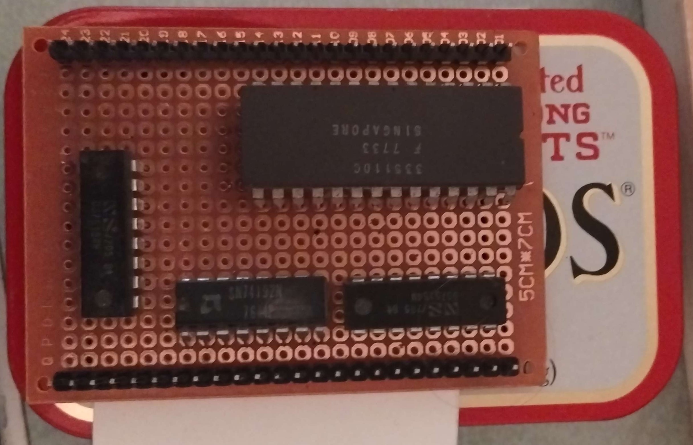

I could get a 6522, and replace the 74573 with an audio chip, usb or support circuity maybe... lotta wires though in a can... idk, Ill see if it fits. be cool if it does, would run the display with CA1/CA2 to the video chip selects I guess... so much extra wires, so easy on a PCB with PLCC sockets, lol :lol:

wayfarer wrote:
cjs wrote:
wayfarer wrote:
what I am after is when a button is pressed, it latches to an input. polled by the CPU every so often and clears the buffer. ...
This is roughly the way keyboard scanning works on many '70s and '80s 8...
gotcha, I am not putting a full keyboard on here...This is to keep it simple and minimize complexity and hardware connections.
It doesn't matter; your buttons are exactly the same thing as one row of a keyboard: it's a keyboard with a single row. If you think of a keyboard as different from your buttons (beyond the row enables) it's worth studying more closely how keyboard scanning works until you see that it's just a one-row keyboard.
So the trouble here is 'missing' an input because of operator timing...
It's not an issue so long as you're scanning reasonably often, as you've seen when you used a keyboard on a TRS-80, PET, C64, MSX or many other old computers. If you scan 60 times per second you're guaranteed to see any key that's held down for at least 16.6 ms, which is faster than a human presses and releases a key. You'll note that the NES controller, too, uses a CD4021B shift register which does not latch when a button is pressed, but latches only when the NES main unit strobes the clock signal. So there, too, in theory, if a button is not held down for long enough it will be missed.
The '573 won't do what you seem to be saying you want (latch each individual button on a button press) anyway, since it has only one latch input. To latch on a button press you need an individual flip-flip or latch for each input, set up as a bistable multivibrator that can be reset by the CPU after it's triggered. You could build something like this, but it's a bunch of extra devices, extra wiring, extra work for the code running on the CPU, and just isn't necessary as we saw above.
(And note that the software will still have to track both down and up states; if you unlatch the input it will immediately latch again if the button is still held down, so doing a "scan; see latched; unlatched; scan; see latched" sequence does not mean the button has been pushed twice.)
There is a buffer and it actually looks simple and not too bad, its in the picture below, the 74'573. It just needs two control pins, more on that below. It would just 'expose the pins' when told to, so addressing on that just needs to turn everything off and let it be on the data buss...
Right. Basically, you have the address decoding assert /OE (bring it low) when the CPU wants to read it, and deassert /OE (bring it high) when the CPU is accessing anything else. You can just wire LE/Load high so that it's always showing on its outputs (when /OE is asserted) the current state of the buttons. (Note that bringing LE low will capture the current state of all the buttons at once; but you're doing that anyway at the moment you read from it with LE high, anyway.)
But one thing you're missing there is that you need a pull-up resistor on every input line of the '573. Closing a switch properly brings its input line to ground, but with the switch open the line will be floating, and so you'll get a random value.
Or you could simply use a PIA, which has internal pull-ups in the chip so you don't need another eight external resistors. :-) (Check the data sheet for the particular one you're using, though. I just noticed in that in the Ben Eater schematic you linked, he's got external pull-up resistors on his switches even though he's using Port A of the 6522. From a look at the data sheet, it appears that, unlike the Motorola 6820, the MOS 6522 does not have internal pullups.)

Address Decoding
yes this is the part I am trying to sort out. The 6502 doesn't have any Chip Select lines.
No, of course not. The whole point of address decoding circuitry is to generate the chip select signals. The CPU has no idea what it's accessing when it puts an address on the address bus; it's up to the address decoding circuitry to look at that address (and perhaps other state) and enable the correct device. (The same address might even cause different devices to be enabled at different times; this is how bank switching works.)
It doesn't matter; your buttons are exactly the same thing as one row of a keyboard: it's a keyboard with a single row. ...
for sure, I get what you are saying I looked over a few KB and keypad 5x5 decoder circuits a few weeks ago when I was figuring out keys for the Qronos portable jobsite/trail calculator. So a bunch of my undergrad stuff was in Computer Science, then my graduate stuff was in education, life sciences, math and organizational psychology/management. then I moved into Computer Engineering as a field hop. They are very emphatic at my school about problem reduction and not overcomplicating things. Keyboard encoding and decoding is a problem for another day. You are correct, it is just beyond this specific task. These 8 buttons, one byte of input, is integral to pretty much all of my devices and will likely be done in a similar manner for a lot of them. It is specifically having 'one byte of input' that is a 4 way direction pad and the 4 primary buttons, that is basically hardwired into a well established memory address at all times. In all of these systems, there will always be a 'user input byte' that should basically always be the same.
also, just solving the 'get the correct device to put (get) its data on the data buss at the right time' is enough of a problem. for now at least, one thing at a time. as discussed further, I do agree with you about 'just exposing the raw input switches cleanly' is fine, no latch needed or anything fancy.
It's not an issue so long as you're scanning reasonably often, ... If you scan 60 times per second you're guaranteed to see any key that's held down for at least 16.6 ms, which is faster than a human presses and releases a key. You'll note that the NES controller, too, uses a CD4021B shift register which does not latch when a button is pressed, but latches only when the NES main unit strobes the clock signal. So there, too, in theory, if a button is not held down for long enough it will be missed.
indeed, I was aiming for 30 Hz myself, Ill see if that is fast enough in testing.
The '573 won't do what you seem to be saying you want (latch each individual button on a button press) ...
yeah I agree, latches and such might need a reset operation, the '573 is plenty here to 'gate' the input until needed. E000 is at 1110 000..... so that upper 4 bits is 1110, and if you invert that its bits A15, 14, 13 'off' and bit 12 'on', so that works for chip select to invert E as needed, and send 1 bit to the OEB on the '573... or some other logical arrangement.
yes, exactly this.
noted, I can probably put these inline fairly easily, especially if I can get larger SMD types or cut the leads really short, use some of that component to component soldering.
Or you could simply use a PIA, ....)
If you want to study some hardware and code that uses this technique, ...
On a future project yes, this is such a deep dive for this, its beyond the scope of an altoids can.
Well, to me it seems not, given the difficulty you're currently having with seeing how it's basically just what you want to do. Again, if you ignore the row selection and treat your system as a keyboard with just one row, all the rest of what you learn from the "deep dive" is exactly what you need for this.
I gotcha, like I said, Im fine with this '573 solution, its simple and will work for now and allow focusing on the real problem, buss decoding and control.

so the display modules all have 8k onboard ram, its just only available at the one address/port so its not really useful, you can read from it....
Ok, so that's not part of your system RAM at all, then. That's basically sending commands over the I/O ports to the display system to tell it to read or modify its internal RAM, which is not directly accessible to you.
Think of it like the memory of another computer that you're accessing over a network.
that is exactly how I was thinking and it leads into something with ROM as storage like a HDD...
