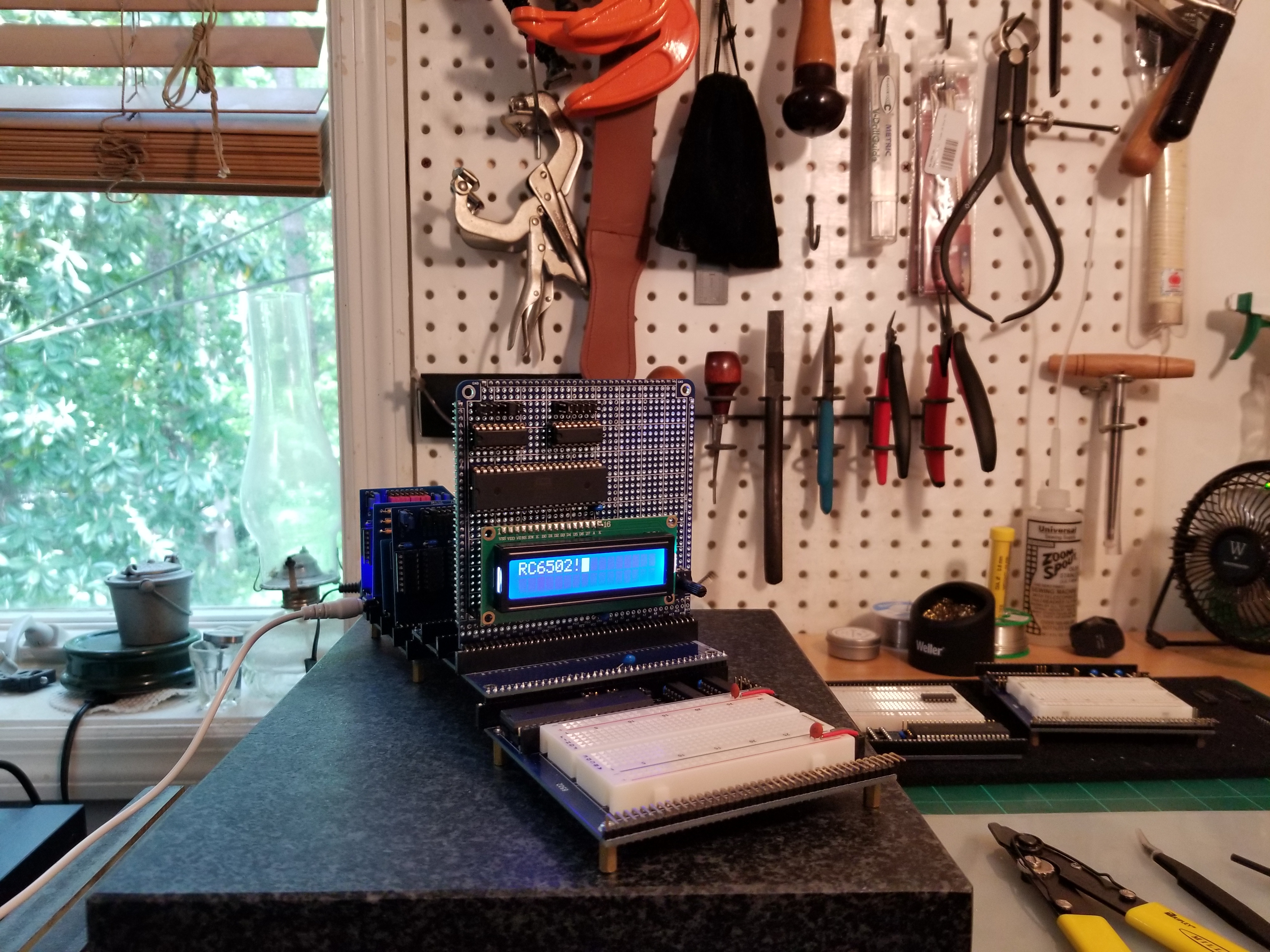

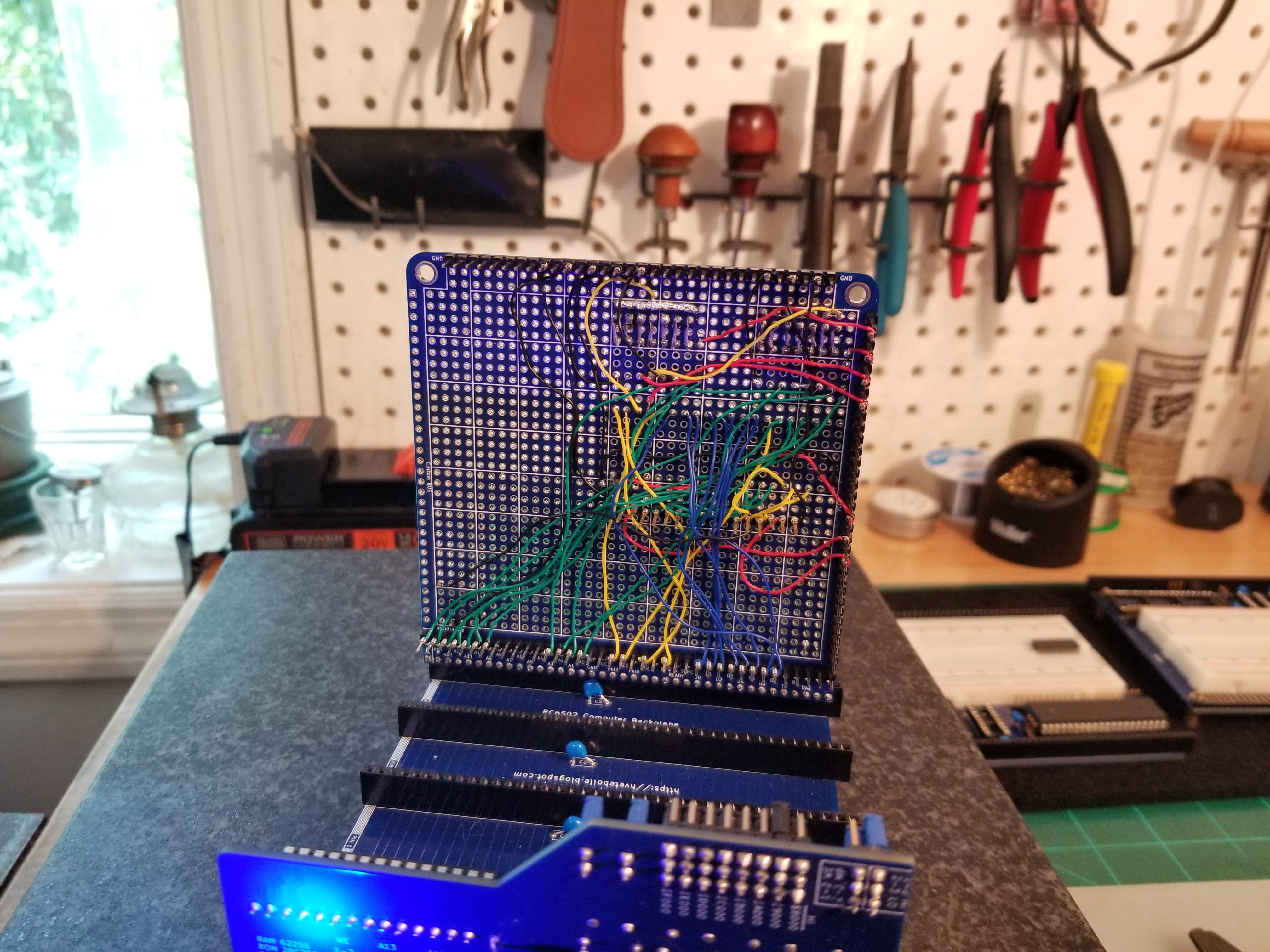

The module with the integrated breadboard in the photo upthread is called an "RC6502 Project Platform." Since my LCD is now working properly, I wanted to get it off the breadboard, giving it a more permanent home, and freeing up breadboard space for the next project (keyboard interface).
At some point (I think because PCBWAY gave me a coupon), I ordered a whole stack of RC6502 prototyping boards. These are just plated through hole perf board with the RC6502 bus along the bottom edge, a VCC rail up the left side, a GND rail across the top, and a "custom bus" down the right side. I figured this would be a good place to build an LCD board for Blue April. This did not go well. Turns out I had the wrong kind of wire, the wrong kind of solder, and the wrong kind of IC sockets. After several false starts, ruining several of the prototyping boards (no big deal, I have 10 of them!) and melting some IC sockets (no big deal, they're cheap) yesterday I plugged in the third try, and saw "OK" flash up on the LCD. I have to say, in spite of all that frustration (or maybe because of it), the sense of triumph for completing this relatively standard and straightforward project was very satisfying. :)

Looks great! That's how I started soldering too: the hard way. You learn more from mistakes, so that will pay off in the future for sure. It looks good, and functions well!
For the keyboard interface, have you watched the Ben Eater series on PS/2 keyboard interfacing? I really liked his videos, and I used them to model my own keyboard interface.
I find that soldering wires to things (IC socket pins, for example) is much trickier than soldering things onto PCBs. Wire wrap is much to be preferred; unfortunately I didn't have the right IC sockets for wire wrap, so I had to do a kind of hybrid (wire wrap on one end, solder on the other). Someone in a different thread recently posted a link to Phoenix Enterprises; they seem to have a nice selection of wire wrap sockets at affordable prices. Dunno why they didn't come up in my google searching. Anyway, I'll stock up on them for the next thing.

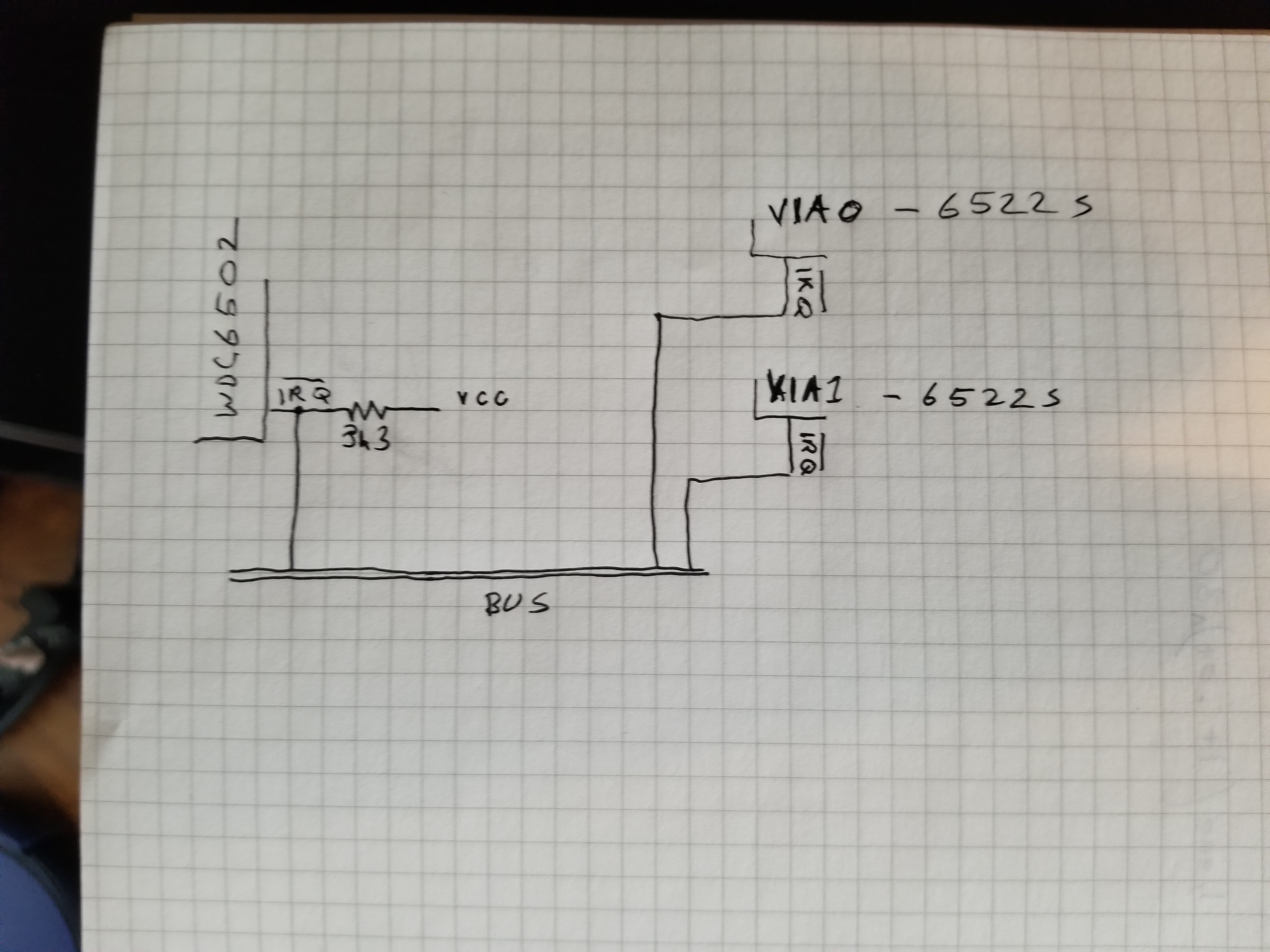

I'm getting some unexpected interrupt behavior - specifically, constantly spamming of interrupts.
Currently, I have things wired up like this:
VIA1 is on the LCD board; it isn't generating any interrupts, but I did wire up it's IRQ pin to the bus (don't know why I did that).
VIA0 is on my prototyping board; I want it to generate an interrupt when CA1 transitions. In the long run I want to use it to generate keyboard interrupts, but for now a momentary push-button will be fine. :) Before I start blaming my software, I want to make sure I understand how the hardware works.
I read in the Primer that you can't wire-or multiple 'S' version VIAs together to have multiple interrupt source, which appears to be what I've done. However, only VIA0 needs to actually generate interrupts, so, in a pinch, I can just cut the IRQ line on the LCD board if that's what's causing the problem.
However, it seems like what's described in the primer is that when two 'S' VIAs are wire-ored together, VIA0 will try to pull IRQ low, but VIA1 will keep it high, preventing the interrupt form being issued. IOW, I'd expect to see *NO* interrupts; instead I have the opposite problem - constant interrupts! This happens even if CA1 isn't hooked up to anything.
I want to double-check my understanding before I start cutting wires.
