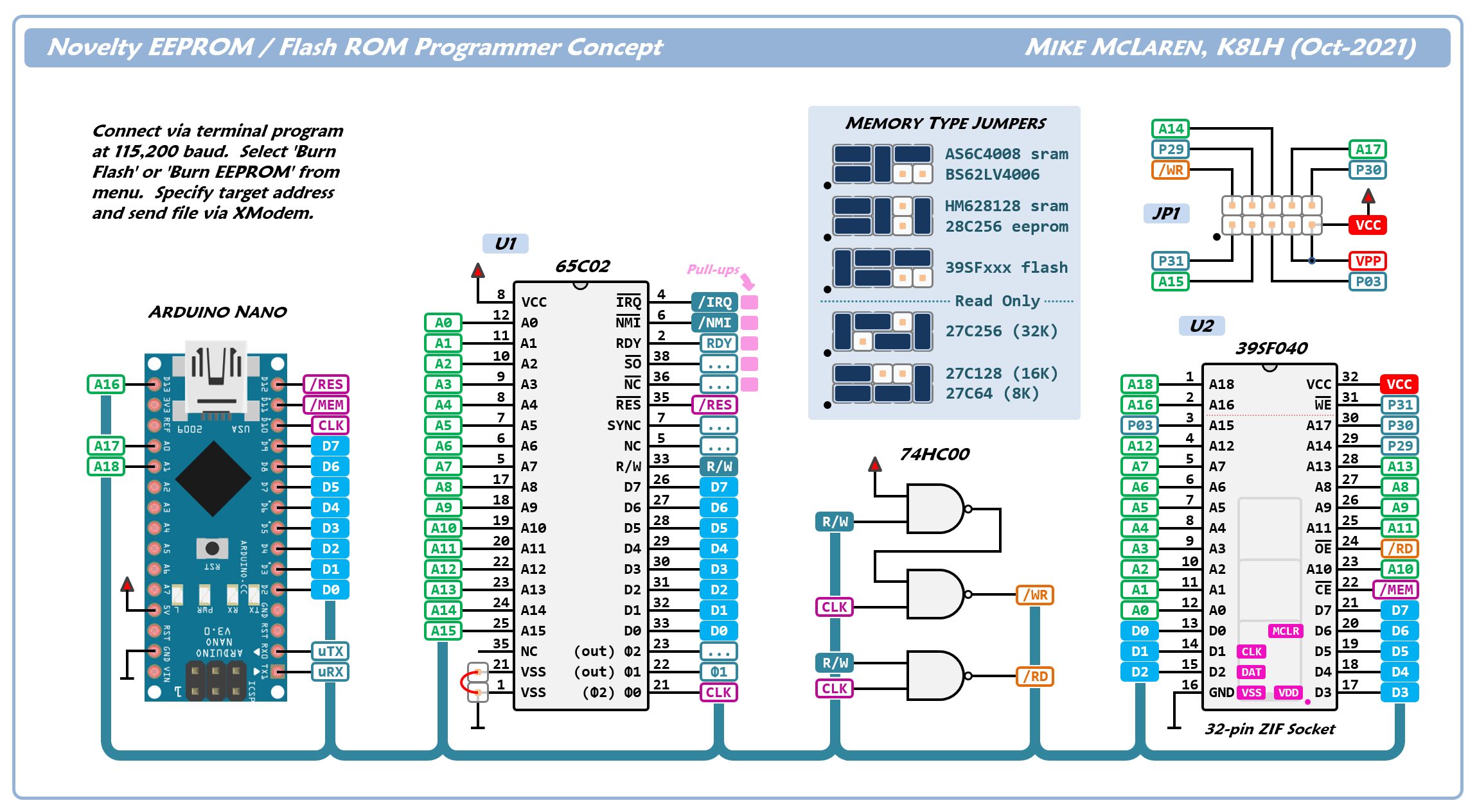

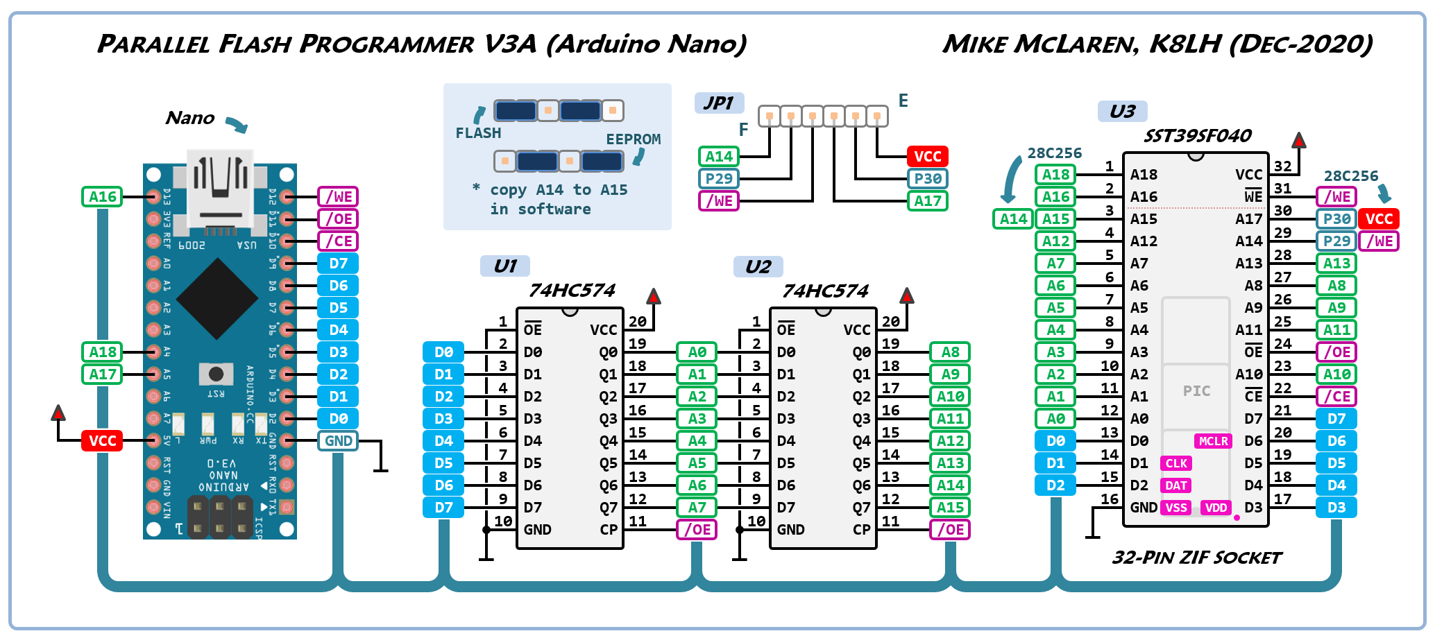

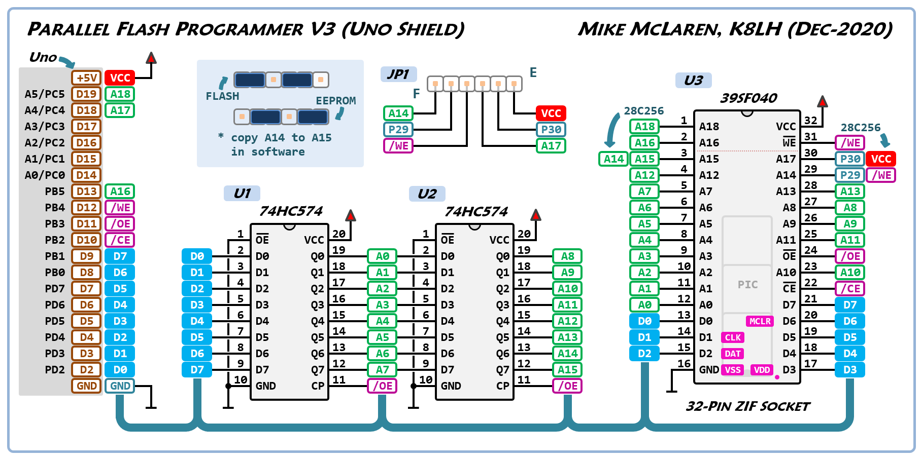

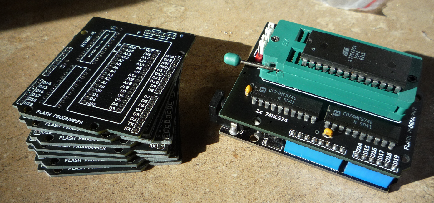

Since we're discussing tools and barriers to participate in the hobby (necessary tools, costs, ease of construction, etc.), I'd like to suggest that the Arduino Uno and the Arduino Nano clones are a worthwhile investment. I'm necessarily frugal (financially challenged?) and a commercial programmer, while not entirely out of reach, would have used up several months of my meager $20/month hobby budget. Instead I enjoyed designing and building a FLASH/EEPROM programmer shield for an Arduino Uno. I bought five Arduino Uno clones with micro-USB connector ($3.03 each, including shipping) one month, ordered ten Flash Programmer PCBs ($18.20, including shipping) the next month, and I ordered 32-pin ZIF sockets ($1.29 each) the following month. Drawing & details below... I used a pair of latches which can be loaded with 16 address bits much faster than a pair of shift registers (while also using less pins on the Arduino board).
I believe newcomers might enjoy building simple and relatively inexpensive tools like a Flash/EEPROM Programmer shield, especially with the gratification of seeing results immediately after a couple hours of assembly. A relatively simple set of instructions could guide them through installing the Arduino IDE and a 'sketch' (program) into the Arduino board as well as guiding them through the programmer shield assembly process (some 100+ solder connections). Program Flash or EEPROM chips using a terminal program with x-modem at 115200 baud.

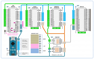

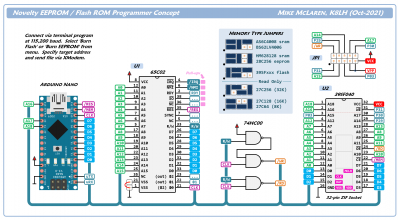

Lots of good discussions. My reason for focusing on a 6502 solution is because when a newbie comes to 6502.org to learn about what 6502 can do, an Arduino or Pi solution seems not satisfy the newcomer's interest. My guess is the newcomer does expect some challenges dealing with 40+ year old technology; a modern peripheral maybe acceptable but abandoning the core 6502 CPU for modern CPU may be disappointing.
I'm intrigued by the possibility of serial bootstrapping. The serial receive ready can tie to 6502's RDY so 6502 executes one instruction and wait on next instruction to be ready. While waiting for such serial bootstrap engine to be realized, a FT245R may fit the function quite nicely. Attached is my strawman design of bootstrapping using FT245R. The basic idea is locating FT245R at reset vector memory area and connect its receive data ready to 6502's RDY such that FT245R's 8-bit parallel port provides the opcode to 6502. This way PC sent 6502 opcode over USB for 6502 to execute. First, the binary opcode stream builds a small bootstrap program in RAM and then jumps into the bootstrap program to load bigger & better program over FT245R.
