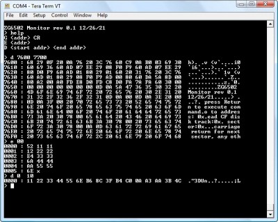

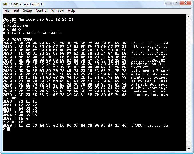

I have a simple 4-function (load/display/modify/go) monitor working on ZeroGlue6502 (ZG6502), so I sent out the design to JLCPCB. The prototype ZG6502 is documented here.

From ZG65Mon.lst:

Is there any reason for not stuffing it all into one big loop, saving 45 bytes?

??? If ZP is available right away, you can save 72 additional bytes with (ZP),Y:
    txa
    sta $80
    sta $82
    tay
    lda #$70
    sta $83
    lda #$f0
    sta $81
loop0:
    lda ($80),y
    sta ($82),y
    iny
    bne loop0
    inc $83
    inc $81
    bne loop0
    jmp *+3-$8000

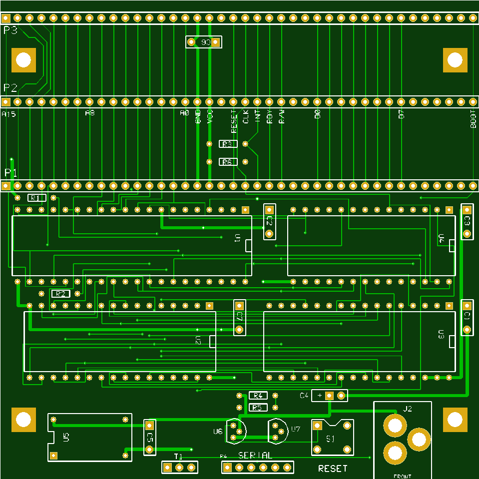

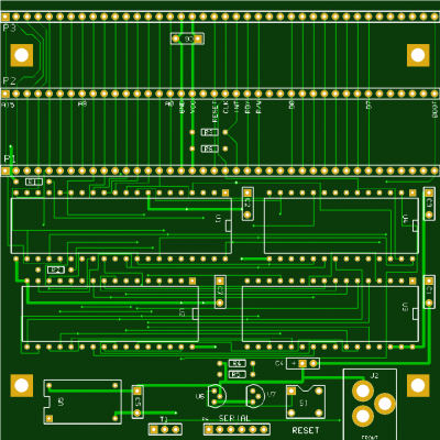

Edit: Mike, This is what the board looks like. Would you like me to mail you a blank board? PM me with your address if you like one.

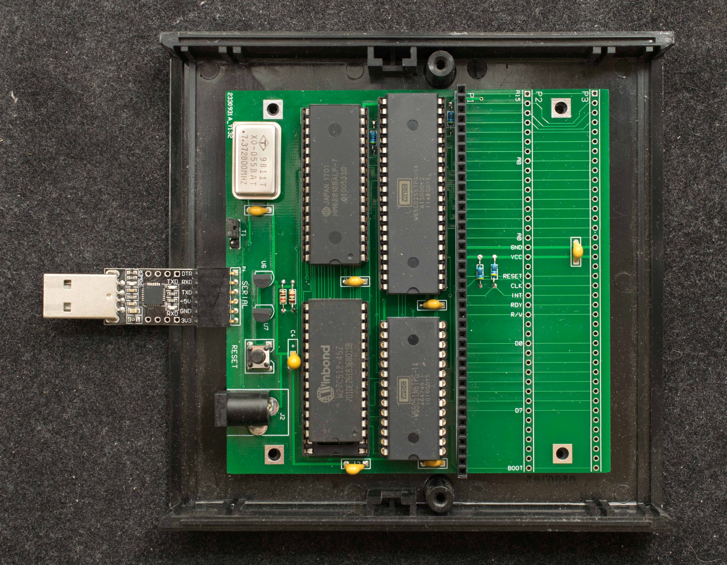

This is pc board version of the ZG6502. It is designed for PacTec's CM5-125 enclosure as shown in the picture.
I have created a ZG6502 homepage (currently under construction) and will put all design information there. The memory locations $C000-$FFFF are suitable for other I/O boards 350mS after reset. This is why I have 3 RC6502 expansion slots and added a "inhibit" signal to disable the I/O in locations $C000-$FFFF during the 350mS bootstrap.
Because of the simplicity, I think this board can potentially run up to 20+MHz with appropriately fast RAM and EPROM.
WDC's 65C02 and 65C51 are expensive, but if built with used 6502 and 6551, this can be an inexpensive (<$20) way of getting into world of 6502.

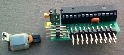

I just tentatively finished a project that does a similar thing for a ROMless '816 system.  It hijacks the motherboard's Φ2 source (also disabling RAM's output), and its reset, then as it lets the processor out of reset the first time, it watches the VP\ output and feeds the data lines an artificial reset vector, then watches the VDA and VPA lines for the first instruction fetch, and then starts feeding LDA#...STA instructions to put the bootloader code into RAM.  You can have multiple stretches of RAM, held as separate records in the I2C-6 EEPROM module plugged into the bootloader board.  [Edit, 7/28/22:  The I2C-6 EEPROM module is on the front page of my site now, and there's a link to the data sheet there.]  Each record has a record type field, a starting address, a number of bytes in the payload, a link to the next record, and the program or data itself to load into RAM.  When it has finished the last record, it puts the '816 back in reset, releases the clock source it had hijacked, puts its own data lines in hi-Z, and releases the RST\ line so the '816 can now boot up with the vectors and bootloader you just put in RAM.  It uses a PIC16 microcontroller.  I plan to make it available to others.  I just have to figure out some details of how to do that; for example, many users won't initially have any way to put the data in the serial EEPROM.

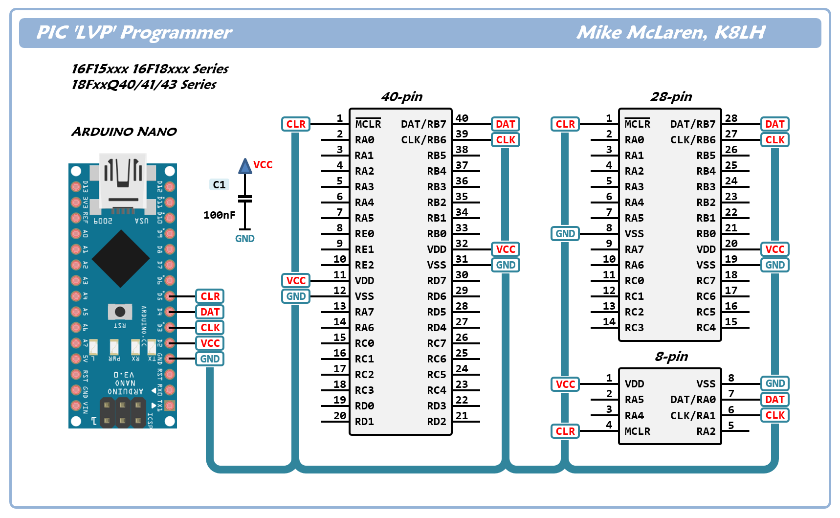

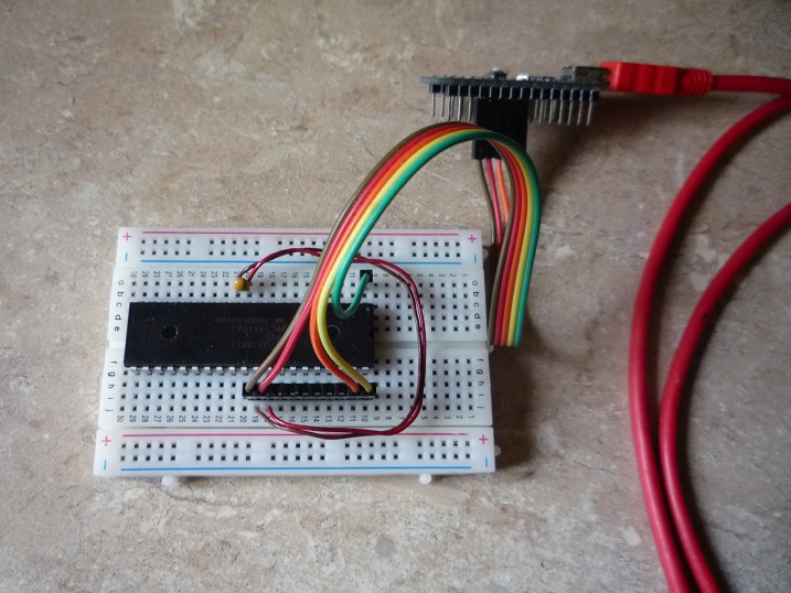

Which PIC are you using? How much EEPROM/Flash storage do you need? If it's a relatively modest amount, you might consider using a 20-pin 18F16Q40 (64K Flash) or a 28-pin 18F27Q43 (128K Flash) and ditch the external serial EEPROM.
Recently I created an Arduino 'sketch' (program) that included the firmware image for a PIC 16F18877 project as a constant ROM array as well as the LVP (Low Voltage Programming) drivers to actually program the image into the PIC. It was a relatively simple way for someone to build a version of Karen Orton's 2007 PICL/NIBL computer (an SC/MP emulator plus National Semiconductor's 4K NIBL BASIC) using a relatively inexpensive Arduino Nano clone instead of investing in an expensive PIC programmer for what might otherwise be a "one off" project. Check out the simple wiring diagram below. Anyway, you might consider something similar to 'burn' the 8-pin serial EEPROM.
Cheers...
