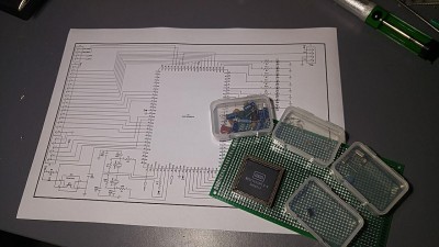

Hi. I can now start building a Mensch Microcomputer clone, so I can test myself if I can be able to get this to something done.

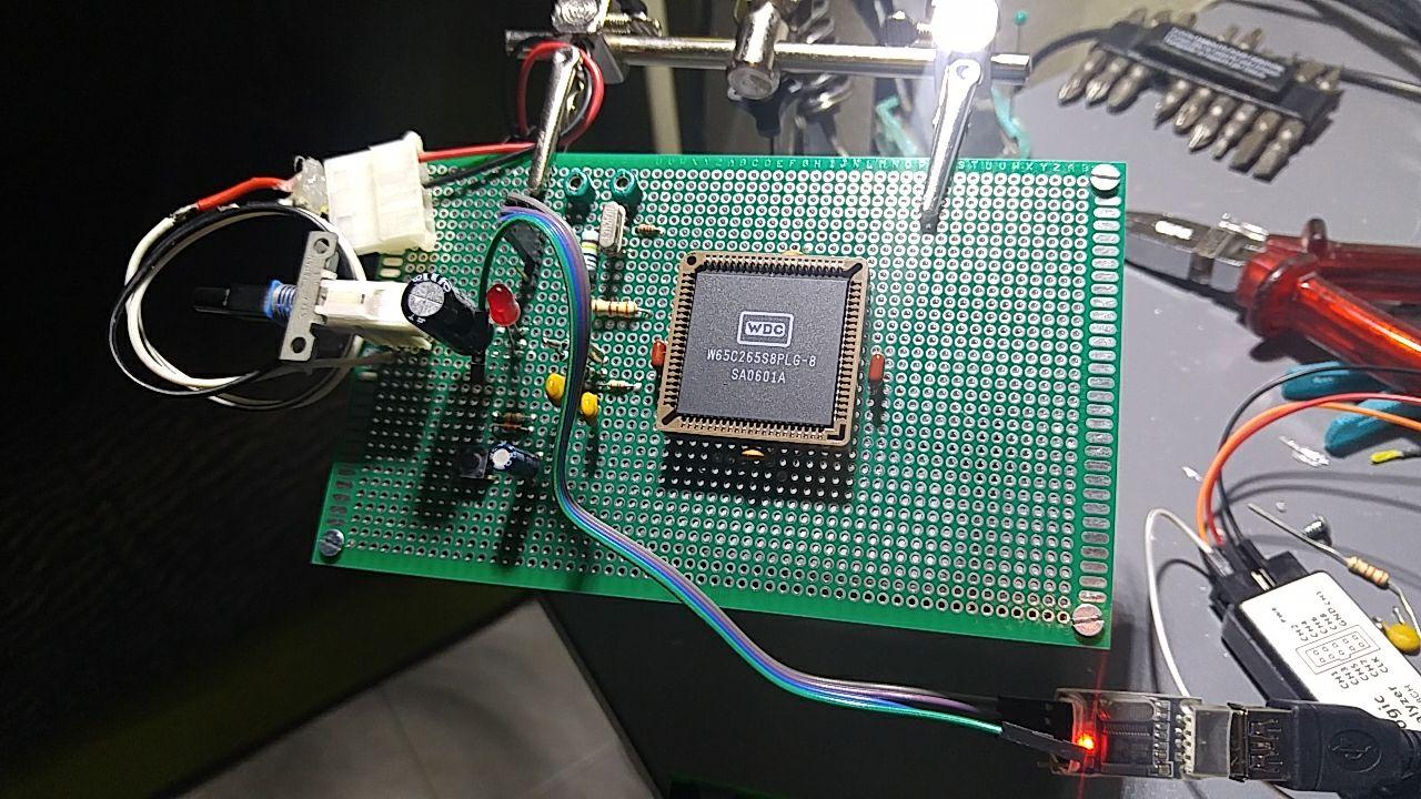

After a week of hiatus, I've been able to finish soldering the thing.
The w65c265s does use two clocks to boot: a slow 32768hz clock (CLK) and a fast (FLCK) clock, whose speed you can choose up to more or less 8 Mhz.
What's happening right now is that I put a 4,9152 Mhz crystal (as recommended in the data sheet, to be able to generate ceratin baud rates in the serial ports), but I can't get the chip to use it, so it keeps running at 32768hz (0.032768 MHz). It takes about 30 seconds just to output the welcome message trough the seial port.
I put the logic analyzer there and it detects that frequency even in the FCLK circuit... I have to figure now if the capacitors are the right value.

Well... after debugging and debugging... I have now my Mensch computer clone running at 4.9512Mhz.
Its a MESS but it does boot.

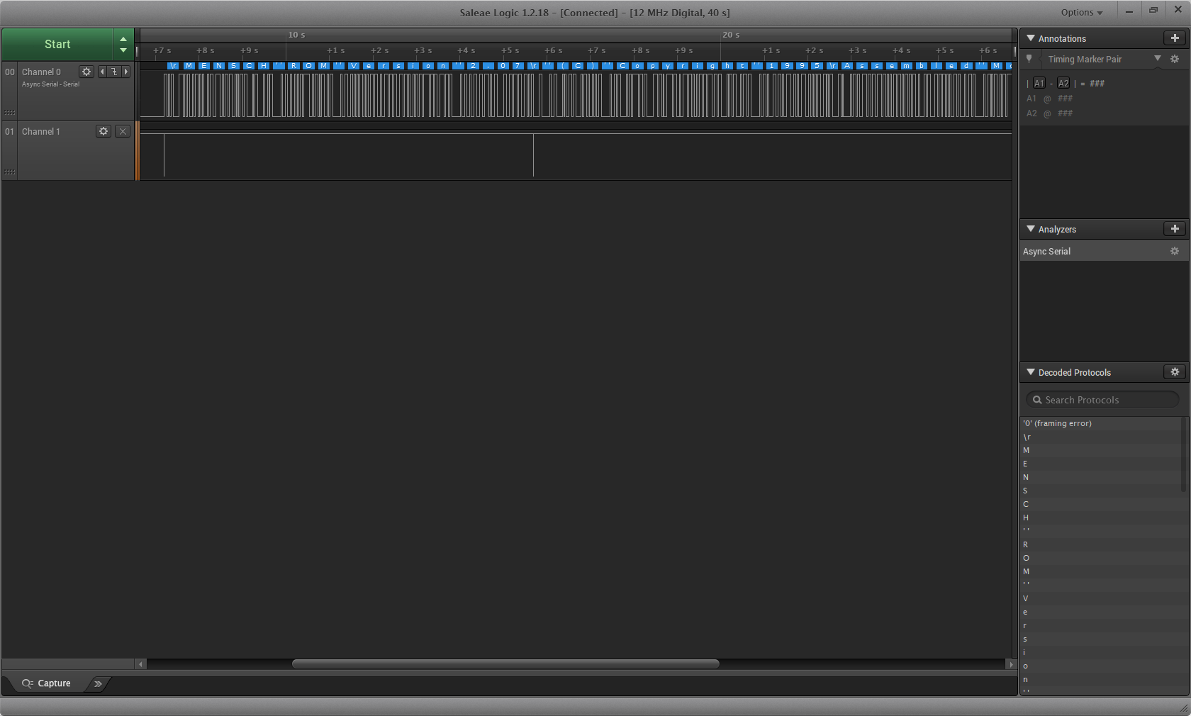

As I choose to put a 4.9152 Mhz clock instead of a 3.6864 MHz one, the capacitor values shown in the w65s265qbx schematics were not the right ones to the crystal I put.
The chip was running all the time at 32768 Hz. I could check that the serial port was actually sending out the welcome screen by attaching the logic analyzer. It was so slow that it took more than 30 seconds!!
I replaced the fixed value capacitors with trimmers and started to slowly adjusting them until they kickstarted the crystal. I can't tell the right values for them, though. They are such a small value that my cheap meter wouldn't give a reliable measure. The range they have is 5-30pf so the value is in there. Also, I suspect that once I start to add chips to the mix they will need more adjusting, but for now they make the '265 run.

Congratulations on your success! But please tell me there are some ceramic supply bypass capacitors snuggled up close to the PLCC, and they simply happen not to be visible in the photo. If they are indeed absent then that could very well explain why you had trouble getting the crystal oscillator working (not to mention attracting other squirrely problems in future). :!:
Nice to see someone playing with a bare '265, BTW -- I mean one that's not part of a WDC board. Thanks for sharing!
PostPosted: Mon Jun 15, 2020 4:14 pm
Posts: 344
Thanks. Yes, there are four capacitors in NSEW of the chip. I'm recycling components from a old DENON audio amplifier. That's why there are different sizes or pacakges.
