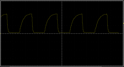

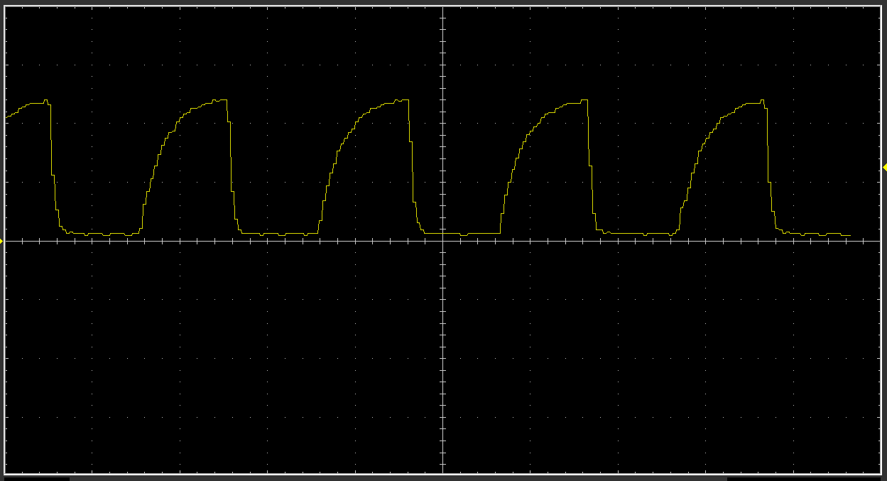

Well... it was easier than I thought... At least, finding what's causing my problems. Fixing them, still unknown.
I'm definitely trashing PHI2. This is PHI2, with no weirdos attached

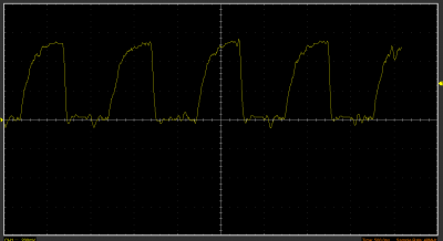

Adding B0

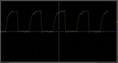

Adding B1

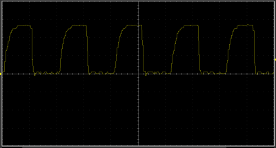

Adding B2
The more things I have feeding on PHI2, the longer it takes to raise.
Interestingly enough, connecting just the scope with the sensitivity set to x1, is causing the same effect.
BTW, I haven't seen anything out of normal on Vdd. All three boards together draw 6.3 mA. Removing boards one by one, shows each board drawing between 2, 2.3 mA each.
Now I'll add bypass caps and, if nothing changes, I'm thinking about running PHI2 through a buffer.
Heating my soldering iron!
PostPosted: Tue Oct 08, 2019 10:28 pm
Yeah, old machines like the C64 typically use 74LS logic which has much higher pull-up impedance than pull-down. The important area, fortunately, is below the TTL Vih threshold of about +2.4V, but even here you have enough loading to change the slope of the signal noticeably. So the signal spends more time in the ambiguous zone between Vil and Vih, which can be seen by logic as rapid glitches.
Inserting a 74HCT buffer in the clock line should reduce the load on the C64's clock to a single CMOS input, and the CMOS output will have no trouble driving everything you want.

Basically, a 74HCT input is supposed to have 5pF..10pF of capacitance to GND.
When increasing the capacitive load on the PHI2 line by adding a lot of 74HCT inputs to it, PHI2 needs more time to rise to HIGH level.
Logic level threshold for 74HCT inputs is supposed to ba ca. 1.3V, and like Chromatix has pointed out,
it's an interesting question if 74HCT inputs might be getting "confused" if the rising edge of PHI2 goes through that voltage level too slowly.
Try running PHI2 through a buffer, preferably a 74HCT245, because the 74HCT245 might be a better choice for driving capacitive loads than the average 74HCT logic gate.

A single buffer did the trick!

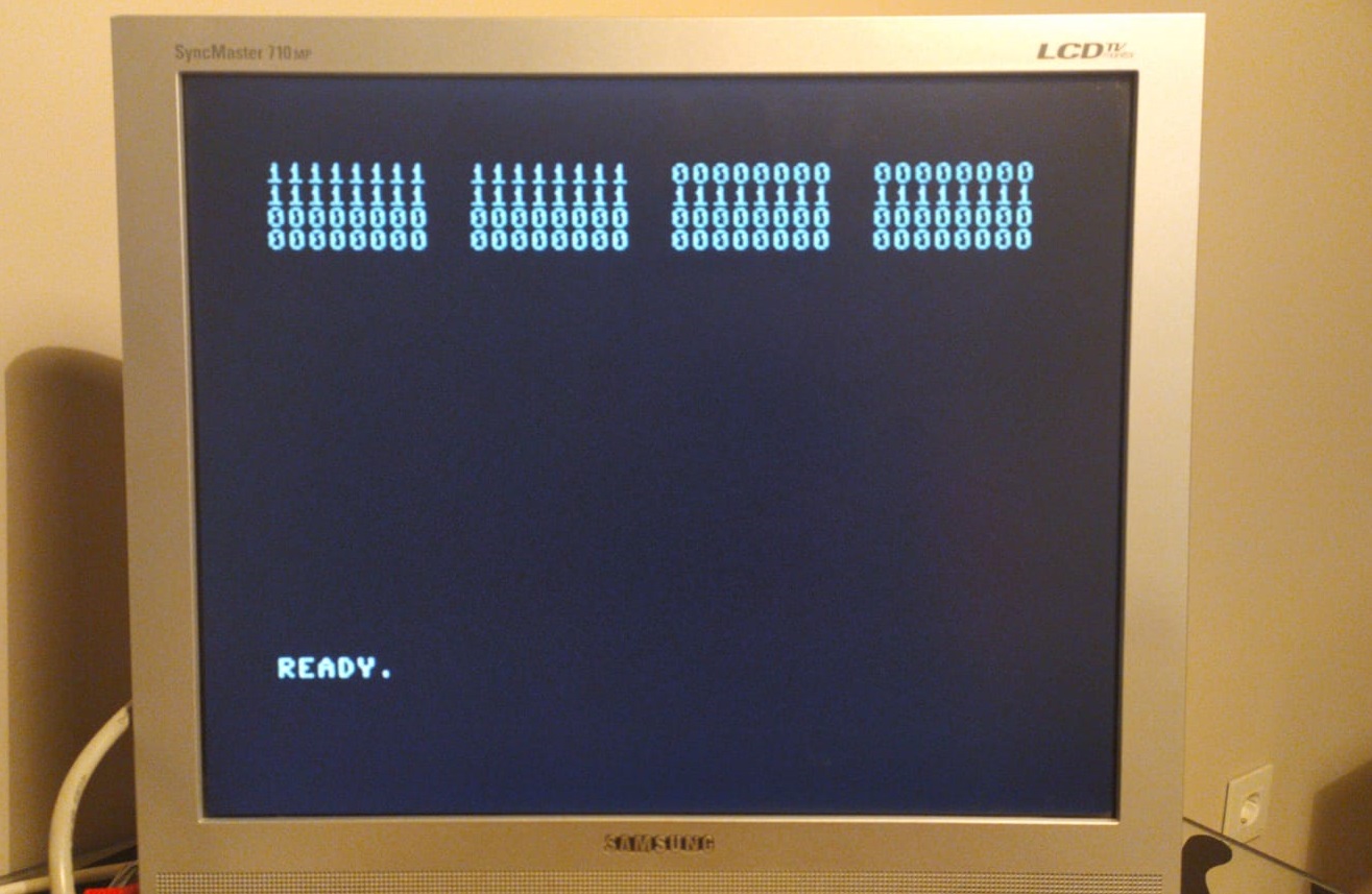

Using a small piece of assembly that took me 2 hours to complete (I've got so rusty)
I've been able to try plenty of stuff. There are some things remaining that will need some heavy use of my logic analyzer, as timing's crucial.
The good news so far :
  1. Starting values. Timers' latches should be set to 1, control register to 0. Big facepalm here, as I completely messed up the schematics, a (very much) needed inverter is missing. As a consequence, Timers' latches are perpetually set to 1. Some PCB hacking has been done and, now they initialize with rubbish, but at least I can write to them. An easy fix for rev 2. Control registers initialize OK
  2. PB7 and PB6 override. Setting the bit in the control register forces PB6 and PB7 as outputs.
  3. Timer reloading from latches. Works fine, whenever a write to the high byte with timer is stopped, whenever FORCELOAD is written with a 1 (which is stored nowhere), or whenever there's and underflow
  4. Timer output on PB6 and 7. TIMERB toggle output works. Pulse output requires the logic analyzer to check. TIMERA output is completely missing. Circuits are the same for both timers, so could be caused by a bad solder
  5. Timer B won't count Timer A underflows. Could be related to the above issue
  6. One shot mode. It works, timer counts down until the overflow happens, Then relatches the value.... but then it ticks once more before stopping. Same for both timers.
The untested bits:
  1. Pulse output.
  2. CNT pulses counting
  3. Different overflow behavior counting PHI2 vs CNT (4-3-2-1-4-4-3-2 vs 4-3-2-1-0-4-3-2-1-0)
And the know issues:
  1. TIMERA underflow seems to fail. Could be a bad solder
  2. START bit gets set to 1 on its own sometimes. Same for both TIMERS.
  3. Adittional tick in One Shot Mode. I think this is caused by the 2 DFF feeding the clock to the Timer. When Timer stops, there more clocks in the queue. I probably need to clear one of them when the underflow is reached.
All in all... I'd say it's a 7/10 score so far. START bit has me scratching heavily my head... but I think I should better sleep on it. I've had no ideas about what's causing this so far.
Cheers!

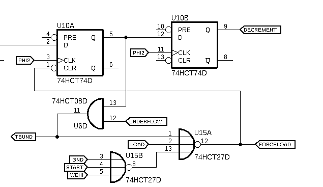

Exactly as suspected, clock in u10a was cleared on timer underflow, but clock in u10b wasn't. (PIN13 was connected to Vcc, this is an old image).
Connecting the FORCELOAD signal to U10 pin 13, causes the clock queue to be emptied on timer underflow. In One Shot mode, timer gets reloaded and stops counting in the same cycle (expected behaviour). In continuos mode, when timer reaches 1, it reloads, skips one cycle, and keeps counting.
One more issue crossed out my list!
