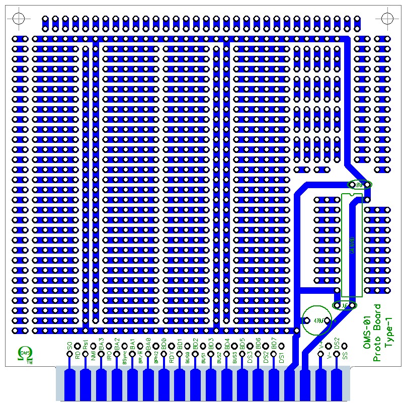

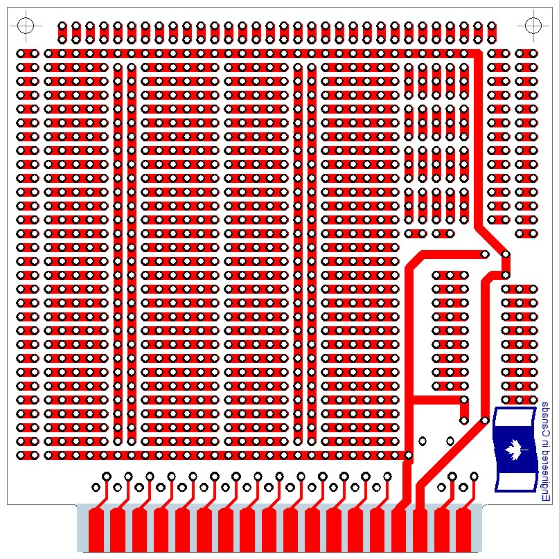

Those protoboards (plugged into the slots) look pretty sweet, too. Are those also your own work, and are they available for sale? More info (a proper photo?) would be nice... :)
PostPosted: Fri May 04, 2018 2:12 pm
Posts: 1007
They are my own work. I did then double sided so I could mount parts on either side if required. If you use Diptrace (or download the free version) I can send you the file for them and you can modify them as you wish. I could even create a library with the finger connector which is a 36 pin.
I got 10 of them made up at JCLPCB for $2 plus shipping.
Images attached are of the top and bottom.

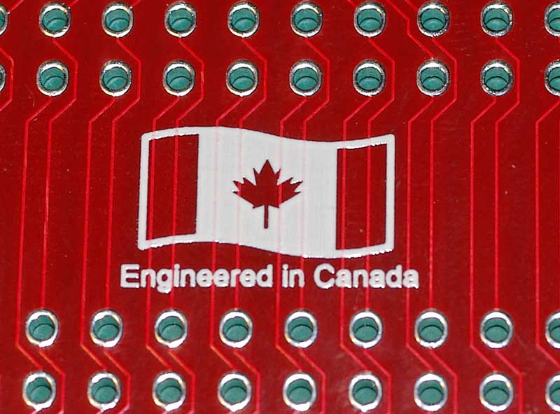

There is even a little flag on the bottom. You gave me the idea for the flag about 6 years ago or so. It goes on all my boards now.

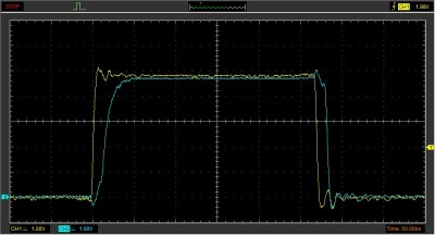

Yes, correct. The timing charts of WDCs 6502 are referenced to Phi2 (in). I'm used to the NMOS charts where Phi2 (out) is referenced. But there is no information about the delay between Phi zero in to Phi 2 out, except for an old Commodore datasheet where they say its 5 ns. And 5 ns wouldn't matter anyway.
And yes, the board is looking very nice!

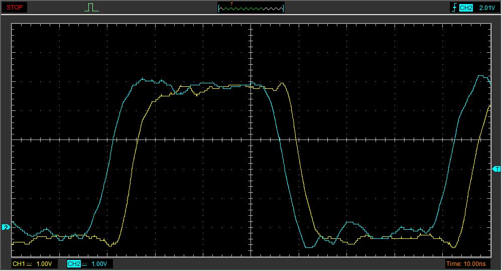

Here are various timings on the clock for various set-ups. Quite a difference.
This first one is PHI2in vs PHI2out on a W65C02S running at 14mHz. You can see PHI2out (yellow) lags about 5nS on the rise and about 3nS on the fall. It's easy to see why, if 6nS delay in PHI2 going to a 65C51 is enough to throw the train off the rails, WDC don;t want you using PHI2Out for the system clock in fast environments.

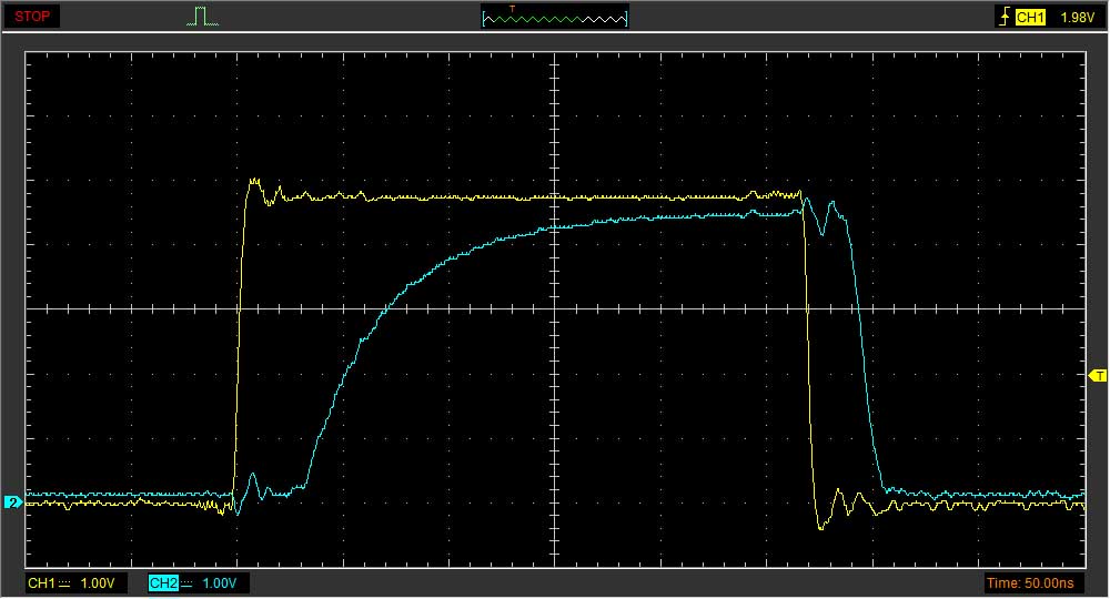

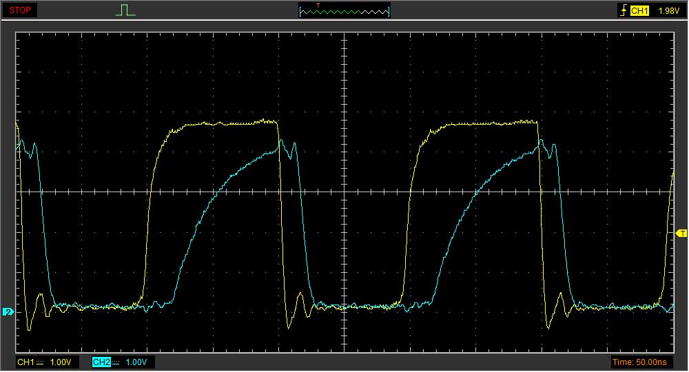

From here on yellow is PHI0 (clock in) - sorry about the change...
This next one is and NMOS 6502B over clocked to 5mHz. PHI2 lags PHI0 35nS on the rise and 18nS on the fall.

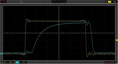

Here is a NMOS 6502A at 1.8mHz.

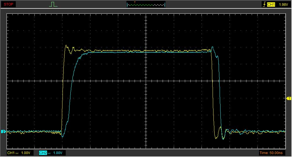

And finally, an R65C02P4 at 1.8mHz.

Ouch! Thats a really bad clock slew. Fast components and low slew rate is a poor combination.
PostPosted: Thu May 10, 2018 8:25 pm
Posts: 1007
Which one are you talking about, the top one? If you look carefully it has a slew rate of over .7V/nS. Do you really consider that slow for this application?
