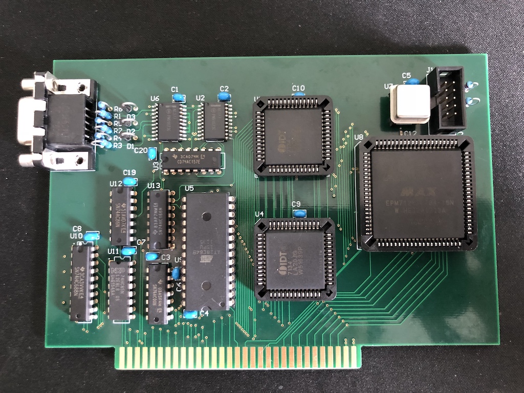

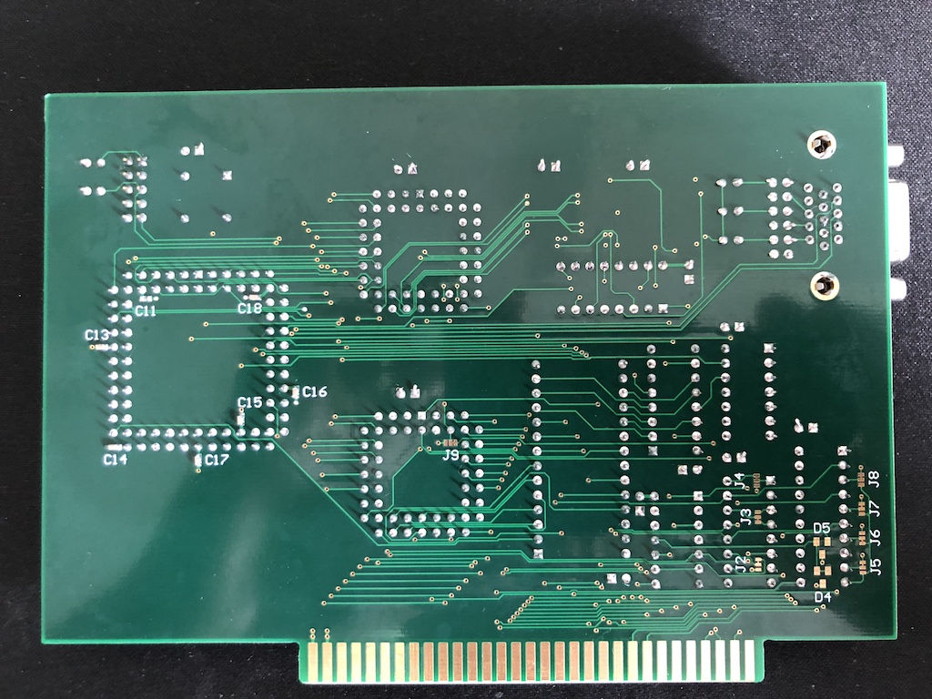

Got some PCBs made, ordered via JLCPCB and am pretty happy with the results!
There are some jumpers to change the address decoding in case I decide on changing my memory map
I also added a jumper that allows you to tie /OE high on the memory port used for the host memory access. This way the VRAM can overlay system ram without having to drive another signal to the glue logic inhibiting the on-board ram.
Thanks everyone for your help making this happen!
Good idea. BTW, what sort of system does this board plug into? Sometime it'd be nice to hear about that project. :)
Glad we could help. You've done a very tidy job -- it turned out great!

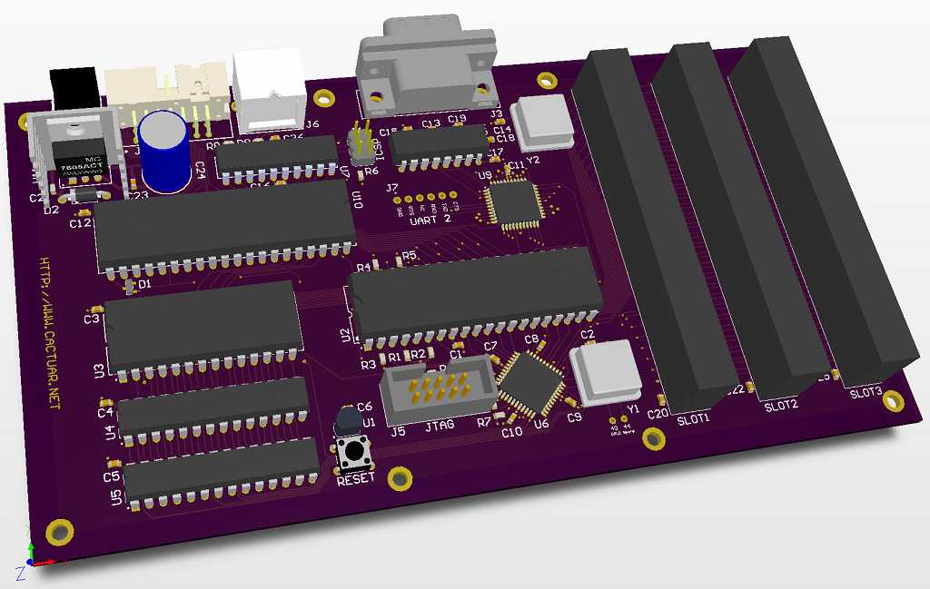

PostPosted: Wed Oct 24, 2018 3:28 am
Posts: 173
Location: Sweden
I should do a proper writeup on the system for sure. There's some documentation in my github here (schematics, images) https://github.com/LIV2/Homebrew-65C02-Computer
Basically it consists of
* 4-layer PCB
* WDC 65C02 currently running at 10MHz
* SC28L92 DUART
* PS/2 Keyboard port
* Glue logic driven by an Altera EPM7064S CPLD
The layout is pretty terrible (which is why I haven't really shown it off), because of the way I laid out all the ICs the traces are very long (I naively did that thinking it was better than having a boatload of vias)
The 28L92 placement might seem odd but that's because I originally laid everything out with a 65C51
