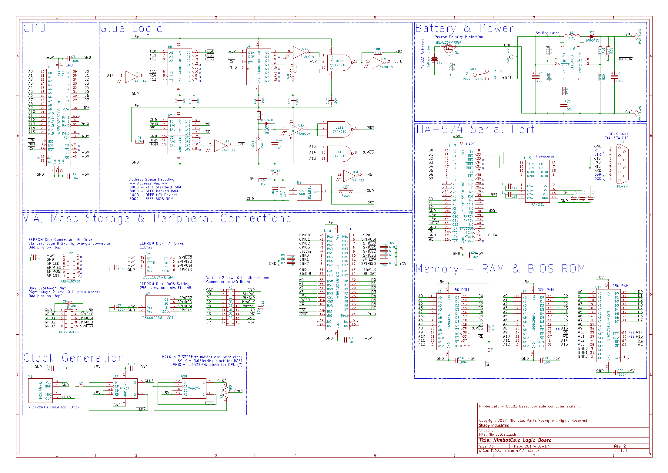

PostPosted: Tue Oct 17, 2017 7:05 pm
Posts: 362
Well, another day, another computer design from Alsi....
This is the schematic of the system that all this decoding logic was in aid of. Its still called the Nimbot, and is derived from what you have seen previously, but I decided that I wanted to go for something a bit simpler (in the sense of easier to route) but also more general purpose. I still plan to make a games machine at some point, but I think it'll probably be based on this design rather than the previous one. I am much happier with this one overall.
I am unsure whether to expand the I/O Board header (P3) so that I can use this same logic board for both a games machine and a general purpose one, swapping out only the I/O board (the I/O board would have the gamepad, screen, and sound generation circuitry on it for a games device and a character LCD, keypad and buzzer for a non-games device) or whether to KISS as it is and make the games device have modified logic board.
File comment: NimbotCalc Logic Board
