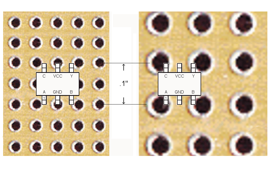

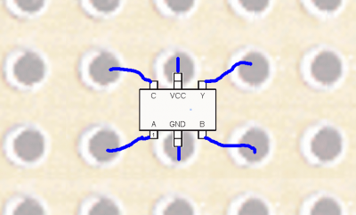

PostPosted: Thu Aug 02, 2018 1:08 pm
commodorejohn wrote:
That is a nice piece of silicon to know about. Unfortunately I don't think my skills extend to SMT work at this point in time, and it doesn't appear to be available in a through-hole package...
I think you'll find SMD parts easier to work with as you grow accustomed to them. And a 6-pin device has the advantage that most of the pins are located on a corner :D (giving wider access to your soldering iron).
Of course a custom PCB is ideal, but for more casual hacking you can use an adapter like this...
SOT23 adapter.pdf [91.11 KiB]
Downloaded 141 times
... or do a dead-bug approach directly on your through-hole protoboard. As you see below, a SOT-23 sits quite comfortably on a .1" grid (and even more comfortably on a .05" grid).
BTW, these "1G" gates don't all use the same pinout for power and ground -- some use the corner pins, and some (like the one in my diagram) use pins midway along each side. Also, some devices can run on voltages up to 5V and others are recommended for 3.3V or less.
For more info, including a device selection guide, see this post.

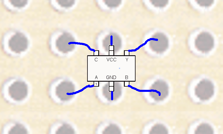

Edit: here (below) is one prospective mounting scheme. The corner pins attach to leads running to adjacent holes, and the center pins go straight down. Assuming these pins are Vcc and Gnd, the bypass cap could be soldered on the opposite side of these same holes.

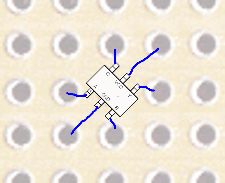

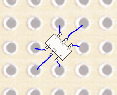

PostPosted: Thu Aug 02, 2018 2:55 pm
If you placed the part at 45• over one hole, I think that would give you a fair bit of room.
PostPosted: Thu Aug 02, 2018 3:11 pm
Not a bad idea, especially if the power and gnd pins are on the corners. But if they're midway along each side then the connections to the bypass cap are no longer at the minimum length (although they're still quite short, considering how small the entire assembly is).
