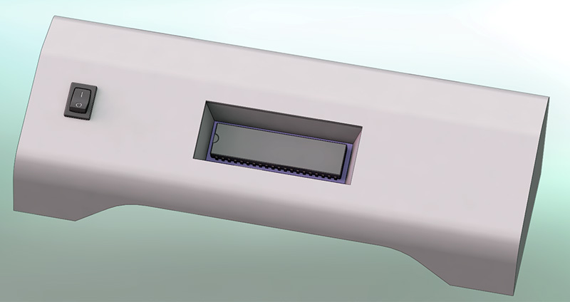

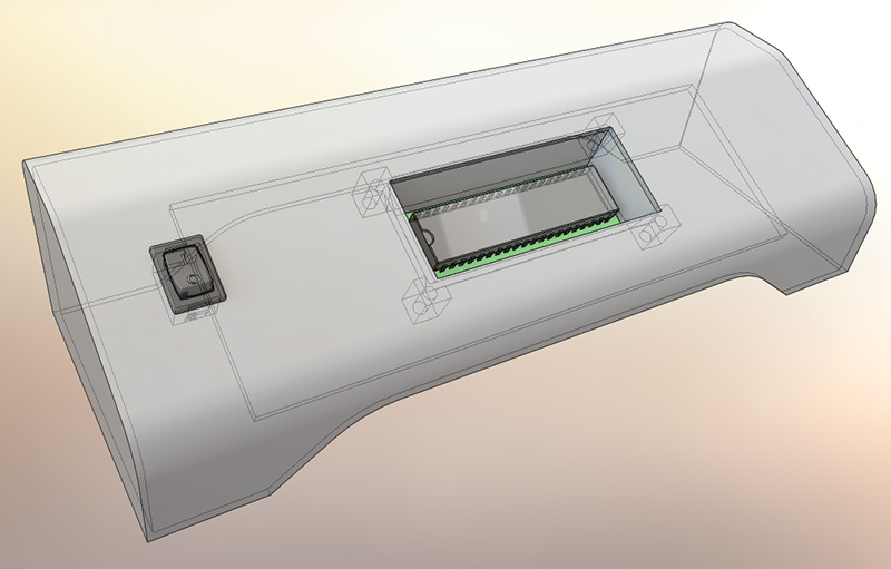

PostPosted: Thu Jun 29, 2017 6:57 pm
Posts: 642
Took a few minutes to throw together a concept case in SolidWorks...
This is far from complete, but shows the general idea of a windowed 6502.
The open base allows the box to sit over a monitor base, so it can live in front of the keyboard.
I will also be adding an SD slot and multi-color status LED on the front of the case.
Overall size will be based on the smallest PCB I can make.
Radical Brad
