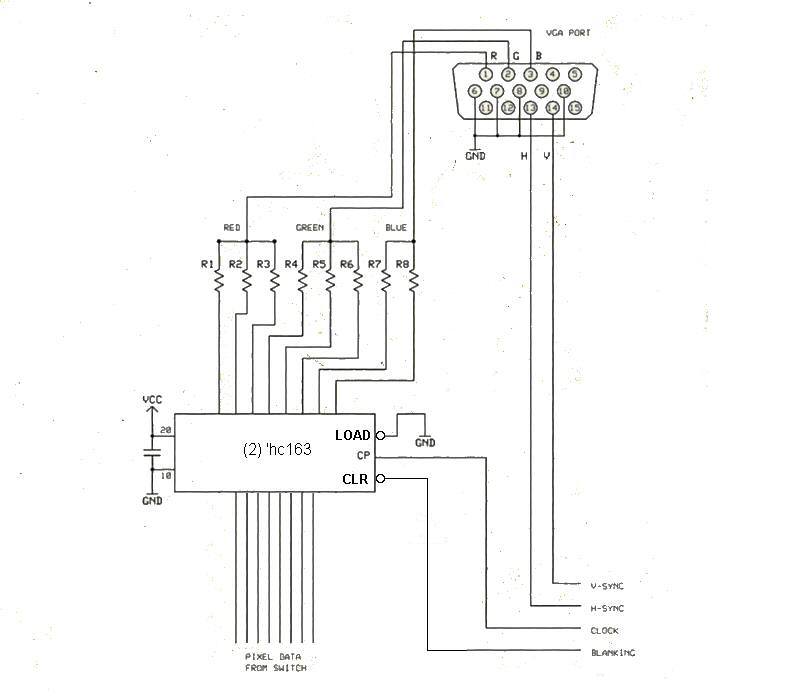

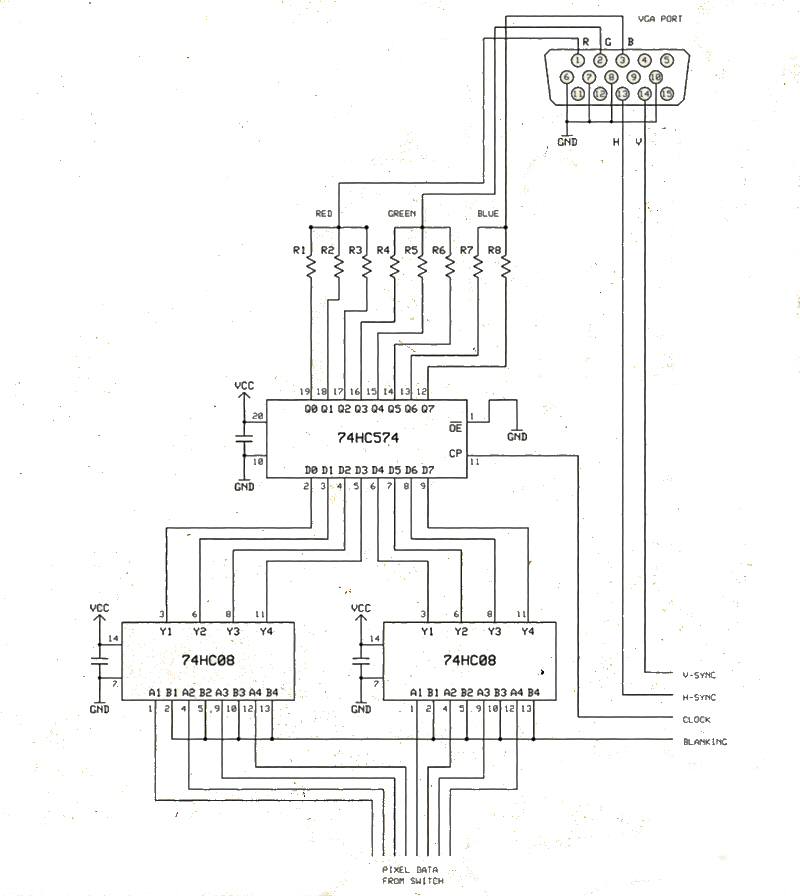

It's all good, and I envy you being able to indulge in a project like this. 8) What I was referring to was more basic, though -- simply the notion of replacing this

with this:
In this application the '163s "counters" don't count in any way -- they are used simply as edge-triggered registers, featuring the synchronous load and synchronous clear modes we require.
It takes a pair of 163s to implement the 8-bit register, but I didn't bother to explicitly draw both 163s. The power and control pins all go in parallel; only the data IO pins are separate. The CET and CEP inputs can be tied either high or low; the thing won't ever count anyway because the load & clear functions both override the count function (and clear overrides load).
The only potential problem I can see is if one '163 happened to be significantly faster or slower than the other (I don't think a slight difference would matter). Luckily, for a project like yours it's acceptable to hand pick your parts. As long as both 163s are from the same vendor -- the same lot, even -- I expect that'd resolve any issue. But it's always possible there's something else I'm missing.
cheers,

Hey, thanks for the idea of using a 163 as register with clear... never thought of that one!
It's like learning a new op code!
Although this will certainly come in useful at some point, there is an issue driving the DAC from a 163 as I have found out in a different test. As you mentioned, pathways are not perfect through each of the 4 bits, and this shows as slight phasing on some monitors that have to self adjust. So I would still need one more 574 after the 163's, which puts me back to the same chip count as the 2 AND gates.
But I will be using this idea elsewhere, so thanks for posting this!

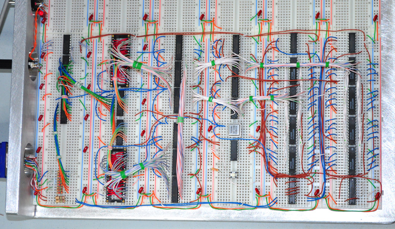

PostPosted: Sun Jun 28, 2015 1:51 am
Posts: 690

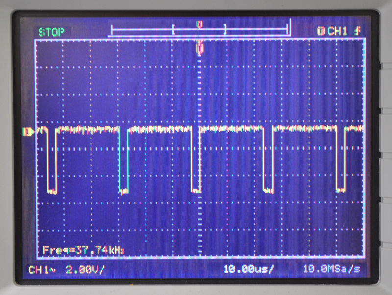

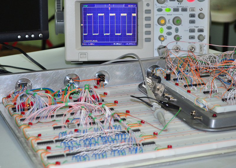

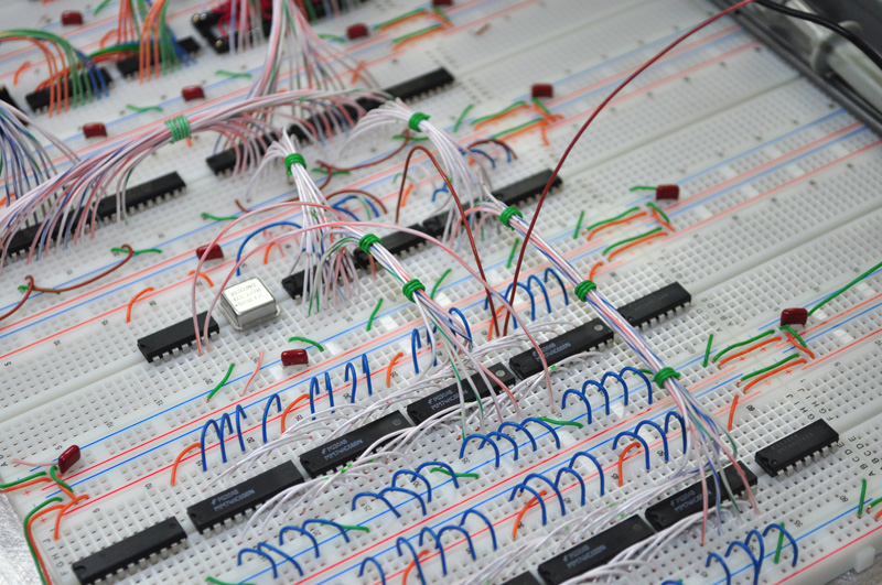

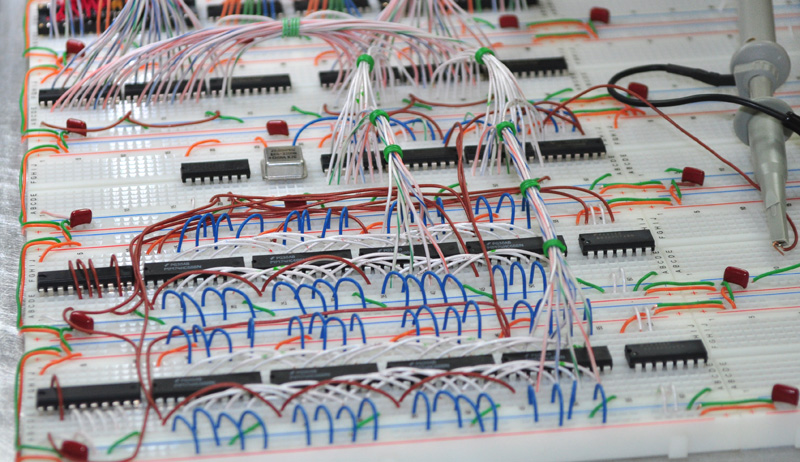

After a long day of yard work, I decided to relax in my cool basement lab and mess around on the Vulcan-74 board for an hour.
With all of the comparators and address counters wired up, I hit the switch and started probing the board.
The vertical counter is resetting at 60Hz, which is exactly what was expected.
Notice how much neater the new board is compared to the original test mess.

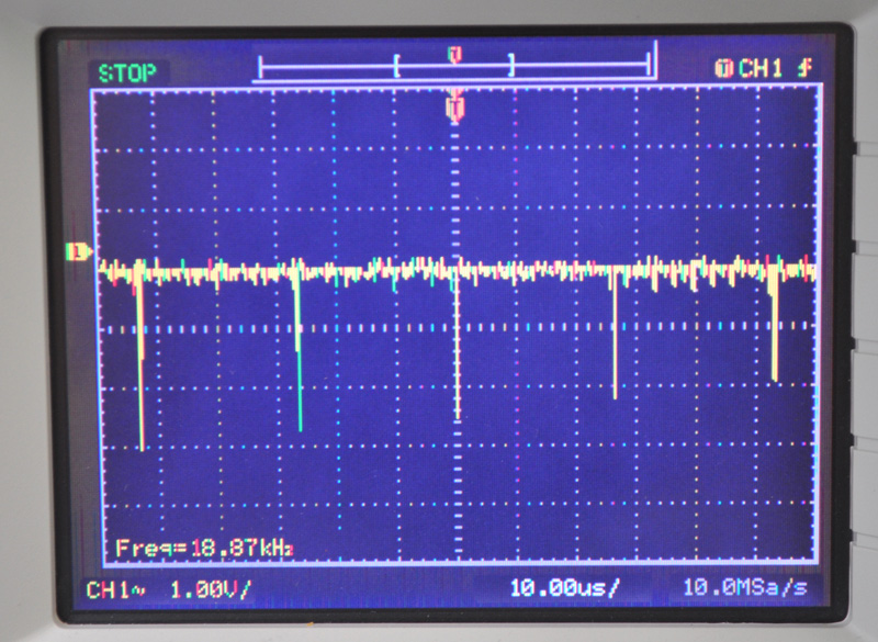

Probing the comparator output for the horizontal line reset.
This is the vertical refresh timing divided by two... perfect.
The pulse is sharp since it is low for only 1 out of 528 cycles.
This is the flip-flop that controls the horizontal sync pulse.
Horizontal sync is active when the pulse is low.

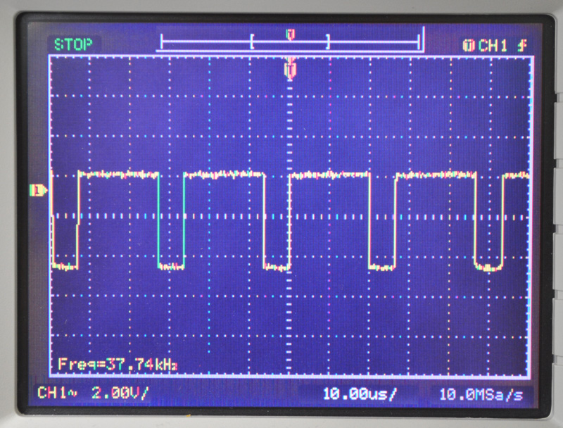

This is the flip-flop that controls the horizontal blanking period.
The high time is when horizontal pixels are dawn.
Once again, timing works out exactly to the 800x600 VGA standard.

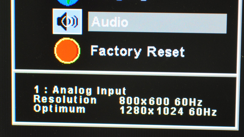

With the sync pulse logic working, the monitor locks on to the 800x600@60Hz standard.
This monitor is native at 1280x1024, so there will be a 1.6 to 1.0 clock phase adjustment.
At my final resolution of 400x300, this phasing is hardly noticeable.

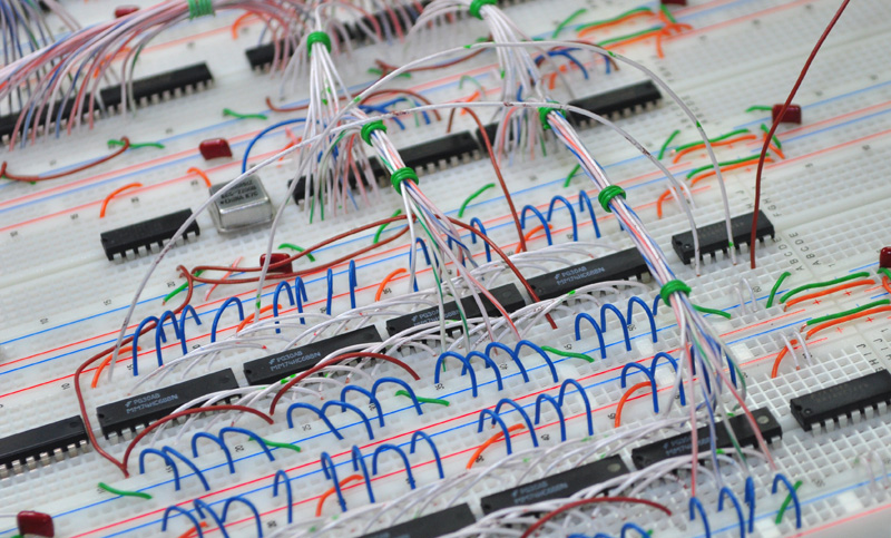

This is the entire dual buffer video system with all wiring cleaned up.
The video board is capable of driving a monitor without any external control.

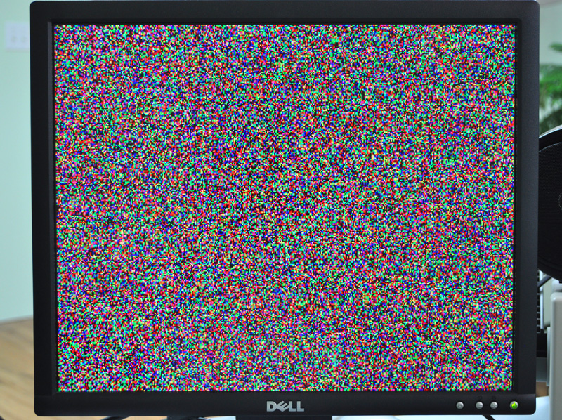

Of course, the SRAM will contain only random pixels at this point.
Speaking of random pixels, here they are in vibrant 256 colors.
Each bank of SRAM contains 120,000 pixels, with seamless buffer switching.
The banks are swapped on the vertical sync pulse so there as no banding or tearing in video.
Double buffering means the CPU can draw to one bank while the other is being sent to the screen.
The non-live bank can by accessed as if it were completely disconnected from the video logic.
VGA from a handful of common logic chips ans some SRAM... yeah baby!

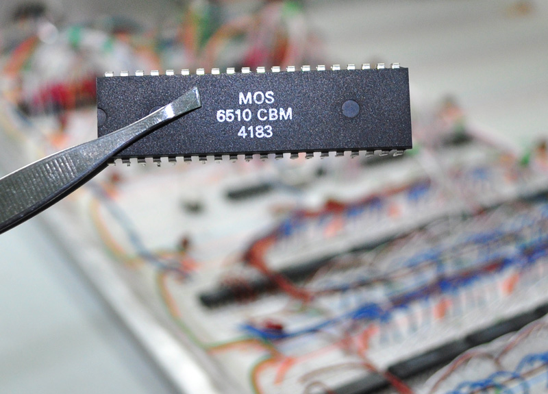

Soon I will be plugging my favorite processor into the board!
Ok, I am not using a MOS variant, but I did have to give it a glory shot!
The next stage of Vulcan-74 design will be the ultra fast GPU logic, which will eat up at least one more column on the board.
The GPU has its own independent 20 bit address bus, and 1024K SRAM at 10ns, where it will store "sprites".
My GPU design is kind of like an Amiga Blitter on steroids. I will deal with XY blocks, not just lines of pixels.
Alpha (transparent) pixels are also built into the GPU, so the programmer won't have to do slow XOR tricks on graphics.
Ok, that's all for now, I will try to post a video of the bank switching if I have time tomorrow.
Until the next rainy day....

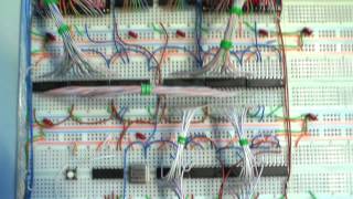

PostPosted: Sun Jun 28, 2015 10:37 pm
Posts: 690
Here is a quick video tour of the VGA System...
https://youtu.be/nQtSusVWgk4
Next tests will be done with an ATMega-1284, drawing images to the screen.
Once the images tests are passed, the GPU logic will be prototyped.
The 6502 will then replace the AVR, leaving nothing but 7400 series logic on the board.
The sound system will be the last thing to be made, once again 100% pure logic.
No point calling something Vulcan-74 unless it lives up to the name!

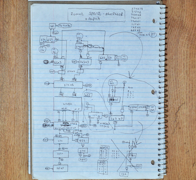

The weekend is here, and if I get rained out of my construction project, then the chips shall fall (or at least get plugged into the breadboard).
I have given my 20 MHz GPU system some serious thought and ran it through an intensive simulation process (AKA - 5 minutes and a sheet of paper)...
Yeah, this is about as much pre-work I do on these projects!
I prefer to hit the board rather than mull over why something might not work.
The best simulator is a prototype, dude! Don't fear the "real World".
Anyhow, here is the plan as per the chicken-scratch above...
A 10 nanosecond bank of 1024K of memory (Graphics Memory) runs on its own isolated 20 bit address bus, fired by a series of 163 counters clocked at 20Mhz.
This is contiguous memory holding the "sprite data". The CPU can preset set the 163s with 20 bits of "Source Address".
The GMEM is clocked through 3 stages, with a series of 574s that keep propagation below 40ns, and allow switching to the dual buffer Video Memory.
As pixel data is pumped out of the GMEM, it is qualified with a known value set in the 688 comparator by the CPU, which is called "Alpha Color".
Any data NOT equaling Alpha, is sent to the VMEM data port, registered in sequence with the address and WE, controlled by the Alpha logic.
Data equaling the Alpha Value is considered "transparent", and is not drawn. This is how the GPU handles automatic transparent pixels at 20MHz.
On the "Destination" side of the logic, we have a split set of chained 163 counters running the X and Y address counters to the VMEM back buffer.
The CPU presets these values; Destination-X1 and X2, Destination Y1 and Y2. This tells the GPU where on the screen to draw the sprite block.
As you can see, sprites are not limited in any way, and can be as small as a single pixel, or as large as 512x512 due to the 9 bit XY addressing.
A few 688s control the resetting and wrapping of XY counters, and then trigger a "Ready" signal at the end of a sprite transfer.
By using this GPU, the 6502 can just set a few bytes and then go on its way as the GPU moves massive sprites around the screen at 20 million pixels per second!
Here is a best case comparison of drawing a 32x32 sprite to the back buffer using the GPU and the 6502 only...
Video -> 1 full frame @ 60 Hz lasts for 331,584 cycles @ 20 Mhz
6502 -> Optimized assembly loop @ 40 cycles per pixel = 40,960 cycles = 8 Sprites
GPU -> 1024 cycles @ 20 MHz = 323 Sprites
So if the 6502 could actually run at 20MHz, it could only send 8 sprites per frame as compared to 323 sprites drawn by the 37 logic chips in the GPU!!
And since the 6502 need only hurl out a few bytes to setup the GPU, it may only need 50 cycles of time before it can move on to other game tasks.
With the GPU having an independent dual bus, the 6502 could go onto game logic or doing sound tasks while the GPU is running... no waiting around!
So that's my plan.
I will start hammering in chips sometime this weekend, depending on the flow of cloud juice.
Radical Brad

Excellent - I love block diagrams, they can convey so much more than code or schematics or text.
Edit: so your GPU gives you the equivalent horsepower of an 800MHz 6502. That's a new record!
