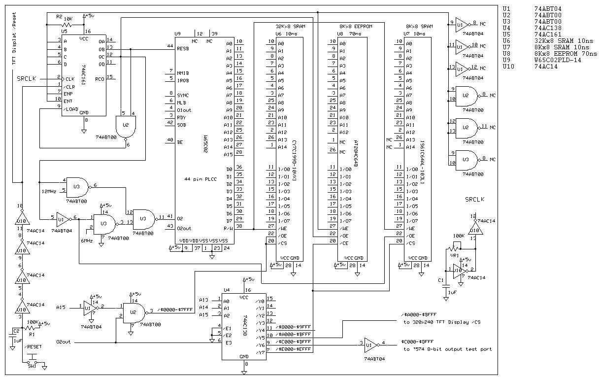

Ok, so how much time does this leave for address decode logic? I am still finding it difficult to interpret the timing logic. While ABT logic is plenty fast, 2 or more logic units in series adds up quick (~7ns)... I'm looking at using an ATF22V10C-75, which is 7.5ns. At the speeds discussed (~14+MHz), is it worth it to investigate SPLD's from Atmel?

I don't see why not. My CPLD is a 15ns part and it is decoding the address bus, lower 4 bits of the bank address from the data bus, and the R/W, /RES, and PHI2 and creating an I/O select and RAM selects with no trouble at 14MHz on the 65816. It will depend upon several factors, including bus loading and capacitance.

I plan to start with the Atmel ATF22V10C only because my EEPROM G540 burner, (which I am presently using to program the 8Kx8 Atmel AT28HC64B-70PL EEPROM), also burns .jedec files for the EESPLD 22V10 series. They have versions that go down to 5ns. I've been able to buy a few Atmel 7.5ns for a little over $3 each.

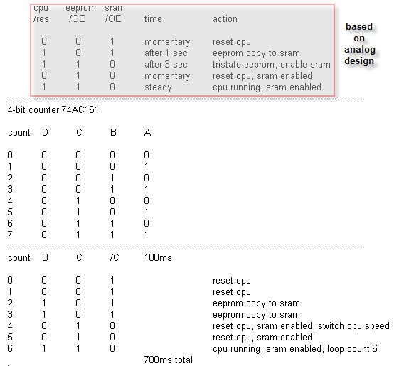

BUT first, tomorrow the digikey order comes in for some 'ABT IC's, 74AC14, and 74AC161, and I put my idea to test. Final schematic below: Thanks to leeeeee, nightmaretony, Garth for the high spead MUX circuit for phase2, and BDD and 8BIT for their time spent on critique and advice. I'll wire it all up after next weekend. Hopefully have an unwirewrap tool by then...
Instead of editing/re-editing 1 or 2 old posted schematics, I chose to keep the old and post new, to show the progression...
Hope it works, or this thread should die real quick ;).
Truth table logic for the counter:

I wired it all up. Having problems with the SRClk, which is derived from the 74AC14... Unstable frequency on the scope... Tomorrow is another day off. I spent a good 10 hours on rewiring most of the address decoding, including adding 4 IC's. The Schematic above is what I have so far, and is up to date.

Fixed the oscillator part. That is just a crappy little oscillator circuit using 1 Schmitt trigger. I had to make one using 3 inverters, no prob there. It is making the 'AC161 count up every 1.5 sec's, giving the software plenty of time to copy. Also, instead of 12MHz, I am using 6 MHz on both NAND gates, since I know it runs reliably at that speed. Not working yet...

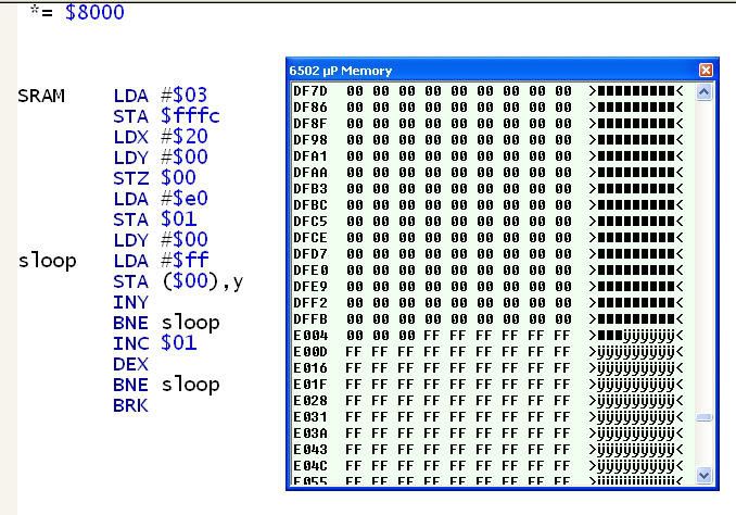

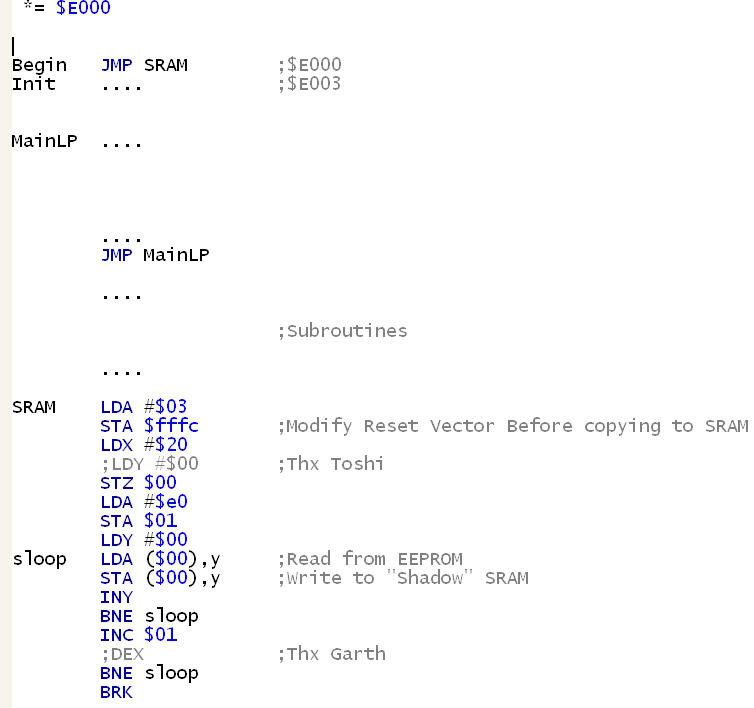

I am writing the portion of code that copies the EEPROM to the RAM, and just to make sure I get all the variables right I made a test program. It's not working like expected. Is there an error in the debugging part of M. Kowalski's assembler?. It should store #$FF from $E000 to $FFFF. For some odd reason it is starting at $E007. Here's a pic of the software and the memory, after the program has been run:

o You are loading Y with zero twice, probably because you converted the STY to a STZ.
o The inner loop does not need to load the accumulator with $FF every time through the loop, since the accumulator is not modified in the loop.
I don't know why it's starting at $e007 either. I suspect your entry point is wrong somehow.

I don't see any reason why it would start at E007, but I would do it this way (some explanation is in the comments):
SRAM    STZ  00           ; Set up addr base lo byte,
        LDA  #$E0         ; then hi byte.
        STA  01
        LDA  #$FF         ; Value to fill RAM with.  Load A only once.
        LDY  #0           ; Init index for small inner loop.
sloop         STA  (0),Y
              INY
           BNE  sloop
           INC  01        ; Outer loop's index is the addr base high byte itself
        BNE  sloop        ; so when it's done filling page FF, it drops through.
        LDA  #03          ; Now fill in the RST vector.  (If you do it first, it gets
        STA  $FFFC        ;   overwritten by the loop above.)
        LDA  ?            ; incl high byte, which was left off earlier.
        STA  $FFFD

That was just a piece of test software to make sure I get my INC's, and DEX's right so I don't overlap into other memory space accidentally. I'll have to assume the software really is copying, starting at $E000 and not $E007. The "real" software which is on the EEPROM looks like this:
The Reset Vector has already been programmed into the EEPROM for $E000. This piece of code modifies it after booting from the EEPROM to $E003, the CPU will be reset once again by the counter and the EEPROM /OE disabled, and the SRAM /OE enabled, and the Init, and Main Loop will be running from the SRAM at that point. That's the idea anyway.
