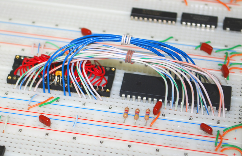

Since my IO scheme seems stable, I ripped up the test wires and repositioned the 6502 and SRAM for optimal wire length.
I am using the same 10ns 512K SRAM, and may look at doing some banking trickery later on.
For now, Address Lines A16-AS18 are just held low. I could have 8 banks of 64K with this memory.
At this point, the only bottleneck that may prevent 20MHz operation in the 6502 circuit is the read function.
To read from say the Sprite Memory, there is about 46ns of propagation before the data is ready.
I have a plan that will divide the clock by 4 for the next cycle following a read, but for now will just run slow until things are working.
After the 6502 is up and running, I will work on the Boot Loading system. I have several options.
I think using an SPI Flash Memory is the best bet, as I can have the logic initialize and read the memory.
The Boot Memory (Cartridge) needs to hold at least 4MB of RAM, more if I plan to go with 6502 paging.
Next stop... 6502 IO Decode System rewired and tested.
