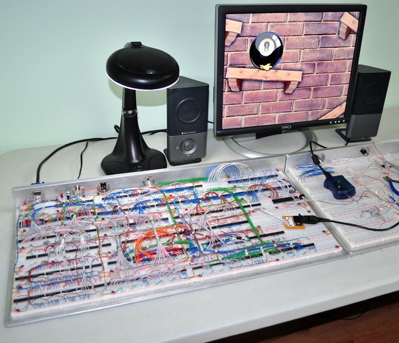

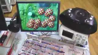

I do have a solid plan though, and have managed to keep the Vulcan CPU down to single cycle operation.
The most difficult part so far was the Pre-Inc and Post-Dec of the 64k Call / Return Stack.
Here is how I managed to keep to single cycle operation without bending the "rules" too far...
To start, I intend to have the CPU run at 4 MHz, and crank it up once it's working. 10Mhz would be a nice result.
To handle the Pre and Post requirements of the 16 bit Call / Return counter, I need 2 positive edges (2 cycles).
So, I have doubled the Main Clock to 8Mhz, and split it into 2 phases, with phase 2 only for the Call stack.
Since every other part of the CPU still runs on a single 4MHz cycle, I will still consider it single cycle at 4Mhz.
I could have done the same with a 245 delay chain, but this can lead to issues of someone copies the design.
So far the longest path is the Conditional Branch Controller, which should work up to 10Mhz, possibly 16Mhz.
A 10 MIPs DIY CPU that can do single cycle 16 bit math will be just fine.... yes just fine indeed!

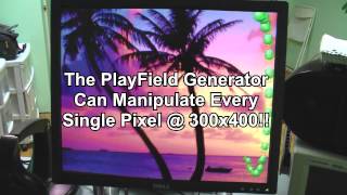

For those reading this from the bottom up, here is where my project is at right now (Video Section only)...
400x300 VGA with 256 Colors. 100% Pure Common 7400 Logic.

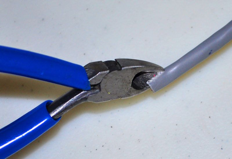

Random question, do you buy pre-cut and stripped wire or do you do it by hand, and if so how?

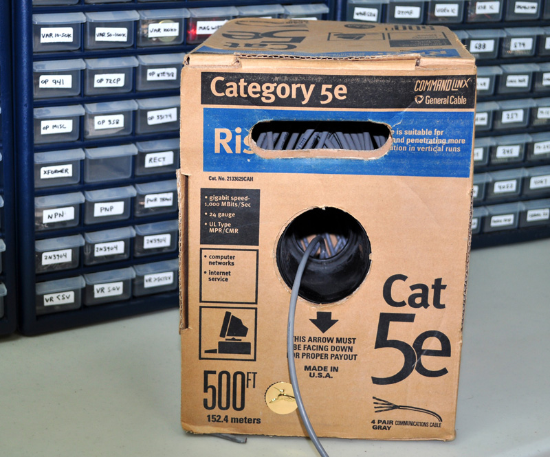

It's a good question, when you consider the need for thousands of cut to length wires on a project like this!
I always take the path that includes as little outside help as possible, so yes, I roll my own wires. Here is how...
Tools Required
- Side Cutters
- Knife
- Free time
A box of Cat-5 wiring. 500 feet will last you a while!
I use Cat-5 wiring for all of my breadboard work, as it is economical, easy to shape, and solid core.
Cat-5 has 8 wires; 4 white, and 1 red, 1, green 1 blue, 1 brown. A good selection for bread boarding.
This size and type of wire is absolutely perfect for a breadboard. Much better than the fat wire kits.
You don't have to buy an entire box, but I wired 2 floors of my house and still have a lifetime supply.
Cutting the segments to the required length.
When I do final breadboard wiring, I like all bus wiring to be the same length and color. I am fussy that way.
To plan the wiring, I measure the distance, including the bends along the way, and than add 1 inch to that.

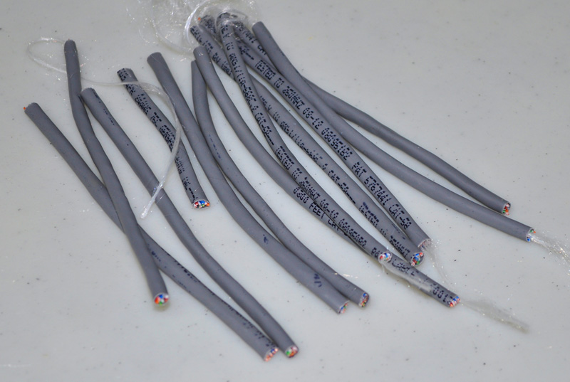

Wires are cut from the box of Cat-5 into the required lengths, remembering that there are 8 wires per cut.

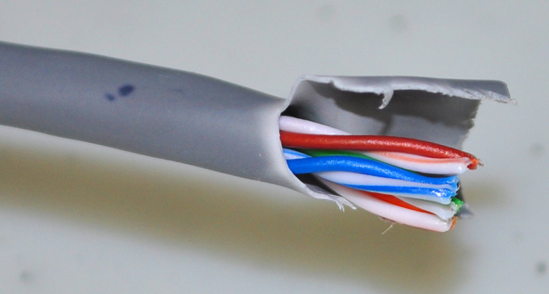

Trim the outside shield back about half an inch to pull the wires.
To extract the 4 twisted pairs, I cut back on the outer shield to about half an inch using side cutters.
Exposing the 8 wires. There are 4 twisted pairs.
You can then hold the end of the wire and pull the twisted pairs from the outer shield.
On a very long wire (over 12 inches), you may need to grasp the pairs with pliers when pulling them free.
The 4 twisted pairs pulled form the outer shield.
You now have 4 sets of twisted pairs, each color includes a white wire.

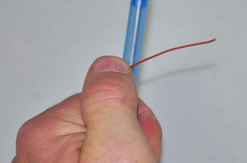

Drag the wire over a round surface to make it straight.
Ok, now you have a bunch of individual wires, but they are all wavy from being twisted together.
To make the wires straight again, drag them over a round surface like a pen, holding them tight as you pull.
This operation may take a few pulls, and if you bend the wire about 90 degrees around the pen, it helps.

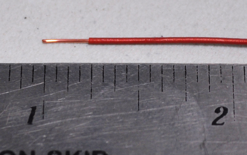

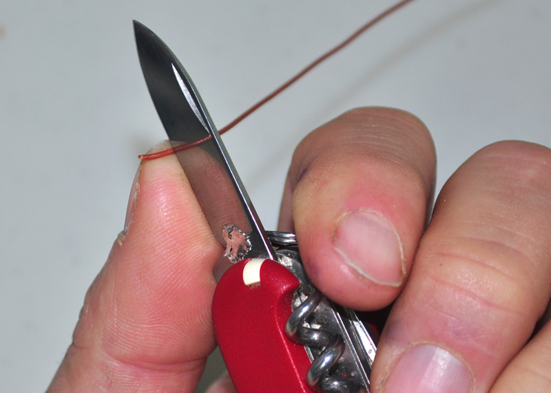

Exposing the bare copper for the breadboard.
To expose the bare copper wire for insertion into the breadboard, I just use a small pocket knife.
Roll the fire along the blade edge so that you are cutting about 1/4" of shielding away.
A knife that is somewhat dull is probably better until you get the finesse of not pushing too hard!
A quick roll of the wire to make a cut line will be enough to then pull the shield away with the blade edge.
After hundreds of feet of wire cut and stripped, I have yet to cut my thumb.
You could also try a wire stripping tool, but that would certainly take a lot more time.

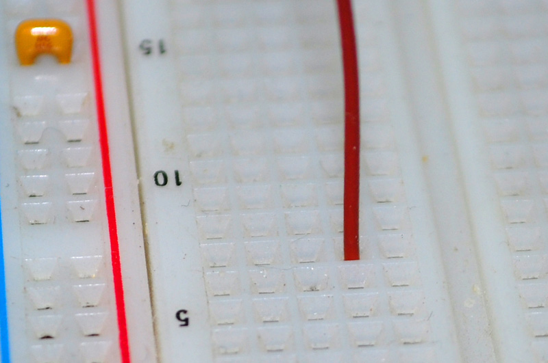

1/4" is the perfect length of bare wire for the breadboard.
Most breadboards are held to an aluminum backing plate with some double sided tape.
Some ultra cheapo boards may only have a sticker on the back and no grounding plane at all.
The 1/4" length of wire prevents "over reaching" beyond the wire clip and into the base of the board.
If you push the wire too far into the board, then you may actually poke through into the ground plane.
A wire too short will on the other hand, pop out of the board easily.
After stripping a few hundred ends, you get used to knowing what 1/4" looks like.
The perfect breadboard wire resting in its new home!

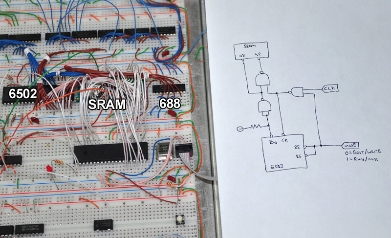

PostPosted: Sat Mar 12, 2016 12:34 am
Posts: 690
Ok, back to the grindstone!

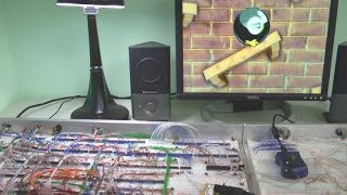

One of the issues with building a ROMless 6502 system is the requirement to share the Program Memory with both the 6502 as well as the mechanism that loads the memory. Reading the datasheet, it shows that BE will put the address bus, data bus, and RW line into the high impedance state, which makes things easier. The problem will be the clock signal, which will keep on truckin' regardless of what the 6502 is doing. This causes a problem due to the typical RW qualifying logic that syncs the 6502 read and write functions with the clock.
In order to get around this with the absolute minimum number of gates, I whipped this messy wire test up...
The clock is now "switchable", and when BE is low, RW is also pulled low (Boot Mode) by the pulldown resistor, and the 6502 is held in reset.
There is another NAND controlling the main Clock signal as well, which can be manually pulsed when in Boot Mode.
When BE is high (Run Mode), the 6502 is taken from reset, and all of the lines are back on the bus. The master clock is also reconnected.
If have tested this, and so far it seems to work fine.
I am using the AVR to load the SRAM.
As I continue to test the 6502, I will post details on my decode system, which now has 256 individual IO lines mapped to Address Location 512.
It feels good to put the 6502 back on the board!

PostPosted: Sat Mar 12, 2016 7:26 am
Posts: 8507
That's why RDY exists.
I seem to recall that the NMOS 6502 family can be damaged if the reset input is held low for too long.

Yes, WDC65C02. No halt and catch fire issues there!
Not sure how RDY would help me put my master clock into high impedance state though.
My Boot loader logic needs to take over the clock for control over the WE / OE lines on the SRAM.
In other words, the clock oscillator has to go invisible while the logic fills the Program Memory.
CLK is currently a 10MHz can oscillator. Some have an Enable pin, and I may try to exploit that as well.
What I have works, and has only the propagation of 2 NAND gates between 6502 and SRAM, so I am happy with it so far.
