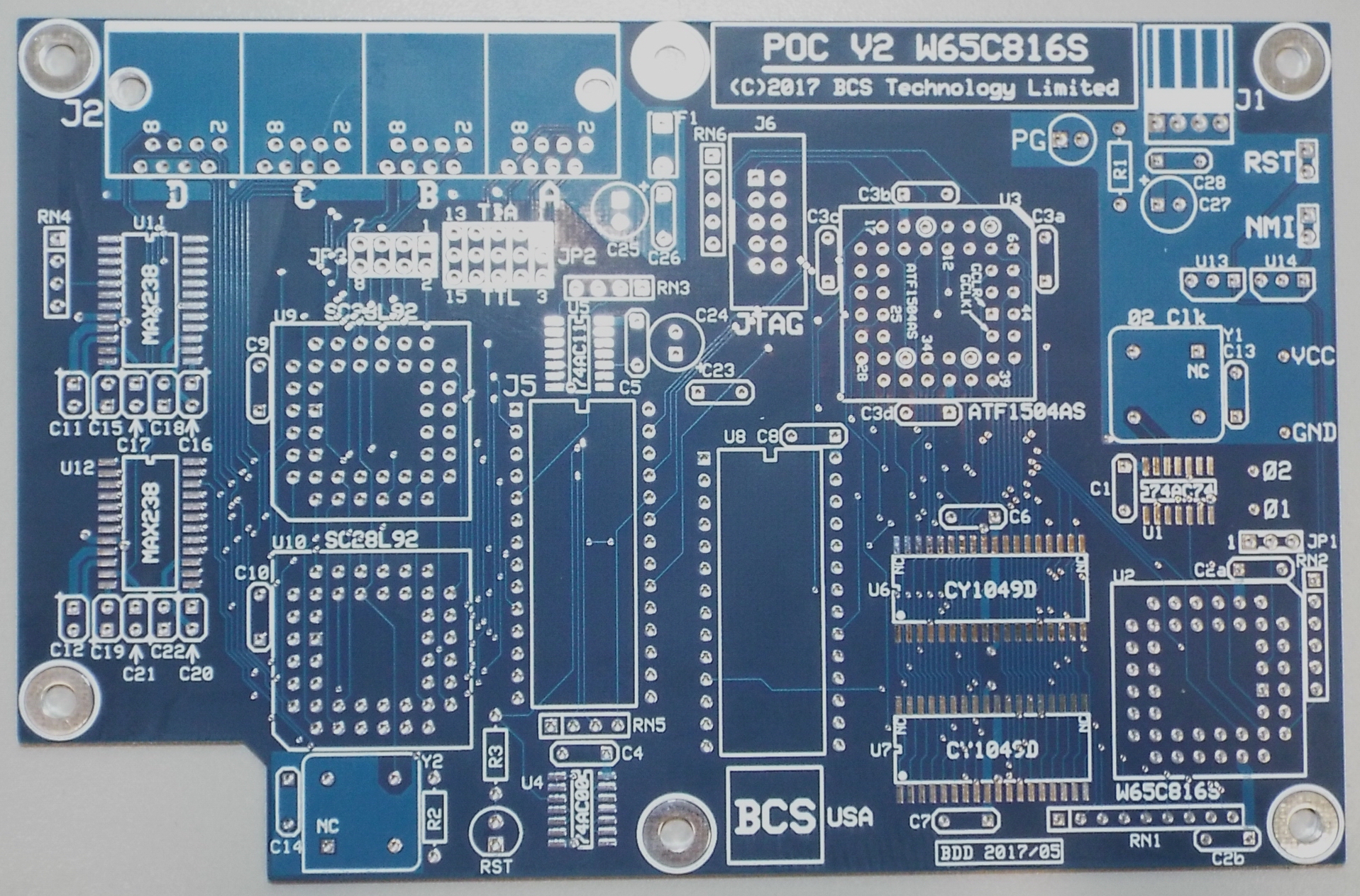

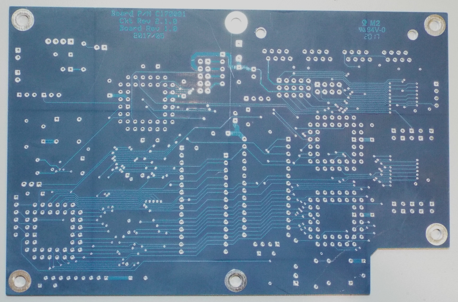

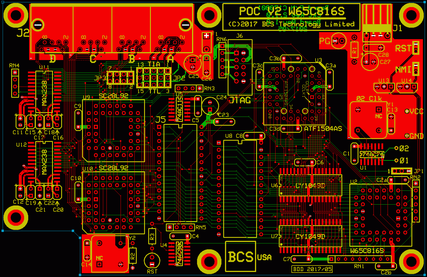

PostPosted: Mon May 08, 2017 2:17 am
Posts: 8389
As I earlier posted, I slept on the PCB design for revsion 1 and decided I could do a better job of compacting the layout...I may make some further changes to the board layout, but I think this is substantially like what it will be when it is built.
I made some minor detail changes to some trace routing and have called it a done deal. The files for the below layout will be sent to the board house tomorrow.
File comment: POC V2.1 "Production" PCB Layout
Pictures of POC V2.1's PCBs. Just for grins, I got these made with a matte blue finish. :D At least that's what the order says. I'm not sure what color they are.
File comment: POC V2.1 PCB Component Side
File comment: POC V2.1 PCB Solder Side
