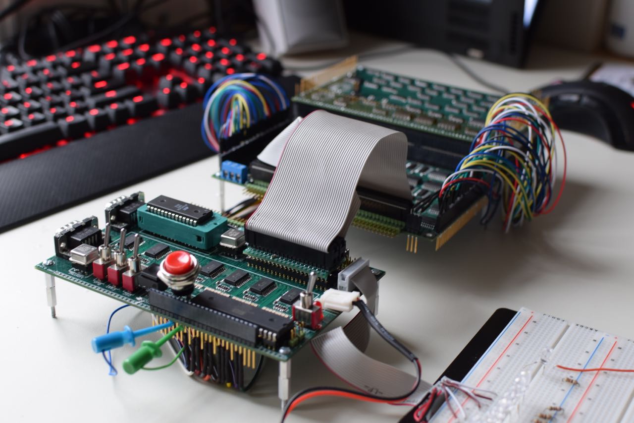

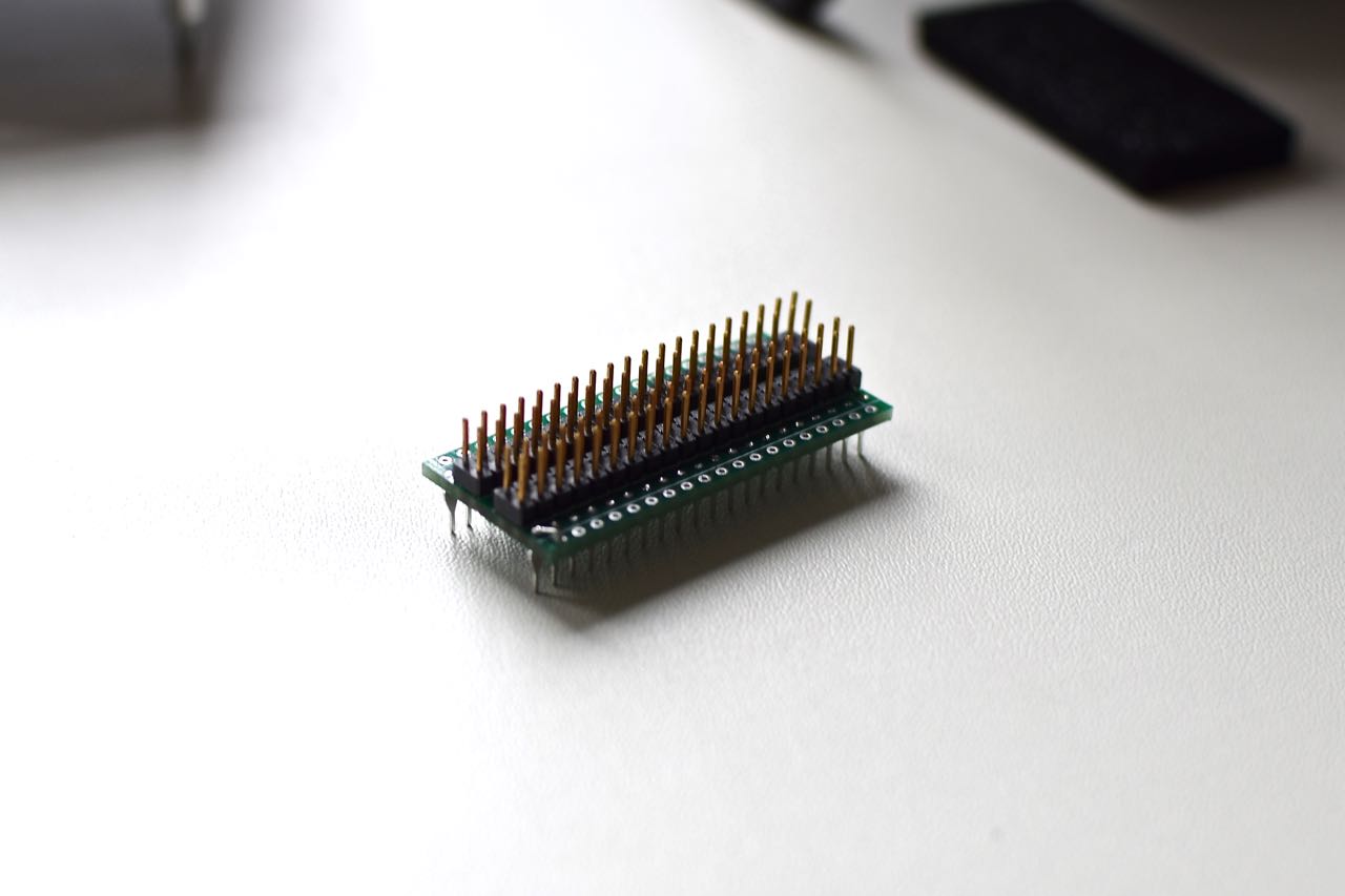

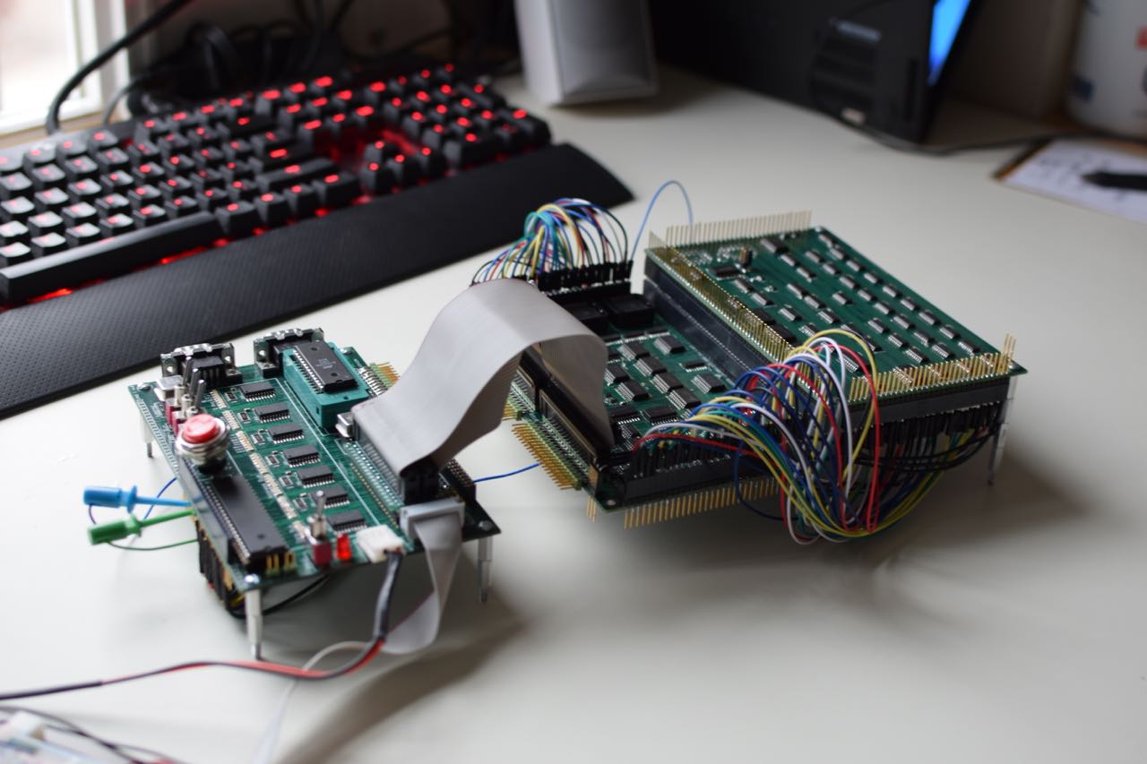

And now, time for a little fun: introducing the C74 Socket Adapter! ;)
  • A convenient way to connect the TTL CPU to any 6502-based computer
  • Configurable VDD and GND pins to support NMOS 6502, 6510 and CMOS 65C02 pinouts
  • Dual 40-pin headers provide ample grounding for high-frequency applications
  • Designed especially for the C74 project with guidance from dr Jefyll
Here is the little critter:
Sure makes the TTL CPU look like a proper insert-replacement on the SBC! :)
I also took the time finally to heed dr Jefyll advice and connect the CPU boards together in overlapped fashion. The inter-card connections along the middle of the assembly are now as short as possible but still allow access the boards for debugging. Below is a better look at the arrangement:
It turns out that making these changes, and replacing a flaky reset button, seem to have fixed the intermittent power-up and reset problems I was having. Ah, yes, construction issues bite again! (thank you Jeff!) :)
Ok, now on to the other bugs ... 8)

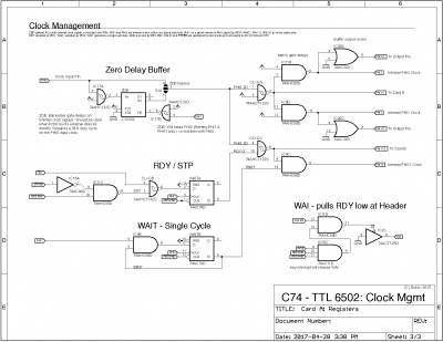

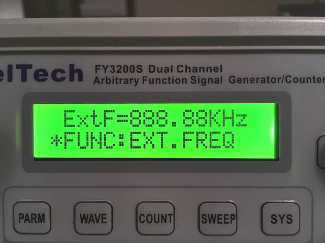

During last week's tests, the CPU ran reliably at 12MHz, but failed at 16MHz. Given that jumpers are still very much in use between the PCBs, it's easy to assume poor grounding is the culprit at the higher speed, or perhaps that 12MHz might be the ceiling on performance. I wanted to find out. But first I needed to deal with the fact that 16MHz was going to be impossible while running the code from ROM (at least until V2 of the SBC is built).
Easy enough. The CPU can copy the "blinky-light" loop to RAM using the SBC's half-speed SLOW clock before jumping to it. Then the 16MHz FAST clock can be manually engaged to run the remainder of test from RAM. I calculated bit 0 of the VIA Port would flicker at roughly 890KHz if things were working correctly (the blinky loop is just 9 cycles, so 18 cycles for a full "blink", at 16MHz / 18 = 888.88KHz blink-rate). But alas, the CPU only sputtered and locked-up when I ran the test -- no blinking at all. Ok, so something else was gumming up the works.
I then remembered that there are two gates in series on the CPU's internal clock pin, one implements RDY and the other the 2-cycle-BCD internal wait-state. That's all well and good, but two gates translates into a 10ns delay after the fall of PHI2 before the CPU can start to work! Including these two gates, the minimum half-cycle is a full 33ns, or a top speed of only 15MHz -- there's no way this was going to work under those circumstances!
Thankfully, the CPU includes a Zero Delay Buffer ("ZDB" - datasheet attached below) to deal with exactly this problem. The idea here, I learned from dr Jefyll, is to synchronize the internal clock after the gates with the input clock before the gates, such that the edges of the two signals are co-incident. The ZDB does just that by way of an additional brief delay it calculates automatically. Of course the downstream logic can't tell one cycle from the next, so the gate delays are eliminated altogether and the CPU responds 10ns more quickly than it otherwise would! (I know, magic right?). Here is the circuit in question:
Now the ZDB requires that the input clock-rate be no lower than 5MHz, so single-stepping the CPU for debugging is impossible when the ZDB is engaged. I had therefore placed it behind a solder-jumnper so it could be safely disabled until needed. And clearly, it was now very much needed! So, I soldered the jumper closed and hooked up my cheapy-ebay frequency counter to read bit 0 of the VIA port. I paused for a moment to look at the frequency readout before flipping to the FAST clock, and then:
Bang on, unbelievable! :shock:
The fan on the power-supply was churning away and the display showed 600mA at 5V. Man, oh man, that TTL CPU was hammering the VIA port at 16MHz!!! Amazing ... :)
