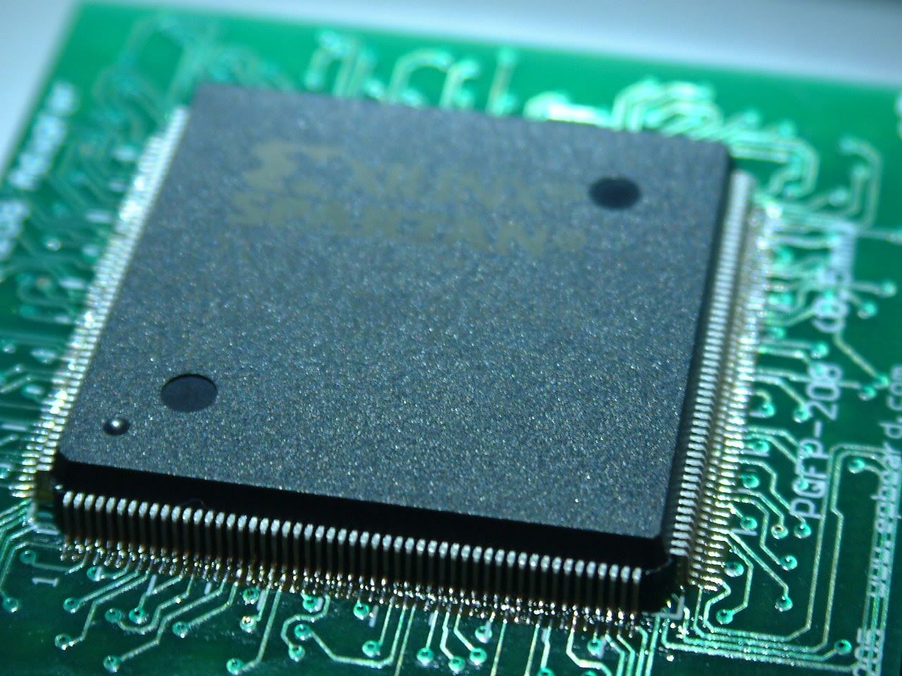

Daryl, the youtube video was very informative. I watched it a couple of times, and headed out this morning to get paste flux, and solder wick (braid as radio shack calls it). It was a sinch. Much, much easier than I thought. I didn't have to add solder, there was enough on the adapter. I had to use the wick once when the solder built up on the tip and bridged 2 pins. Took me less than 5 min's total. The hardest part is precisely lining up the pins, on all four sides, to the adapter.
I was intimidated because I had tried a couple weeks ago to solder a 44 pin QFP (no where near the fine pitch of this 208 pin QFP) without using flux, just rosin core solder, and it was bridging pins like mad, and looked sloppy. I was using a solder sucker to unbridge the solder. I went back over it today after adding some flux, and it cleaned it right up...
Owen, you said it, a liberal amount of flux is mandatory for success... I wish I could take better close up pictures.
Garth, I can't believe I was thinking about using a torch, (it was a small mini butane torch though, still...)
edit:
Thanks for the pointers all. (No pun intended with the last pic ;)
Smaller ones would help. :)
As for the slobbering job, it almost looks like it came from the factory.

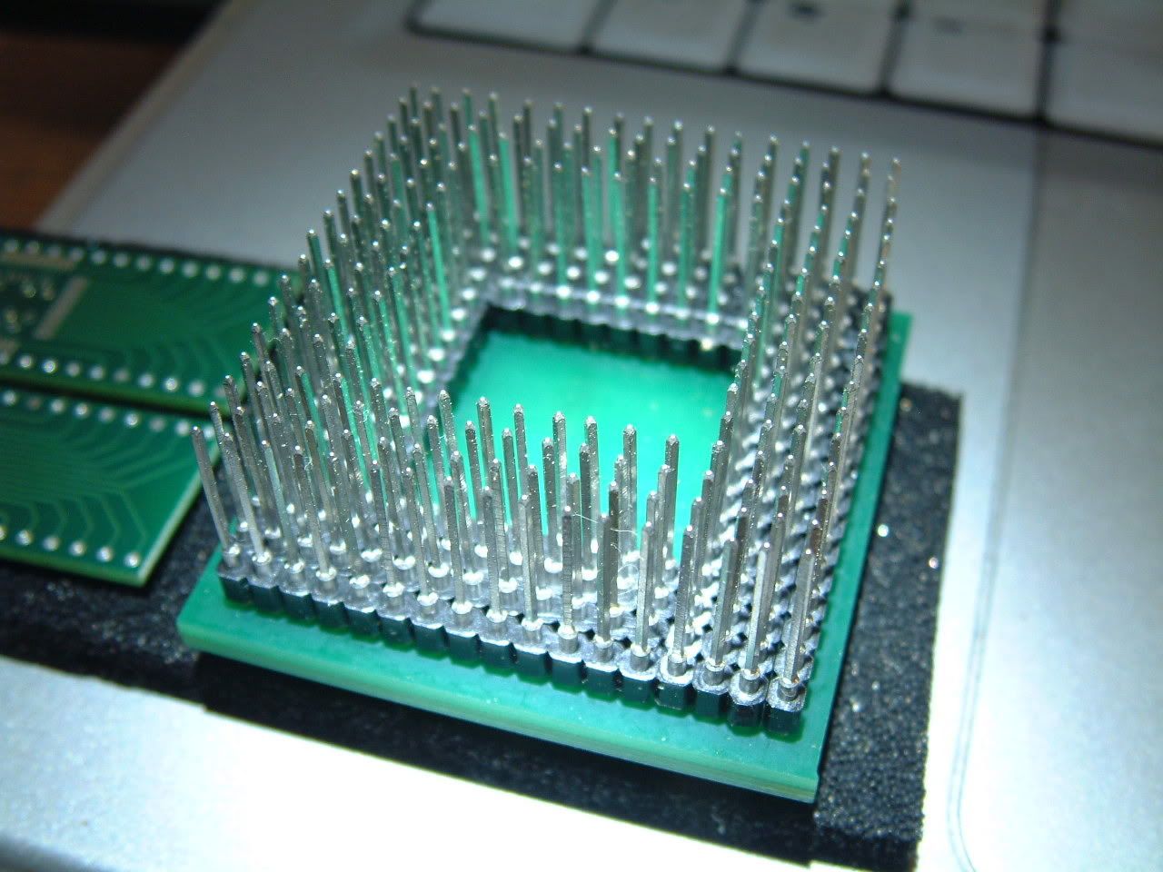

There's another company which deserves mention here. I forgot to do so in regards to my last pic, with the 208-pin QFP version of the Spartan 3...
My current project uses a Spartan 2 100-pin VQFP PGA adapter and also a 54-pin TSOP II PGA adapter, made by EPBoard, which you can see here: (1st and 3rd sockets down), viewtopic.php?t=1370&postdays=0&postorder=asc&start=172
They have excellent timely service, I usually receive the order 3-5 days after placing it online. Not sure about a minimum order, maybe $50US?
Don't confuse PGA with BGA. These are "through-hole" QFP adapters that can fit wire-wrap headers, check out the pre-mount 208-pin QFP pics: viewtopic.php?t=1492&start=32
Visit the site and check out the diag's:
http://epboard.com/eproducts/protoadapt ... PGAAdapter
