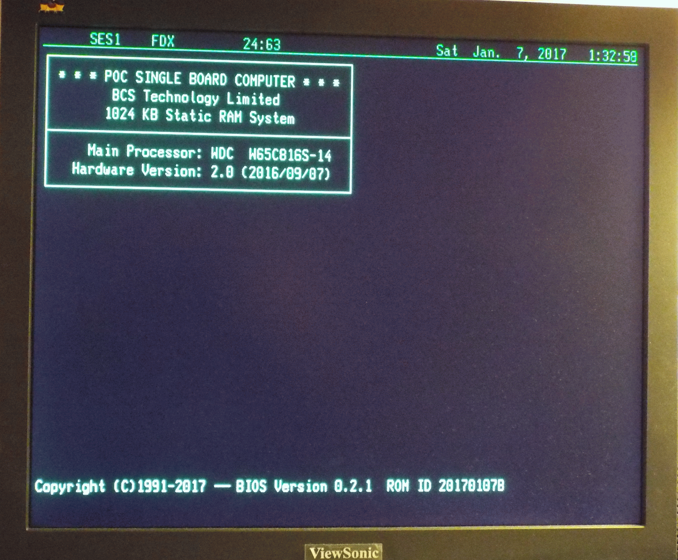

Hm, that's plausible, but not yet proven,so best to leave a little room for doubt. When I get stuck on a problem it's often because I was premature in zooming in on one particular theory.
The QUART's data sheet is not very well written and has at least one outright error in the hardware description, so a little bit of the problem is with documentation. There are some gaps in the discussion of how interrupt arbitration is set up and information related to reading the "current interrupt register," which identifies the source of the interrupt, is incorrectly described, that determined by patient experimenting. Succinctly stated, I'm finding that I cannot use the QUART in the type of interrupt handler that works with the DUART, despite the data sheet implying the 28C94 is functionally equivalent to a pair of 26C92 DUARTs (which is baloney, as some important setup functions were moved from one register to a different one. Hence I don't feel I have a thorough understanding of the QUART.
Aside from DUART vs QUART, what else differs between POC V1.1 and POC V2.0? Could there be a wiring problem with POC V2.0? I assume you've checked that you're able to access all the QUART registers at the expected addresses, and with the bits in the right place within the byte.
The key difference between the two machines is the use of a CPLD as glue logic in V2. Other than doing detailed timing analysis, I've verified that the logic works in-circuit exactly as designed and as simulated. I definitely have full RAM access, and the QUART gets a chip select when it should, responds to read and write operations, etc. I can drive the console display via polled I/O (pic attached) and, in fact, verified that I can also drive TIA-232 ports C and D (port B is wired for data transfers from on of my Linux boxes, so I can't yet test it). So I'm confident that there are no hardware anomalies, or at least no show-stoppers.
File comment: POC V2 Test Screen Using Polled Serial I/O
