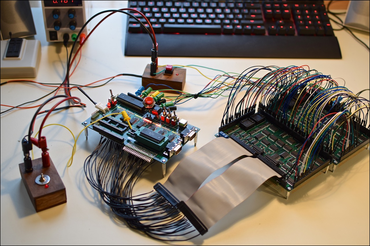

Can I presume your makeshift toggle-clock switch is debounced somehow? Just checking.
Yes, thanks for mentioning it. I'm using a spare NAND like this.
Also, is it the ribbon cables which carry +5 and ground to the CPU boards? Personally I don't trust jumpers for that. I usually take the time to establish soldered power connections, even if it's just a temporary test setting. This is in the "essential to sanity" category you mentioned.
Yes, it's the ribbons carrying power to the CPU, which is configured to receive "Host Power" through the CPU pins. Currently it's jumpers making the connection from the breadboard to the ribbons and then also between the CPU Cards. I agree that seems a little dodgy. The CPU will graduate to the test SBC shortly (I hope), and therefore to more robust power connections. I just might solder some wires directly to the boards as you suggest in the meantime.
Thanks for sharing the pics, and good luck with the debug!
Thanks Jeff! I'm really enjoying the process. :)

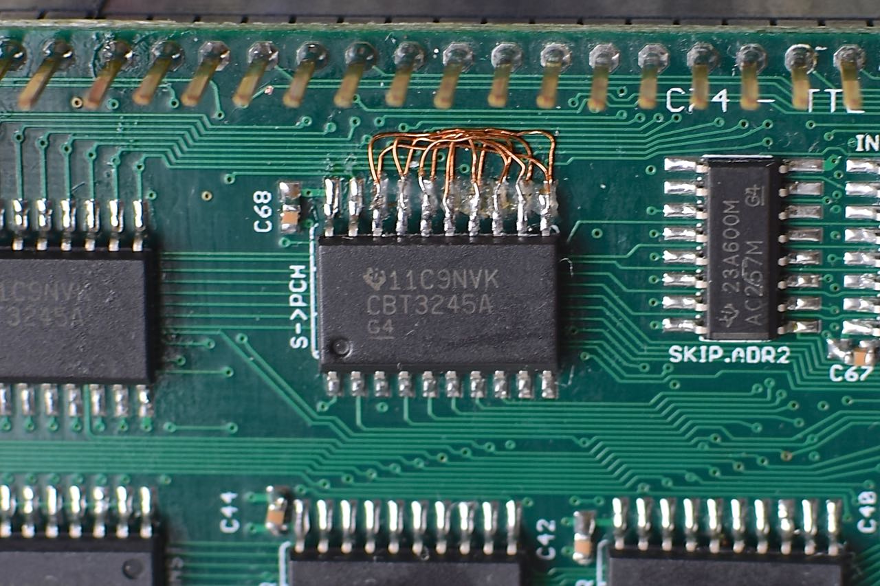

After all the checking and re-checking, it's hard to believe this got through the QA process: :roll:
S->PCH (a 74CBT3245 buffer) carries the result of the 16-bit Incrementer to the high-byte of the PC register, and all eight data lines were going to the wrong pins ... argh! This little mishap had the effect of inverting the bit-order of the high-byte of PC every cycle.
Good thing I picked up some practice patching the SBC. Here is what the afflicted area looked like after some head-scratching and careful rework:
The output pins of S->PCH are lifted off the board, jumpers are soldered to each and then run to the correct pads below the raised pins. I used some silicone to cover the pads after the jumpers were soldered on, and amazingly there were no shorts once the job was complete. The multimeter confirmed all the data line connections are now correct and sound.
With that fix in place, I'm thrilled to report that the CPU passed it's first significant test! It ran a complete reset sequence and then went on to execute NOPs in succession beginning at address $EAEA, two cycles per NOP. Wow, this means that the basic piping is working: reading the data bus, latching into IR, stepping through microcode, incrementing PC. Hurray! :D :D :D
Next step is to run systematically through microcode and exercise the circuitry. The microcode is composed of about 190 unique micro-instructions, with many being only slight variations of fundamental operations. It's worth spending a little time optimizing the testing to run through a minimum set of basic operations before moving on to full opcodes and test suites. Here's hoping the inevitable problems that arise may be patched rather than requiring new PCBs! Gonna be a lot of fun.
So? Just put a footnote in the datasheet. Any programmer who can't be bothered throwing together a software workaround for a minor glitch like this is obviously lazy or incompetent! :wink:
Seriously, nice work on the patch. Did you consider placing four jumpers on each side of that IC, instead of all eight on one side? It might've been slightly less crowded if the swaps of D0<->D7 and D2<->D5 were on one side and the swaps for D1<->D6 and D3<->D4 were on the other.
Hmm, nice idea ... might have been easier. Still, getting at the pads below alternate pins without touching their neighbours would also be tricky.

Then it was time to hook up the TTL CPU to the SBC. I used extra jumpers to tie the diagnostic LEDs on the SBC to the appropriate CPU-internal signals. This would display both the current opcode and current cycle being executed on the SBC - very handy for debugging. In the pic below, the CPU is retrieving the high-byte of the reset vector at $FFFD during cycle 5 of the reset sequence (Opcode = 0, Q Reg = 5, Databus = $C0 - the start of ROM on the SBC is at $C000). Note the empty IC socket bottom-left on the SBC - that’s where the WDC 65C02 would normally go!
My wife made the wonderful wooden switch-boxes shown; the toggle-switch on the left is a NAND-debounced step clock while the red push-button above the SBC is a convenient power switch for the whole setup. The on-board push-button for the step-clock on the SBC itself proved a bit dodgy, so it was necessary to pull the main-clock oscillator out entirely and wire-up the external manual clock to the oscillator IC socket (yellow-lead in the pic).
And with that done, things were ready to go. I sparked up the Kowalski assembler and coded up this little sequence:
