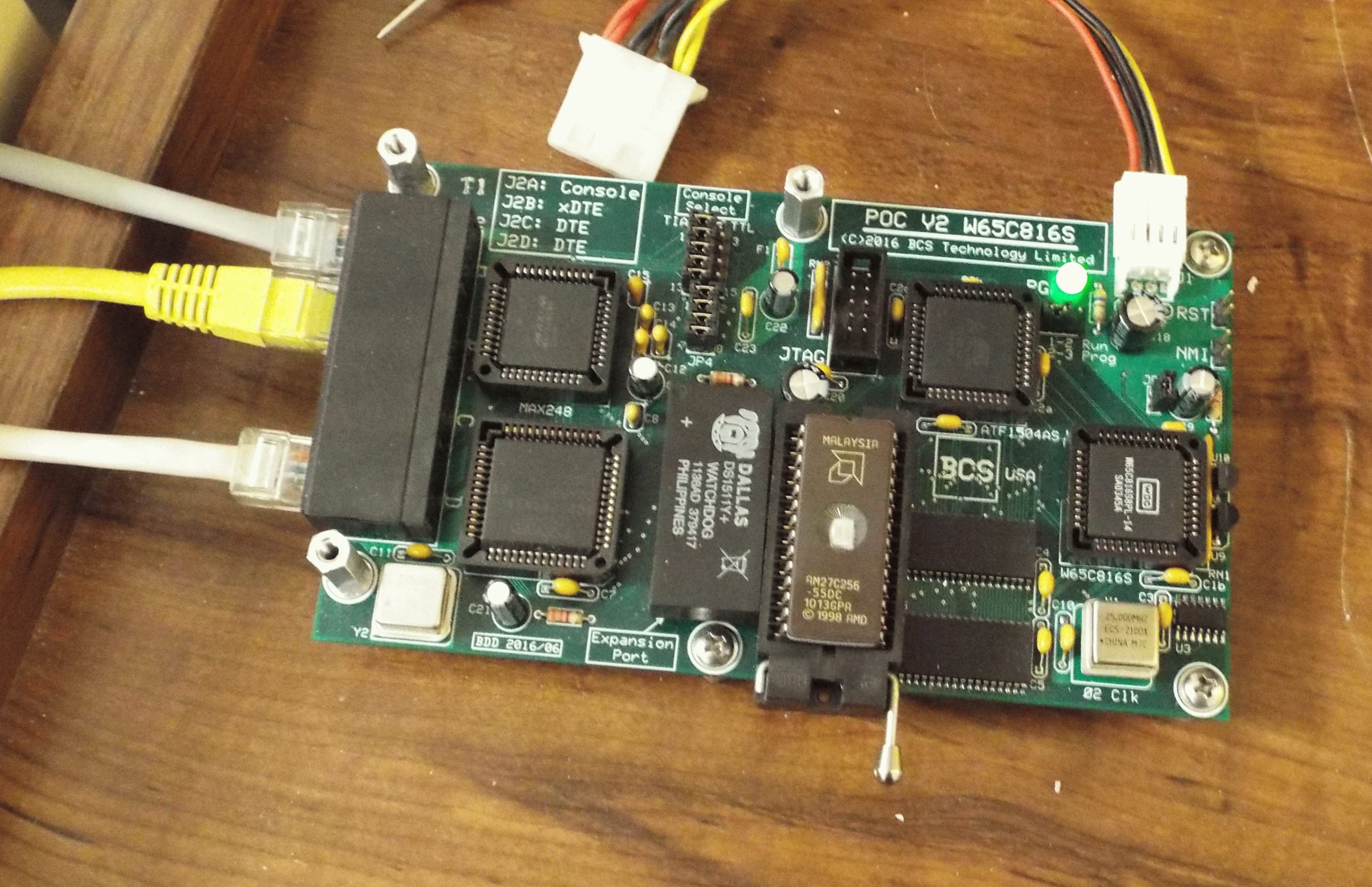

I think I've licked the problems with getting the QUART to do what it's told. Here are some pictures taken during testing to determine if I was on the right track.
File comment: POC V2 Undergoing Test
Above is POC V2 with power applied and connections to three of the four serial ports. Two of the connections go to two different terminals and the third one is a data link to my Linux software development box.
File comment: EPROM in ZIF Socket
Above is the test EPROM mounted in a ZIF socket. I should have done this on POC V1 but oh well! :D
File comment: POST Test Banner
Above is a test banner printed to one of the terminals. Obviously most, if not all, of POC V2's hardware must be working in order for this to have happened. One of these days I'll figure out how to get sharp photos of the display. Shame I don't have any hardware that can capture the image right off the VGA port and dump it into a file somewhere.

The banner display was generated by polling the QUART to determine when the channel transmitter could accept a datum. The next step will be to get all of that TIA-232 mish-mash working via interrupts.
