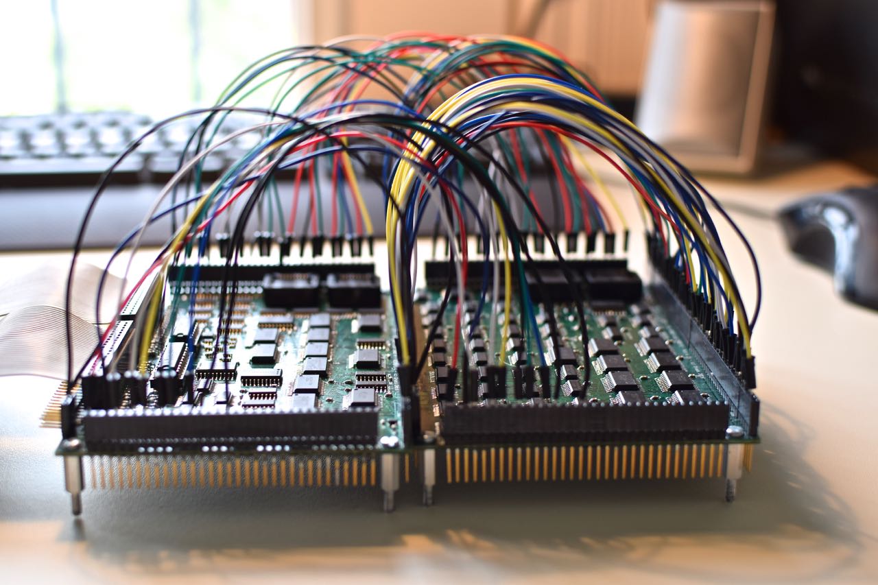

Troubleshooting a short - here’s my rookie method:
1/. Set power supply to limit current at 500mA, apply power to the board
2/. Feel for a hotspot - “ouch”, that's a problem!
3/. Patch it, rinse and repeat
I gotta believe there are more sophisticated techniques, but this is all I got. It's worked reasonably well for my most common blunder - upside down ICs. Thankfully, it's easy enough to spot and fix these issues.
But I also saw something more curious on Card A. Current would spike momentarily and the settle back down for a few seconds before spiking again. What? That's strange … maybe drivers fighting each other on a bus intermittently? Sure enough, I had left floating the signals which are used to select one of two drivers for the microcode control lines. These signals are generated in CARD B, which is not yet connected. Tying them down fixed the issue and current flow fell to appropriate levels. Nice!
As a side note, it’s interesting to see first hand how dramatic a driver conflict can be. Those are some nasty spikes! I recall working to implement a scheme dr Jefyll suggested to avoid collisions on the main buses. Seeing this sure makes me wish I had addressed the problem on the microcode drivers as well. Live and learn!
At this point Card A is well behaved, but not so Card B. The hunt continues! :)
(Edit: fixed the link to point to the right post)

The boards are behaving with a measure of civility now, and are no longer given to tantrums and spikes - a small victory, yes, but even small steps feel like milestones at this stage. Nothing melted, nothing exploded, and current consumption is mercifully stable - what a relief!
So, onto a setup for initial debugging of the logic:
Connecting the PCBs together with jumpers allows access to the underside of the boards. Flipping them over is hardly comfortable even with this arrangement, but at least touching a logic probe to an IC on the bottom layer without loosing state is actually possible - and pretty much essential to sanity.
The ribbon cables on the left carry the CPU signals out to a breadboard, where a makeshift toggle-clock and control panel now reside. On display currently is the address bus, while the data bus is set to $EA (ready for the inaugural NOP test). Moving the RESET line manually to GND and toggling the clock puts the device into reset. Thus far the reset sequence makes it only to the third cycle before failing; it’s a long way to go yet, but it’s something. Honestly, the first time I saw the internal state counter increment, I was thrilled. It was the first reliable and correct logic operation this unwieldy beast has ever performed, and I could hardly believe it! There is hope yet. :)
Here is a closer look at the inter-connected boards:
PostPosted: Fri Oct 27, 2017 11:33 pm
Lookin' good, Drass! :)
Can I presume your makeshift toggle-clock switch is debounced somehow? Just checking. Also, is it the ribbon cables which carry +5 and ground to the CPU boards? Personally I don't trust jumpers for that. I usually take the time to establish soldered power connections, even if it's just a temporary test setting. This is in the "essential to sanity" category you mentioned.
Thanks for sharing the pics, and good luck with the debug!
