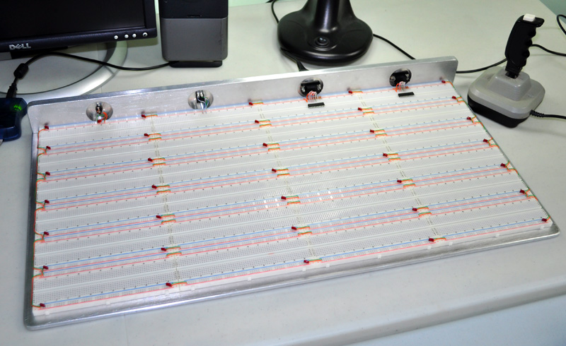

Phase Two of the Vulcan-74 Build has now commenced.
The second giant board will become the Four Voice Sound System.
VCC and GND connections have been completed.
It was a little boring cutting and stripping the 145 small GND and VCC wires, but the job is done.

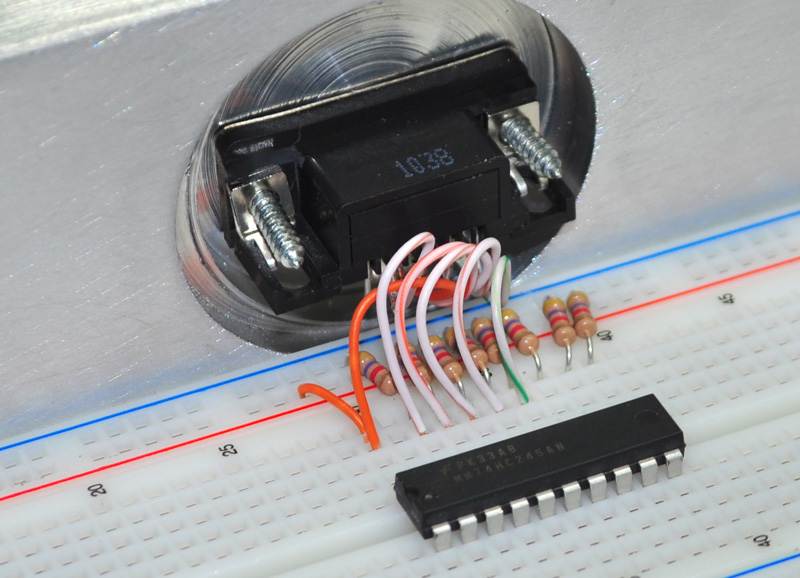

I also added a pair of 74HC245s to buffer and switch the Atari / C64 compatible Joysticks.
The Joysticks drive directly into the main Data Bus when the OE lines are pulled low.
I am only using 5 of the available 8 bits for Up, Down, Left, Right & Fire.
The 74HC245s buffer and switch the Joystick inputs.

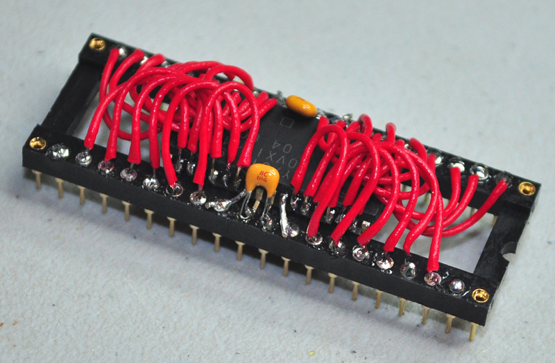

Next, I will solder up another set of 512K SRAMs for use as the Sound memory.
This will be done just like last time, as posted here...
http://forum.6502.org/viewtopic.php?f=4&t=3329&p=38423#p38423
10 Nanosecond 512K SRAM made breadboard compatible.

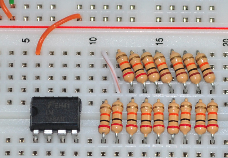

The 8 bit data from the SRAM is fed into an 8 bit R2R DAC, and then to an LM358 voltage follower as a buffer.
An 8 Bit R2R DAC feeds an LM358 Voltage Follower.
I will just connect my audio amp to the 358 for now, and work on the other analog parts later.

*Note*.. Yes, I fixed the DAC resistors! Didn't notice until I posted the nice bright photo!

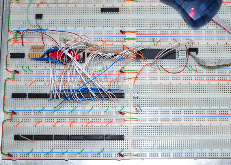

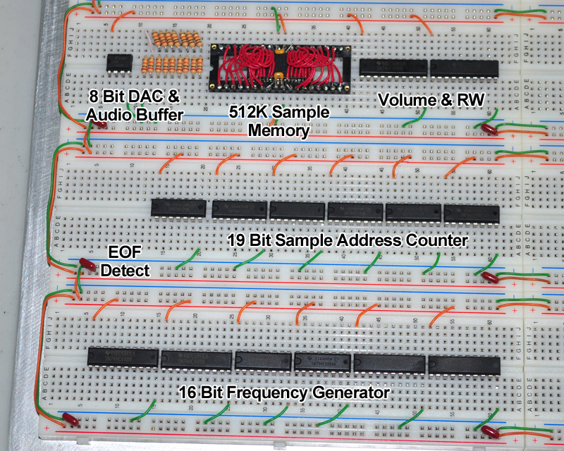

Had 2 hours this morning to work on the project, and made progress on the Frequency Generator.
Playback frequency can now be set by the external controller, and the end of sample detector is working.
The master Sound Clock is 20MHz, and playback can be set from 0 to 78 KHz, with 16 bit resolution.
How this works...
Dual 74HC590 counters are chained to create a 16 bit counter, which is clocked at 20MHz.
Dual 74HC688 comparators are set to reset the counter at some 16 bit value.
On a reset, the pulse is sent to a set of 5 x 74HC193 counters, setup as a 19 bit counter to the SRAM.
Sample position is set by loading the value into the 193 counters (3 bytes).
End of playback is detected by an output value of 255 from the SRAM into another 688.
The 688 triggers a 74HC74 flip flop to stop the counters.
Here is a quick demo of it working...

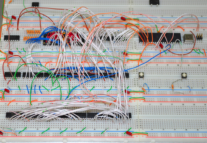

And some photos of the ever growing wiring mess that is soon due for a cleanup!...
Added Frequency Generator and Sample End Detector.
Although I can run the Sound Generator completely independent of the Video Generator, I like to look at something while I work.

This part didn't really involve any challenge, as it is nothing but a bunch of slow speed counters and a few logic gates.
The Analog Section will be a lot more fun, as it is much more of a dark art than digital logic!
I will be adding an 8 bit Digital to Analog Volume Control and an 8 Bit controllable Low Pass Filter next.
Both Analog systems will be made of LM358 Op Amps and some discrete components.
Once all of the sub-systems are working, I will build Voice #2 next to Voice#1, with an optimized component layout.
From there, all wiring will be cleanup up, and then the Voices #3 and #4 will be added.
Once all 4 Identical Voices are working, I will add the final dual 2:1 mixer to get Stereo output (Amiga Style).
