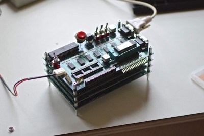

I couldn't resist stacking the new PCBs with the old SBC just to have a look. It may serve as much needed inspiration for the task ahead. I can already see it running ... :)

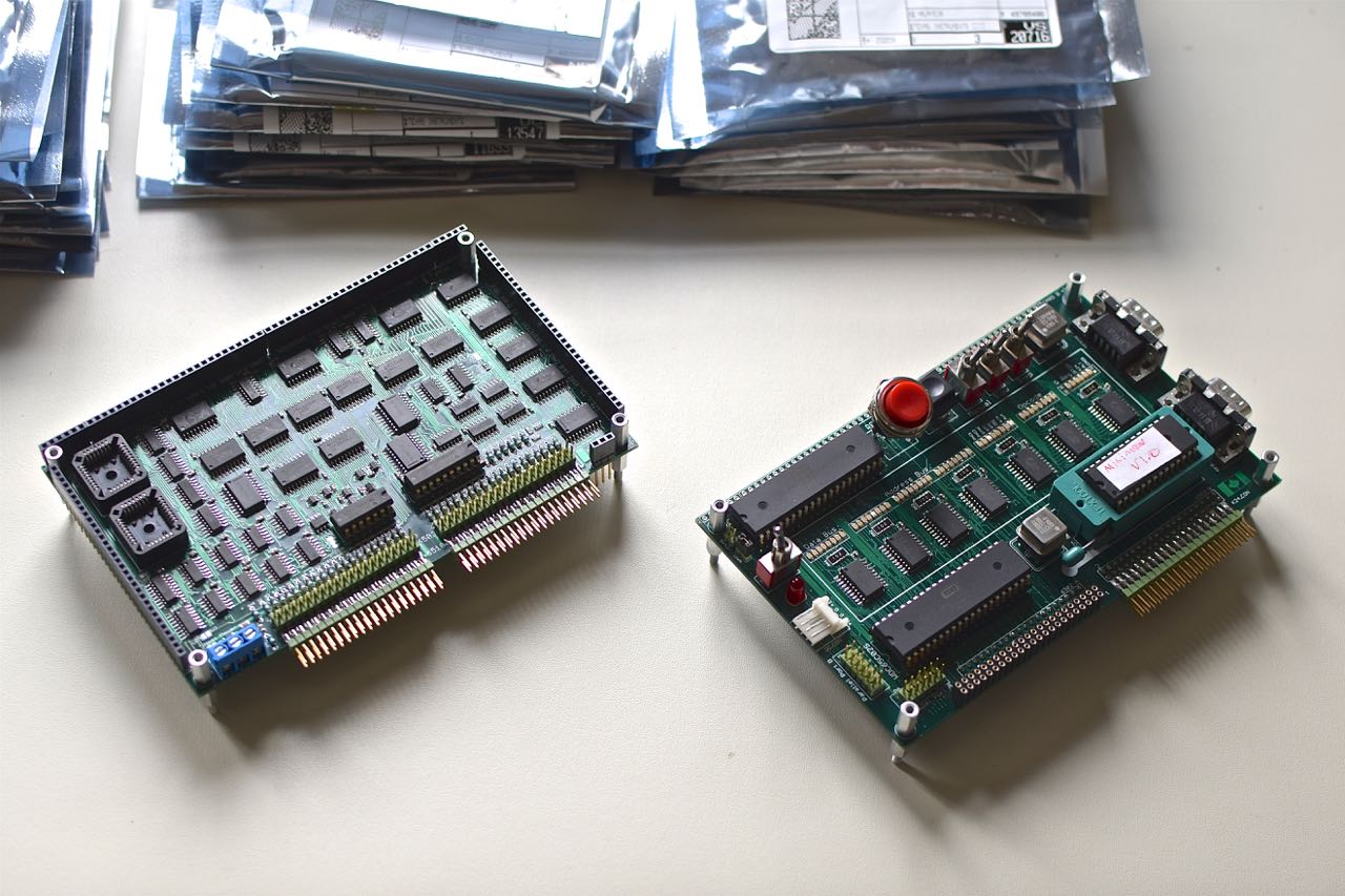

Card A and Card B now soldered, which together constitute a complete TTL 6502 (the third K24 card being optional). A real 6502 is shown below for scale :mrgreen:
Next step is to program the microcode ROMs and give the thing a try. This timing is rather auspicious as the first post on this thread was on Oct 19th, 2015. How great would it be to have the CPU come to life exactly two years later! Fingers crossed. (Btw, has it really been two years? Wow). Gotta say, I'm on pins and needles about it - it's worth remembering that these PCBs have nearly as many ICs on the underside as they do on the top layer. Sure hope I can get the thing to work after all that effort! As always, thanks for all the encouragement along the way. :)
Wow, really impressive-looking! Those boards remind of the stuff I worked on back in the 1970s. Gobs and gobs and gobs of chips, although they were all DIP, not SMD, and the boards were much larger. I couldn't imagine soldering that many SMD chips. :shock:
