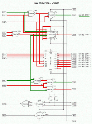

Something I had started doing a while ago was generating color-coded drawings of the logic circuits of my projects in an effort to catch design errors. So I did with POC V1.2.
V1.2's memory map is different than V1.0's and V1.1's. In the latter machines, RAM runs from $0000 to $CFFF (52KB), I/O from $D000-$DFFF (4KB) and ROM from $E000-$FFFF (8KB)—this is a "classic" 6502 memory map. As I added to the firmware in POC V1.1 it became clear that I was severely crowding that 8KB of ROM—the end of the firmware is at $FF50, which is only 144 bytes away from the start of the 65C816's hardware vectors at $FFE0.
The 27C256 ROM I use is a 32KB device, which means I have an unused 24KB. Mapping in another 4KB of ROM would give me the headroom I need for my planned firmware additions. With no need to maintain backward compatibility with V1.0 and V1.1, I decided to revamp the memory map, which is now RAM from $0000 to $BFFF (48KB), I/O from $C000 to $CFFF(4KB) and ROM from $D000 to $FFFF (12KB). Further to this, ROM will only appear on a read cycle—a write to the ROM's address range will go into the bit bucket.
After going through several iterations of glue logic, I came up with a circuit that meets my (unofficial) dictum that no more than two gates should be between the address bus and chip selects. With 74AC logic, this works out to an average of 14ns delay from address generation to chip select, more than enough timing headroom to support 14 MHz operation (although that technically isn't possible with the 55ns EPROM I am using). In order to prove on paper that the glue logic would work as required, I color-coded four possible machine states: RAM select with write¹, I/O select with write, ROM select with read and ROM select with write.
File comment: RAM Select at $BFxx, Write Cycle
File comment: I/O Select at $C000, Write Cycle

In the above illustrations, the net symbol VADR is the logical OR of the 65C816's VDA and VPA outputs, which means VADR goes high when the '816 is generating a valid address. All chip selects are qualified by this signal to avoid confusing devices with temporarily bogus addresses generated as the '816 sets up for the next operation.
The above glue logic is adaptable to the 65C02 with two changes: replacement of the 74ACT11030 AND gate with a 74AC20 and removal of the VADR logic, which has no analog in the 65C02. Note that the SRAM must be at least 48KB.
¹I belatedly noticed that I mixed up the color-coding for A14 and A15 in the RAM select illustration. So the actual address would be $7Fxx, not $BFxx. Either way, the logic does work on paper.
