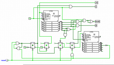

Modified to use '74 style flip flops with negative going clear and set; one replaced with a couple of spare NAND gates.
Reset now is normally high, low to reset.

So, here's a first attempt at turning the Logisim design into an actual 74hc circuit. It lacks things like a clock, reset circuitry, decoupling caps, and, er, the processor part (though the processor bits of my 8153 design should do).
It requires a depressing number of parts - eleven chips and a couple of dozen resistors - and it's going to take up a lot of PCB real estate, but still, it should load the bottom half of a 64kB flash/eeprom into ram from 0xc000 to 0xffff, and the flash/eeprom should easily be programmed in situ (it will probably require a hardware switch to stop the clock).
serial eeprom.pdf [376.2 KiB]
Downloaded 34 times
Not sure if I'm going to build this one in the immediate future; I'd like to sort out the STM design next. But I might knock up a limited version on proto strip to prove the timing.
edit: ack, just realised the ~wp and ~hold pins on the flash are pulled the wrong way. I'll correct that at stage :mrgreen:
