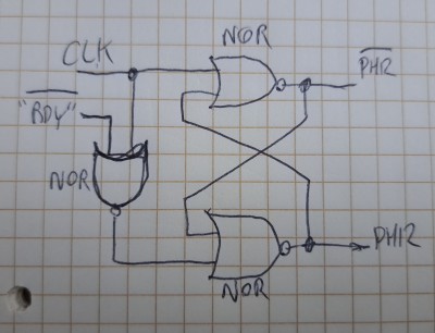

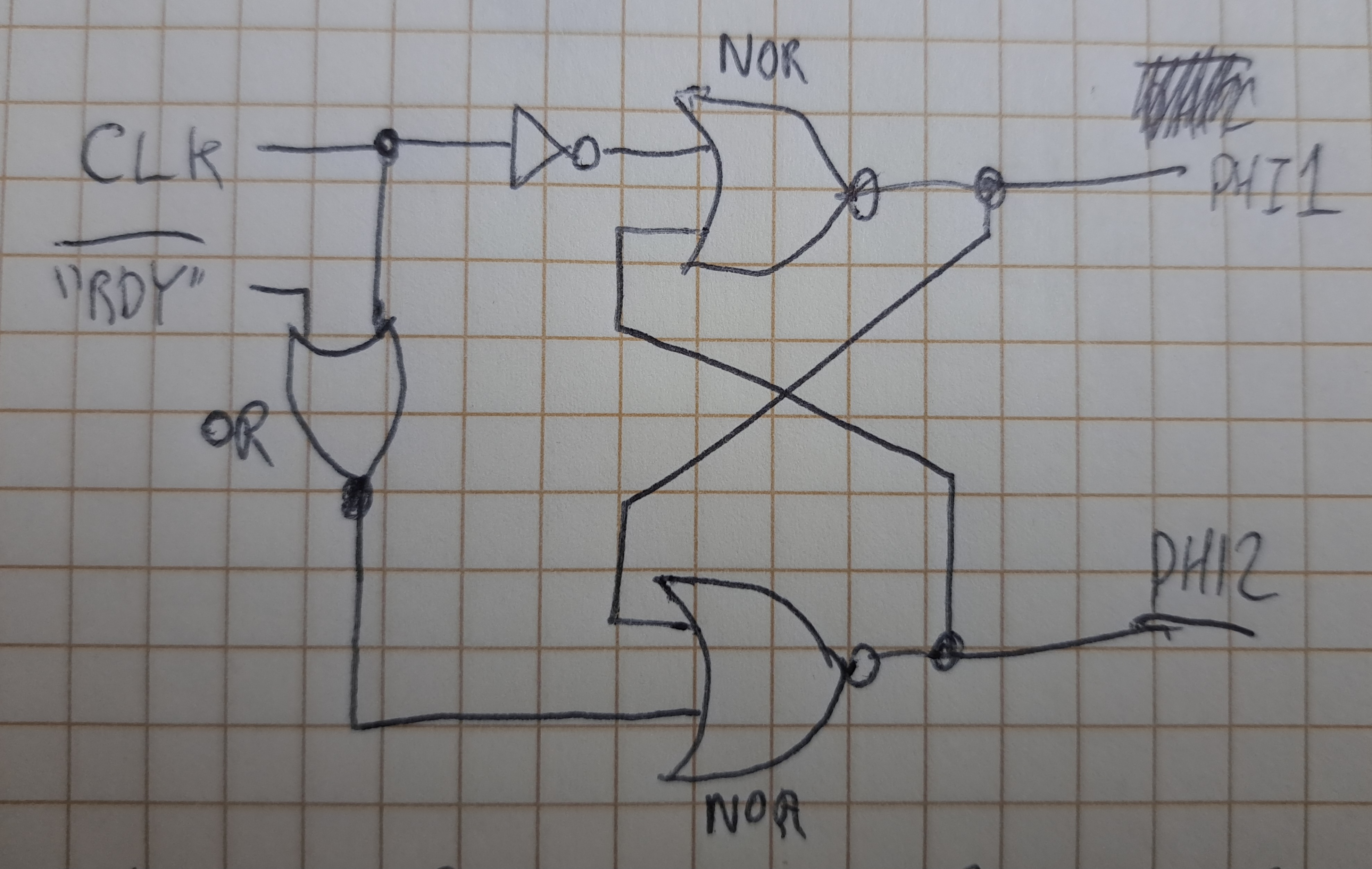

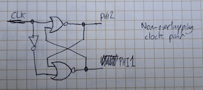

I just turned the computer off and then had another thought - is some variation of the standard two-phase non-overlapping clock circuit useful here?
File comment: Standard circuit
Some examples of letting a RDY-like signal stop the clock:
File comment: RDY via OR gate forces phase 1 immediately

File comment: Similar effect but only using NOR gates

I've looked into the NOR circuit in more details, and built a timing diagram for it. Considering the use of an AHC02 and our pseudo-RDY changing during the low phase of the input clock, we get this:

It looks like it works well for stretching. Timing is a bit tricky because if it happens to go low when the source clock is already low, a partial PHI2 low is generated (see fourth cycle above).
So, it needs to only change during the high phase of the source clock. Presumably up to right before the edge. I'm not sure if two logic inputs could have different propagations, ie should RDY be setup some nanoseconds before CLK or is 0ns acceptable :?:
Assuming 0ns is, this is what it looks like from the point of view of Q/PHI2

So it would need to be stable from 17ns before the falling edge of PHI2, until 2ns before the rising edge of PHI2.
Note that this assumes a very worst case of everything taking either the maximum time to propagate, or the minimum, depending on which edge we're at. In the real world there wouldn't be these massive swings on two consecutive edges for the same IC... But the result is still the same, it needs to be stable a bit before and during PHI2 low.
Ah yes, it is not as effective as I thought - I think it handles one transition direction well but not the other.
I have experienced problems due to this in a video circuit where I was ORing together two adjacent counter outputs, and when they changed together in opposite directions (quite common of course for a counter!) it caused small dips in the OR gate output, randomly updating some dependent things that were edge-triggered.
Since then I've been more careful to not rely on that - I use a flipflop after the OR gate, or similar methods, to only sample the state of the OR at a time when its inputs aren't in flux, or create overlap between the signals that I'm ORing. I'm probably overcautious about this now.

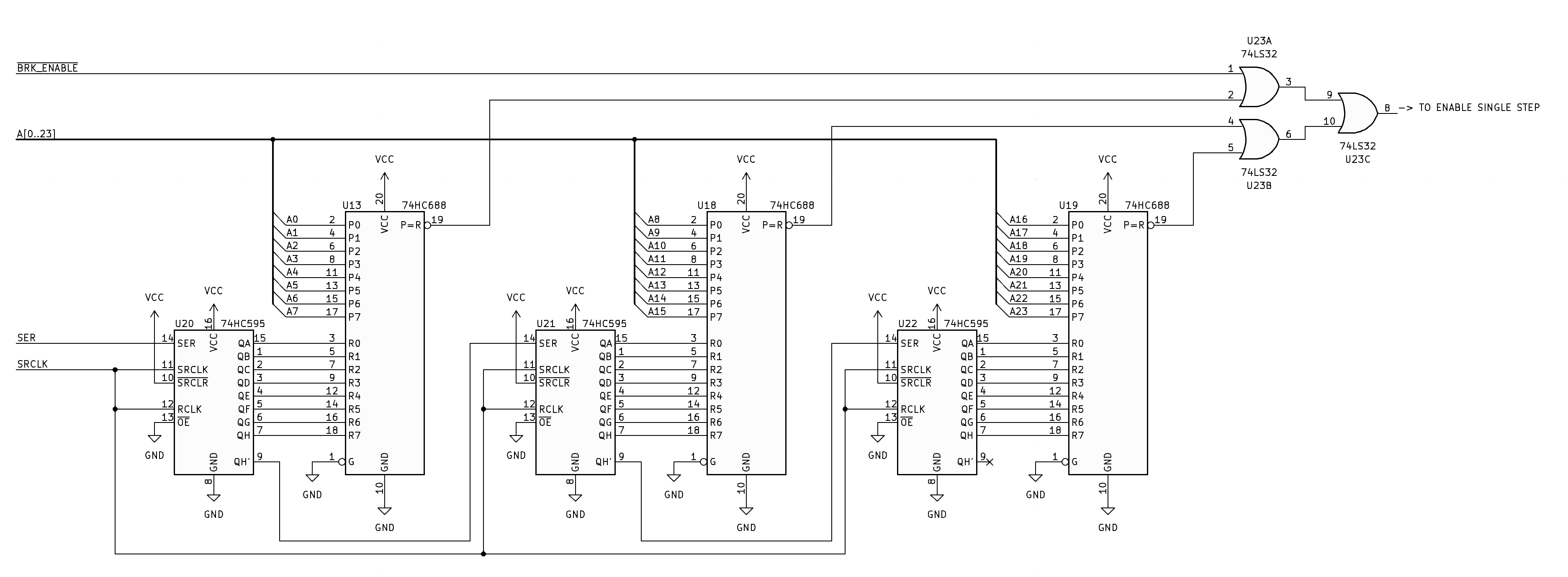

I've mentioned earlier my idea to trigger this single-stepping circuit using a hardware breakpoint. The idea behind it is to be able to run the computer at full speed, without the impediment of synchronous tracing, while still being very precise in where to pause the execution.
Using a trio of 74HC688 comparators and 74HC595 shift registers (can be reduced to duos for the 6502), and a bit of logic, it is possible for an external system to set and activate a breakpoint triggered at a specific address.
Here is what that could look like:
During normal execution, /BRK_ENABLE is kept high. When a breakpoint is set, the external system sends it over serial, then it brings /BRK_ENABLE low to enable detection. If the three comparators agree, and breakpoints are enabled, the single stepping circuit is activated.
The '688 propagates in 37ns, and each '32 in 8.5ns, totaling 54ns. With the bank address latch delay, this could be ready around maybe 100ns after the falling edge of the clock. So, unfortunately due to the comparators only existing in the HC family it is not as fast as I would like. A CPLD implementation would be doable quite easily in a small ATF1502 though, or integrated in a larger logic design. Assuming the CPLD already needs the address pins for address decoding, it would only add around 24 flip flops plus 3 control input pins.
BB816 Computer YouTube series
PostPosted: Sat Aug 05, 2023 10:36 pm
Posts: 741
CPLD is probably the tidiest solution but you could also use loads of fast XOR gates. XOR is a relatively complex gate but the propagation delay for AHC series is under 10ns. I guess you then need to OR the outputs together - I don't think wide OR/NOR gates are readily available, but you can invert your compare value so that the required operation is an AND, and you can get fast 8-input NAND gates (74AHC30) which are also under 10ns propagation delay. So all together you'd need 16 XOR gates, two 8-input NAND gates, and a 2-input OR gate like 74AHC32, probably 25-30ns worst case propagation delay I think.
