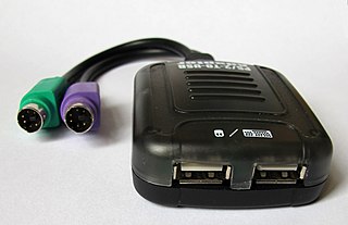

PostPosted: Tue May 09, 2023 7:03 am
Posts: 730
Location: Tokyo, Japan
I looked into what was necessary to add a USB keyboard and mouse to a project. Wouldn't it be handy if there were a single connector, protocol, and operating speed?
There is; it's called PS/2. :-P (Though apparently it wasn't so handy, because almost everybody switched to USB. Perhaps "I want to wire up a keyboard on an SBC I built myself using an ancient CPU" isn't the biggest use case here.)
To further complicate, if you want to use a wireless keyboard or mouse (assuming it has a USB dongle, and not a proprietary Bluetooth or similar mechanism) then one option for the dongle is that it contains a hub presenting two devices. Which means you're looking at not one, not two, but three protocols which need managing...
Actually, even USB keyboards may present as a hub with the keyboard behind it. If your keyboard has additional USB ports (so you can plug your mouse into the keyboard, rather than the computer) or has a built-in pointing device it must present as a hub.
BTW, Bluetooth keyboards and mice don't (usually) use a proprietary protocol; they run standard USB HID over standard Bluetooth.
I have been searching for what seems to me to be an obvious solution: something which has a UART (or two) on one side and is capable of talking to *at least* USB1 and USB1.1 HID devices and hubs. I have not found one.
Yeah, you can get close with one of these:
320px-Active_USB_to_PS2_Adatper_(keyboard+mouse).jpg [ 12.76 KiB | Viewed 913 times ]
They used to be moderately common, but seem to have vanished now.
Looking into processors which provide USB facilities I find lots of examples of how to use them to *be* a keyboard or a mouse, but very little on how to make an OTG general USB port using them, even from the manufacturers.
It doesn't seem to be that hard to find this stuff; a quick look around turned up ST's STM32 USB library (which does include host support for hubs and various devices, including CDC and HID), and this USB keyboard to PS/2 port converter project that appears to use it.
I am sure they exist somewhere and you can add one to the user extension area of the protoboard to your liking!
yeah the whole system is basically going to be that size, I dont need a USB KB and Mouse on this build, though you can add one through the user extension area of the board if you want! :)
