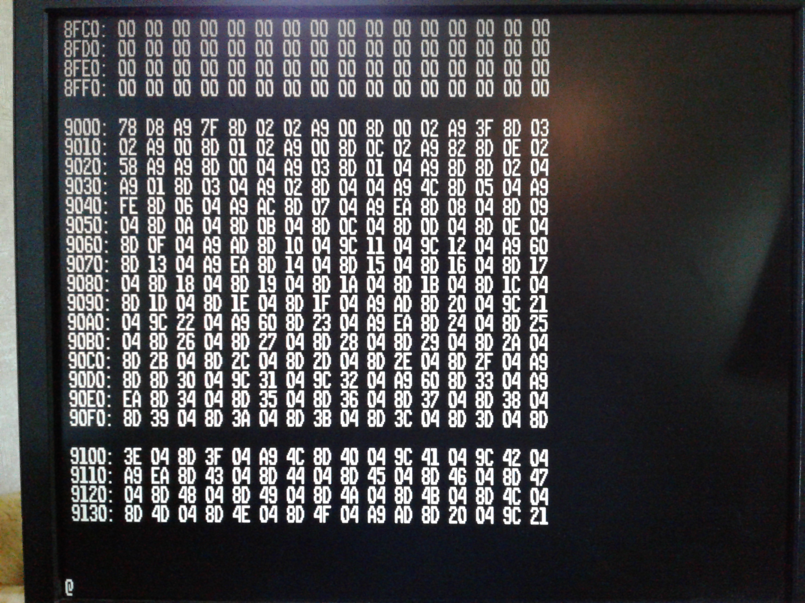

How it functions and looks is up to you, of course, but I’d keep the two separate, such as these screen captures from Supermon 816.
Also, the monitor commands you've listed in the help screen can all be single characters, such as A to assemble, M to dump memory, etc. When one is debugging, the less typing required to do something, the better.
Maybe I am doing too much. It's true, I say "Ah I have the space on the screen!" without considering the user friendliness side. Hm...
As for the single letters, yes I agree, but here I am trying to make it fancy. A whole FOUR letters, wow, big time. This board is not for pro's, by any means, so I'm trying to make it friendly. And whole words are friendly. But screen clutter is not necessarily friendly.
I'll be pondering on this BDD, thank you. Good analysis.

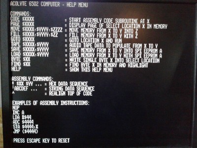

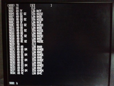

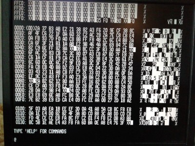

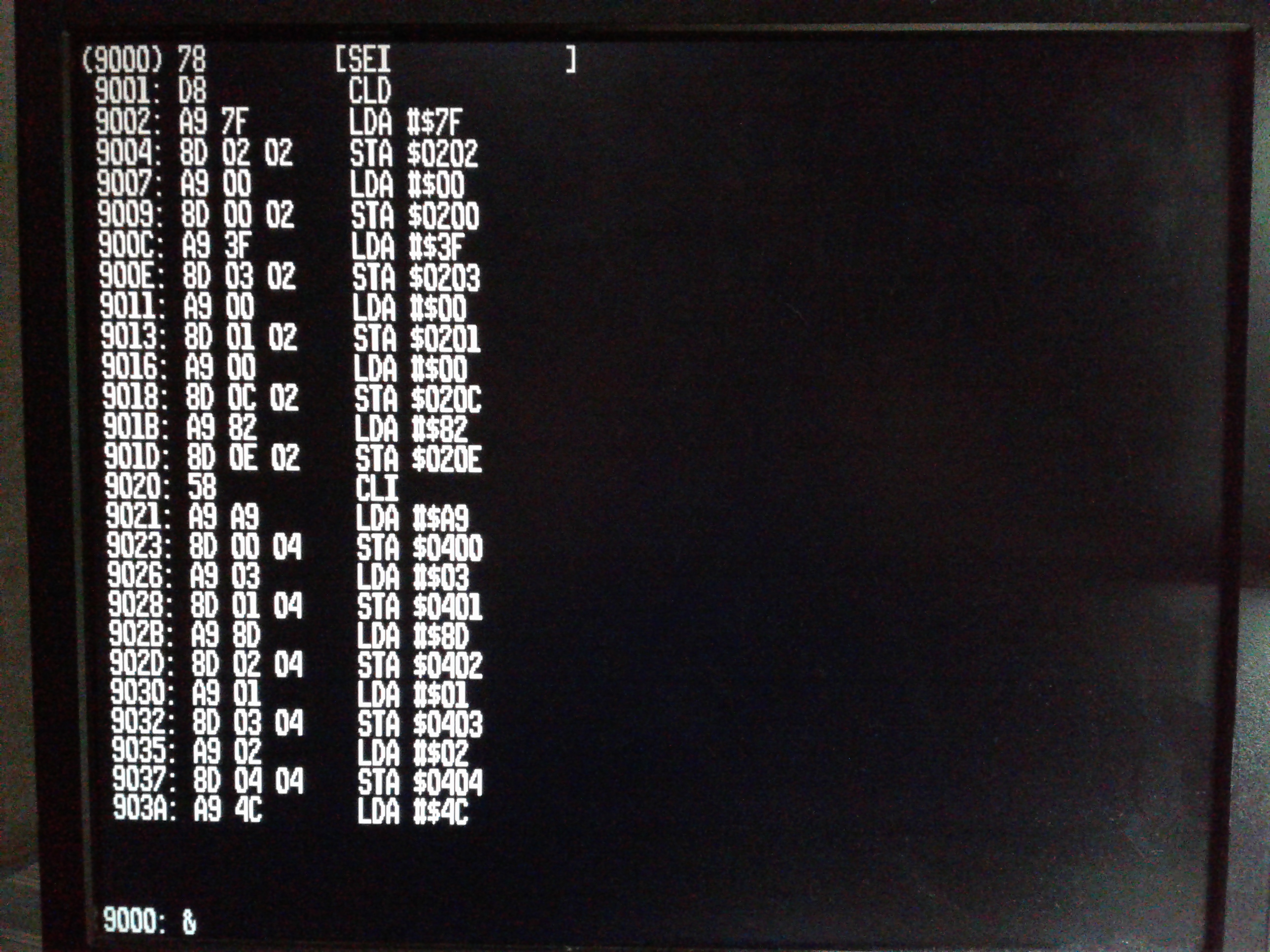

Attached is some pictures of what I did to modify it to what BDD was talking about. I like it! But I am now being tempted to fill up that right side of the screen again!!!
Chad
Ah, yes. Much more readable. For a little coding exercise, you could add to the memory dump to also display the bytes as ASCII characters, as well as hex. I've found that useful many times during debugging sessions. You can see that in the Supermon 816 memory dump.
You need to resist that temptation to fill the screen with “stuff.” The more you put there, especially if unrelated, the more likely you will misinterpret something at some point and drive yourself nuts. A machine language monitor is, by nature, a very low-level look into what the computer is doing. If you have to get into the M/L monitor to debug a program (I've often referred to that as “running down into the basement to check the furnace”), you will want to limit the volume of information on the screen to whatever it is relevant to the task on which you are working.

PostPosted: Sat May 07, 2022 11:44 am
Posts: 718
You mean like this? :)

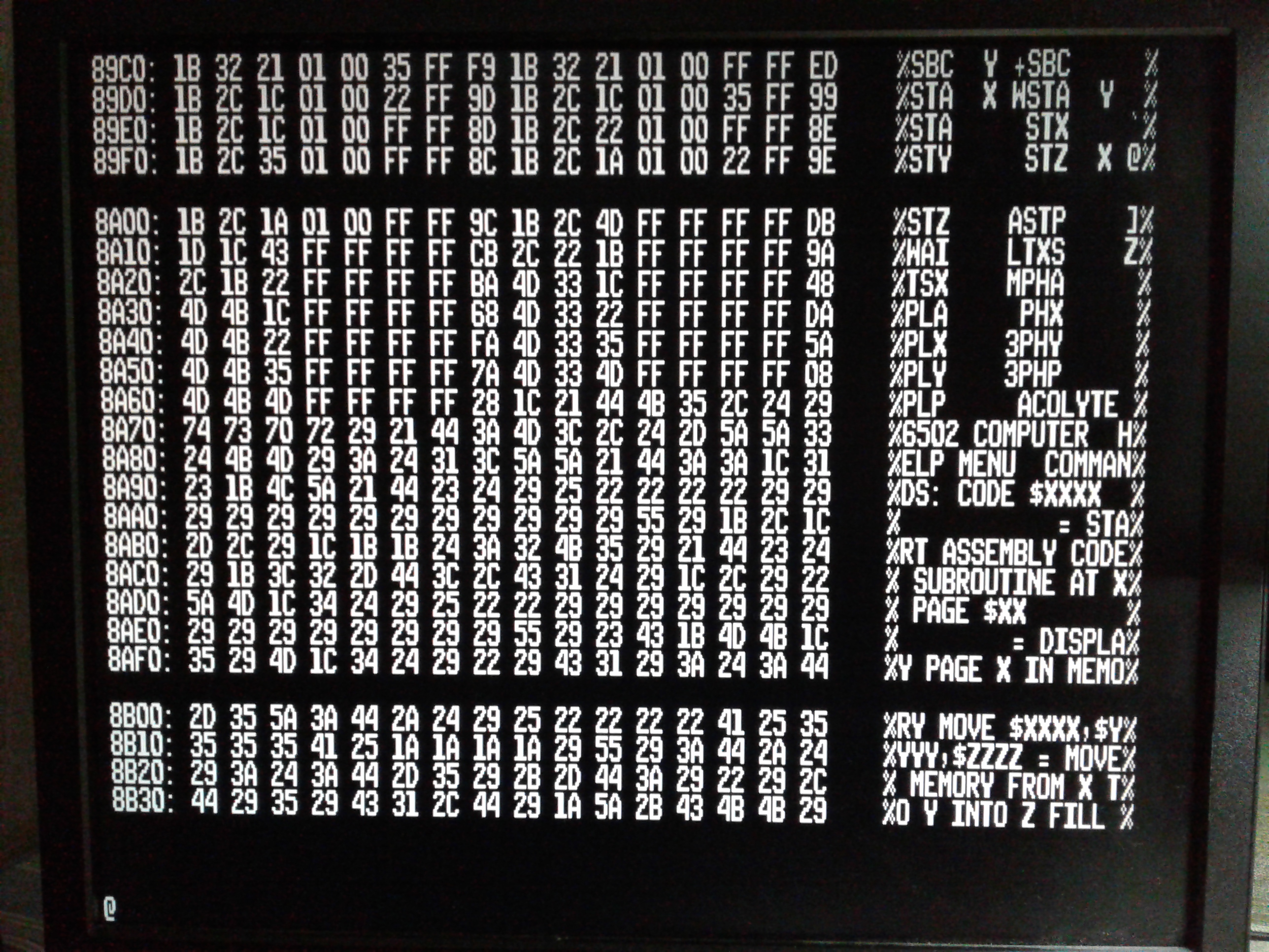

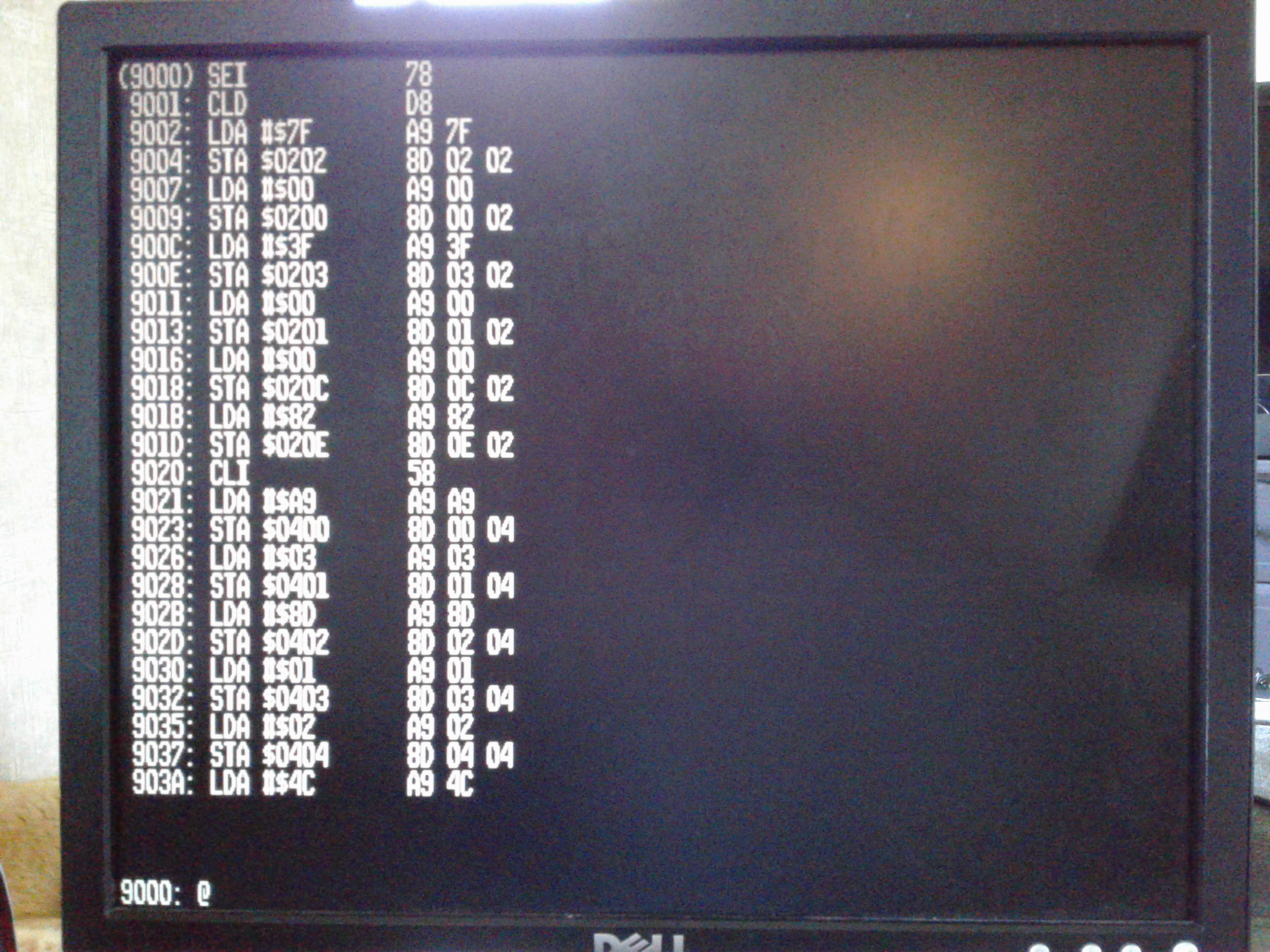

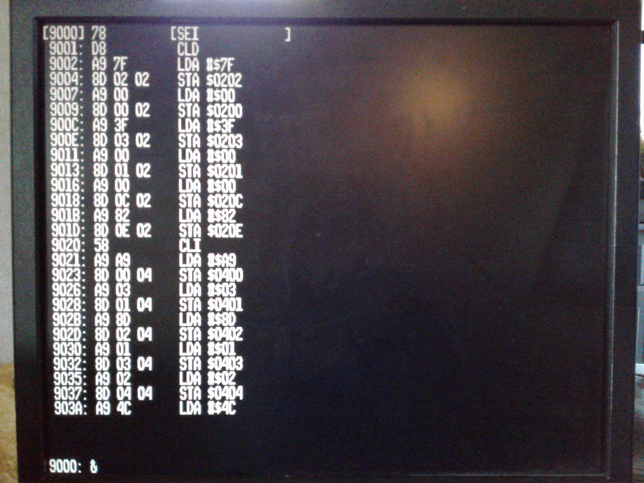

So, attached are some new pictures. Implemented BDD's suggestion for the 'ascii' characters. Thing is, if you look close enough, they aren't ascii. They are PS/2 keyboard values. I have been rollin' without ascii this entire time, and so far it's ok. It's heck to do things in a normal assembler, but that's ok because I use C to convert everything back and forth anyways. This particular screenshot is where my assembly lookup table touches the help menu text.
I also switched the bytes and Assembly code, looks closer to BDD's examples, and then added another 'cursor' to help visually.
Lastly, I added a 'string' sequence in the Assembler. It is crude, because you cannot use the literal anywhere you want. Once you use it, it goes into a 'string mode' and that's it, no extra functions. So things like:
LDA #'Q
will not print:
LDA #$15
but will print:
$15
only.
But it's at least a step in the right direction.
Thanks for the suggestions, this is exactly what I needed, and still need more of :)
Chad
EDIT: Just re-added the memory 'cursor' code, using arrow keys to move it around. The new function BYTE $XX changes the byte at that location (does not increment). I also defaulted older functions to use the cursor location if no other parameters are specified. Attaching the code, again read at your own risk (dying kittens and all that).
EDIT2: Just added the FIND $XX command, which highlights (inverts) one particular byte value in the memory dump. I'm nearly approaching "done" status here. I probably aught to comment now.

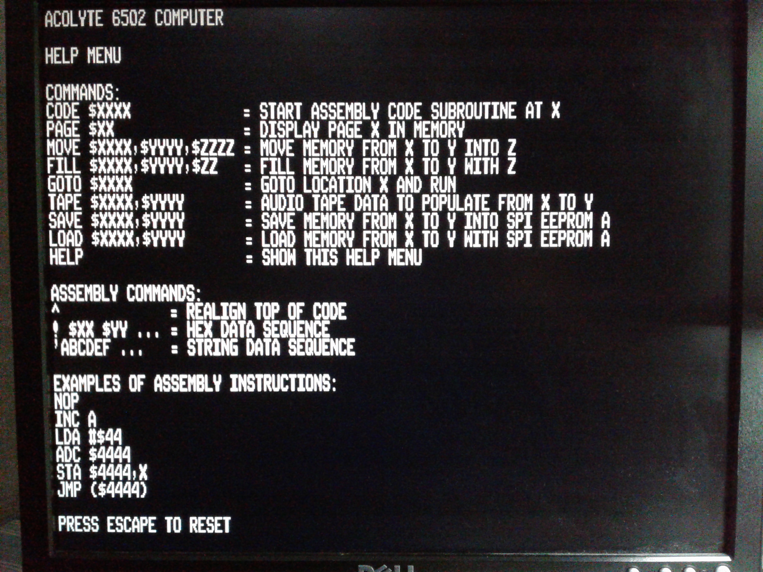

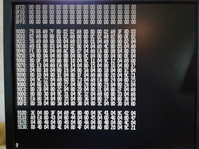

This will be the last update for a while, because... I commented my code!
Attached are some pics, and my mostly-fully commented code. Finally!
So I made the arrow keys work again, and I added the "FIND $XX" command, which inverts the color of whatever byte you want to find. It's still very readable, and it's not too obtrusive, so that's a good compromise. There was some type of bug in the assembler, but I think I fixed it, because I'm not seeing it mess up anymore. It was kind of strange for a bit.

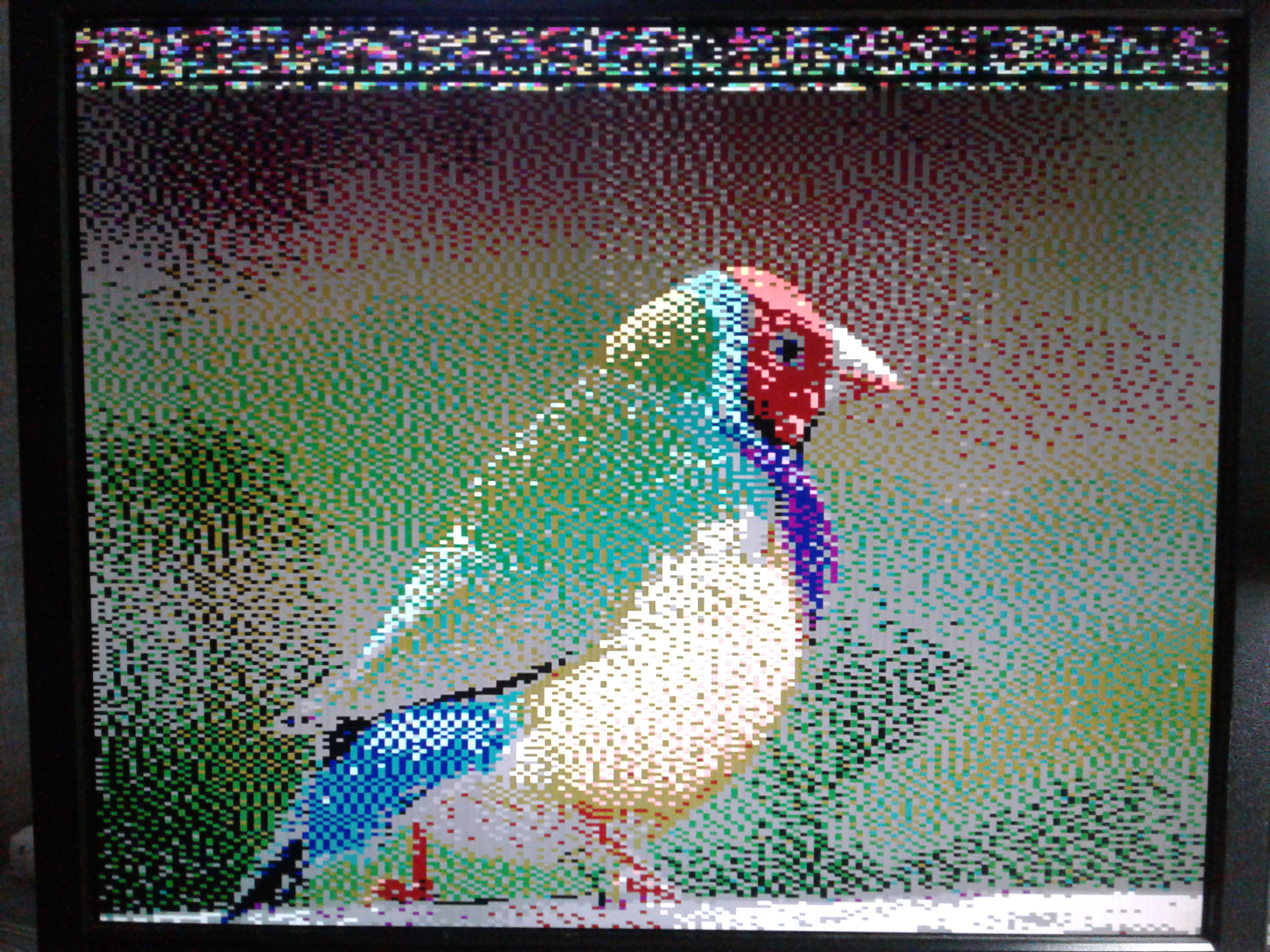

Finished SD card reading! Writing to the SD card won't be much different than what I'm currently doing anyways, but I'm undecided on a command name as of now.
Attached is the bird I transferred over from the SD card into the 6502 computer. It took about a minute, super slow in comparison to what it *could* do, but I have long delays built in and whatnot.
Also attached is the (commented) code. I altered the SPI stuff a bit to allow for enabling whichever device I want at the time.
Proxy, your link here was super helpful:
http://www.rjhcoding.com/avrc-sd-interface-1.php
Also I went through George's (gfoot) tutorial here:
https://github.com/gfoot/sdcard6502
Thank you very much George! That tutorial was PERFECT.
And of course, I referenced the famous Elm-Chan tutorial:
http://elm-chan.org/docs/mmc/mmc_e.html
The only issue I was having was that the MSB on R1/R3/R7 was high, which was definitely bad. I searched around and found that if I 'pump' the clock (even while CS is high) some amount of times (80 times here, like George) before EACH command, then it would work. And work it did. That little issue took hours!
Last night and this morning I was trying to decode the addressing for the read command. I figured it out finally, I need to think in "blocks" not "bytes" basically. Lastly, I tried to research FAT32 format, and failed big time. I'm so lost! So whatever, I came up with the idea to simply make an SD Card image file, and burn it directly to the SD card on the desktop:
https://www.embeddedts.com/blog/how-to- ... s-mac-osx/
So for me, I used the command:
sudo dd if=Demo1.bin of=/dev/sdg bs=512 conv=fsync
That put the bird data up top. Then I read the first 128 BLOCKS of data (that is 32K in bytes) from the SD card and put it into RAM. Then just pushed the RAM into video RAM and there you see the bird! The very top weirdness is just zero page, stack, I/O, expansion, and RAM variables.

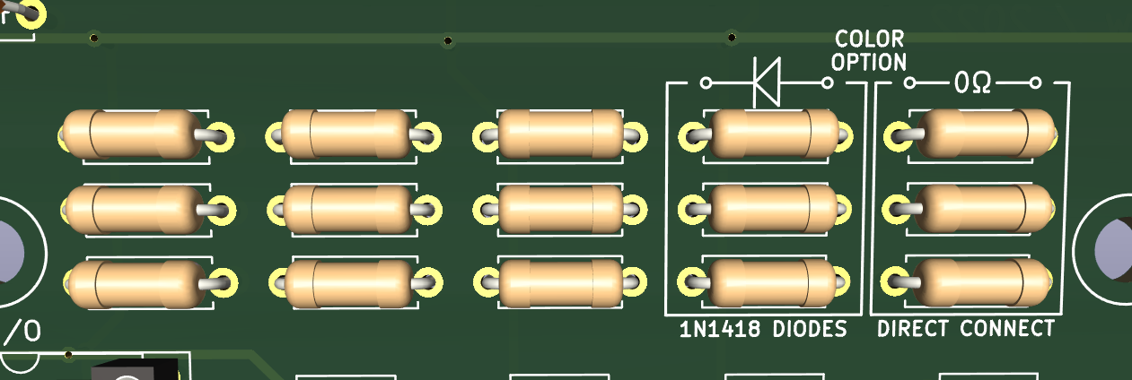

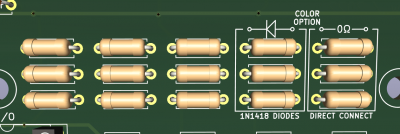

That was a super idea George! I did something in between, but still down this road. Attached is a picture from KiCad of what my VGA color resistors look like. As you can see, I have the option to switch from resistors to diodes. I checked both formats on falstad.com and they seem roughly the same in intensity. Resistors make more pastel lights and darker darks, diodes make brighter lights and even darks.
Again, thank you for this, and all the rest of your help, directly and indirectly.
So as y'all can see I'm in the process of making my 'Rev2' board already. And, I have some interesting add-ons I'm planning on including. More to come later, thanks!
