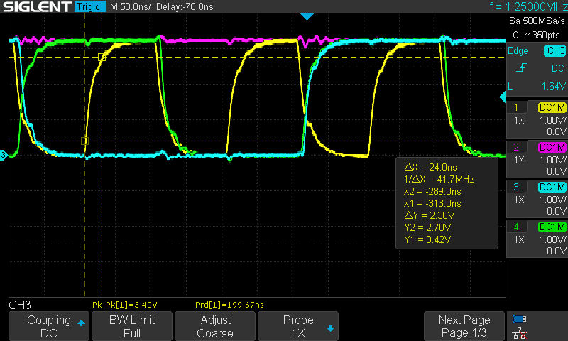

Right, I've tried with a 5MHz clock oscillator.
As before the clock signal is yellow, the green is ÷ 2 and triggers at 2.50000MHz. The cyan is ÷ 4 and triggers at 1.25000MHz
The pink is still the 3.3V line and I'm not sure what to make of it.

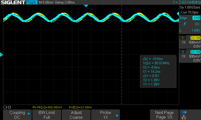

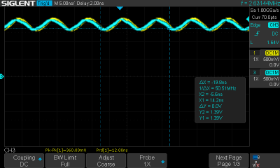

I check what sort of difference the probe placement would make and their definitely is a difference. The cyan (front) signal is the probe attached to the 0.65mm traces on the IC (that was fun :| ) and the yellow (behind) is the probe attached to the pins and wire. Swapping the probes around produces the opposite result (yellow falls exactly where cyan does in the picture) so it's consistent.

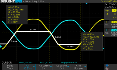

In the graph the white line rises from 0.4V to 2.0V. I was curious how long I was in the valid ranges in 3.3V LVC. I don't know why I measured from 0.4, the low level should be 0.8 which makes everything EVEN BETTERER!

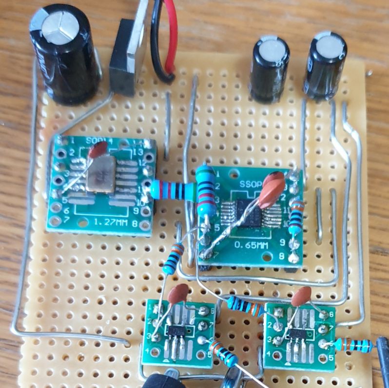

Quite a lot of the solution was pulling all the signal pins out of the stripboard and soldering them directly together. The resistors are there to stop the ringing, I haven't seen anyone else do this but it works. Comments on what I should be doing would be most appreciated 8)
The Frankensteined caps on the 74LVC74 flip-flop was left over experimentation; I could probably have used a single 1.0nF or 0.1nF bypass capacitor. The clock oscillator is 100Mhz HCMOS whose output is fed into the flip-flop as a clock divider and from there it's two outputs (Q and /Q) are fed into the two 74LCV1G34 buffers.
I should mention I'm getting about 0.5V peak-to-peak noise on my 3.3V line (mostly around the flip-flip) I think the only real way to solve that is to go to a PCB.

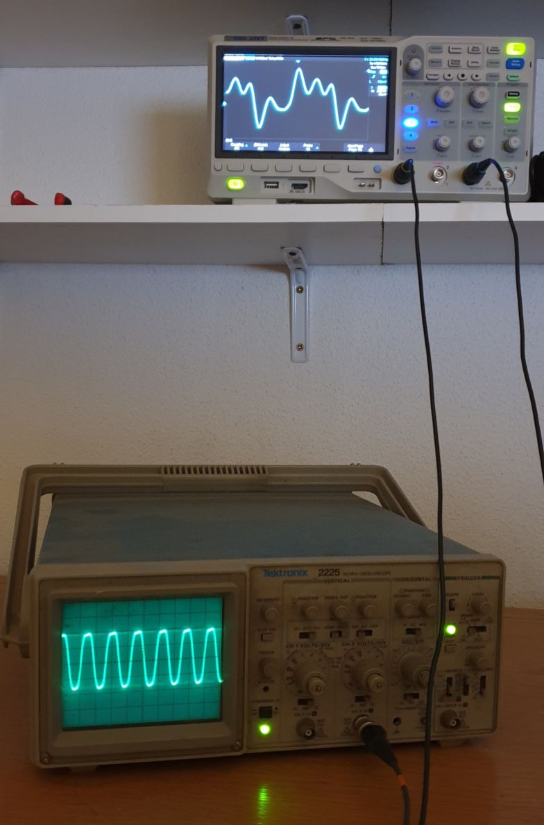

For those not yet well versed in the use of oscilloscopes, it's a highly worthwhile exercise to spend some time scoping the ground connections of your project. You might expect ground to read as just a flat line, but that's rarely what you'll see when there's fast logic that's switching nearby.
As you improve your technique (and this depends heavily on the use of a short ground lead on your scope probe, as shown in the photo) you'll see ground get quieter and quieter on the screen. Probably you won't achieve the ideal, perfectly flat line, but do give it some effort before you decide it's "good enough."
The point is, the scope will usually be showing you a certain amount noise that's not relevant, such as the noise picked up by a probe ground lead that's excessively long, attached to the wrong point in the project, or -- worst of all! -- simply absent. Your first line of defense is to limit stray noise pickup as much as you reasonably can. Then step two is to apply a mental fudge factor.
So, for example, if you scope the ground pin of an IC then scope the Vcc pin, and both pins seem to have the same type and amount of noise, then no problem is indicated WRT the power to that IC -- even though you may seem to have "about 0.5V peak-to-peak noise" on the Vcc pin.
PS- Andrew, I'm not suggesting your observation is wrong, just saying that all such observations have potential to be misleading. Also, even the "short" ground lead in the photo is longer than ideal -- a compromise.
