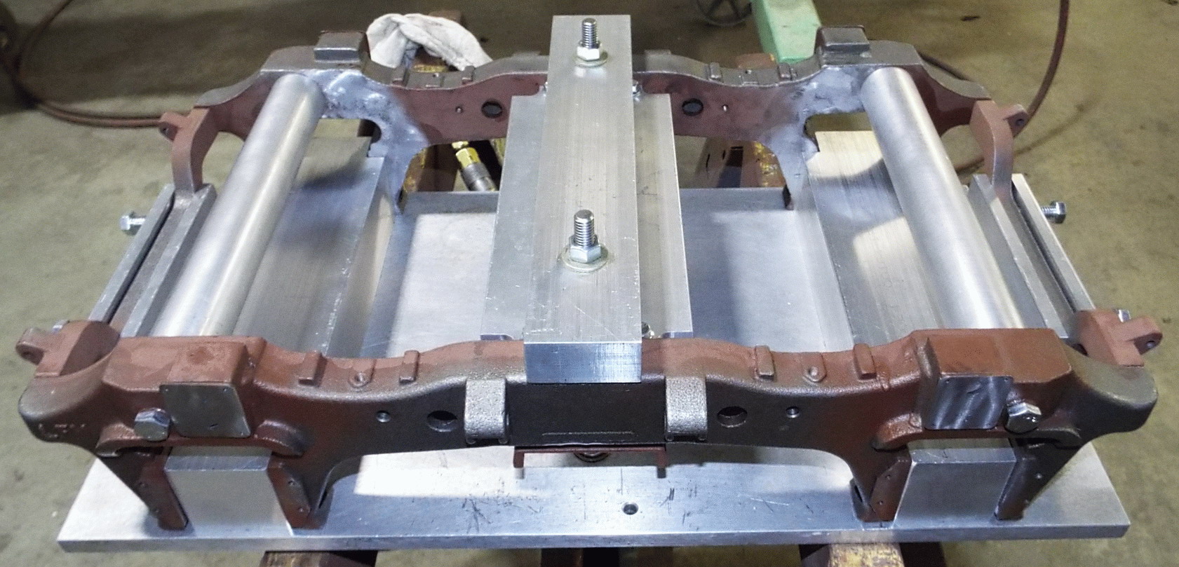

Tool-building can be a hobby in and of itself. My late granddad thoroughly enjoyed it.
I agree—been there, done that in building my large-scale locomotive. See below.
File comment: Truck Frame Welding Fixture
There are about 40 hours into building that fixture, plus about 200 dollars in material.
Such tool-building is primarily a case of making custom welding jigs and other fixturing needed to fabricate things—means to an end. However, tool-fabrication is not the hobby; building and running the locomotive is. Indeed, I look at such fabrication as unavoidable lost time.
Just about all of the tools I own are purchased, mainly because I lack the machinery (and skills, in some cases) to fabricate such tools from scratch. While I could, for example, make a 1/2" drive ratchet with the machines available to me, the people who are in the business of making ratchets, hammers, etc., can make them better and at a lower price than I ever could. Plus they'll even warranty them against failure (most of the time—watch out for Harbor Freight tools).

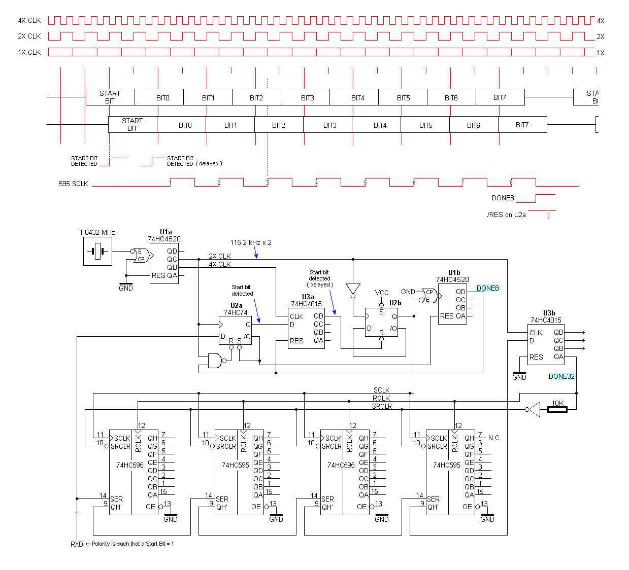

74x595 shift registers can also be driven from an asynch ("RS232") port. Besides the 595's, what would be on the receiving end is an oscillator and four 74xx chips, as shown below (one each of 'hc4520, 'hc74, 'hc4015 and 'hc132). I like some of the other approaches that were mentioned, including the FTDI FT245, but let's have a closer look at my Dumb Asynch® approach. :)
The bare PCB mailed to the newbie would accommodate the circuit below plus some as-yet undetermined jumpers and sockets for the (E)EPROM. (And BTW I agree with kernelthread's remark that it'd be good not to rely on memories that require dangerous, magic-smoke-releasing voltages.) The recipient would populate the board and drive it...
  • directly from an RS232 port (requires an ancient PC :P )
  • via USB and an inexpensive RS232 converter
  • directly from their Arduino/whatever
I'll describe the circuit then note some pros and cons. And it's a work in progress, of course. Years ago I built a Dumb Asynch receiver that lived in a CPLD, but this is my first stab at a discrete logic version. Comments and circuit proofreading welcome.
    U2a samples the incoming bitstream at twice the data rate, looking for a Start Bit (which will be a logic high). A high on U2a's output is delayed by shift register U3a, after which it allows U2b to come out of reset and start toggling, and that's what produces SCLK for the 595's. SCLK is shown in the timing diagram; its rising edges reliably sample the data stream despite the variability that's present. U1b counts the trailing edges of the SCLK pulses and sends DONE8 high when 8 pulses are done, resetting U3a immediately then U2a when 2xCLK rises. This completes the reception of one 8-bit byte, whose bits also shift into the string of four 595's.
    The bytes are sent in groups of four, and the first byte's LS bit is a "sentinel" bit which must always be a one. When all four bytes are received and properly framed the sentinel bit will appear at Qh of the final 595, causing it to go high. That high gets ingested by shift register U3b, resulting in a logic high pulse that traverses its QA, QB, QC and QD.
    When the high pulse appears on QA, this clocks the entire 32-bit frame from the 595 serial registers into the parallel registers; an instant later, SRCLR goes low to clear the serial registers and ensure no false sentinels are subsequently perceived.
    As the pulse proceeds to QB, QC and QD of U3b, this is what would trigger the memory operation(s). We have 31 bits of data to work with, which I picture as a 7-bit Control Word along with the intended address and data.
In a bare-bones version, the programmer would be write-only (or at least unable to read and transmit the memory's content back to the host computer). However, it may be sufficient that the user can manually read and verify bytes one at a time, just enough to ensure the circuit is working. For each byte, s/he'd transmit a 4-byte frame with the desired address but with dummy data and a Control Word that calls for a read rather than a write (or maybe the read function would be selected by a jumper option). Then the (E)EPROM's data out could be manually tested one bit at a time using a DMM or logic probe (or LEDs could be included for this).
But if I build one of these for myself -- and I'm tempted! -- I'll wanna be able to transmit the memory's content back to the host. A newbie doesn't require this, but I have some legacy EPROMs I'd like to back up before they start getting as forgetful as I am! :roll:
I don't think it would take much to add the readback function. I'd load a '165 or similar parallel-to-serial register, triggered by the pulse off of QD. This would cause a single byte to be transmitted back to the host at the conclusion of every four-byte frame. I'd also need to generate a Start Bit, but overall I expect the amount of extra logic would be minimal (the '165 plus one other chip?).
To summarize, the advantages are low cost, freedom from reliance on any particular OS or manufacturer's tool, and escape from the Catch-22 which Alarm Siren noted (about needing a programmed EPROM in order to build the EPROM programmer!)
Edit: tweaked diagram and text
