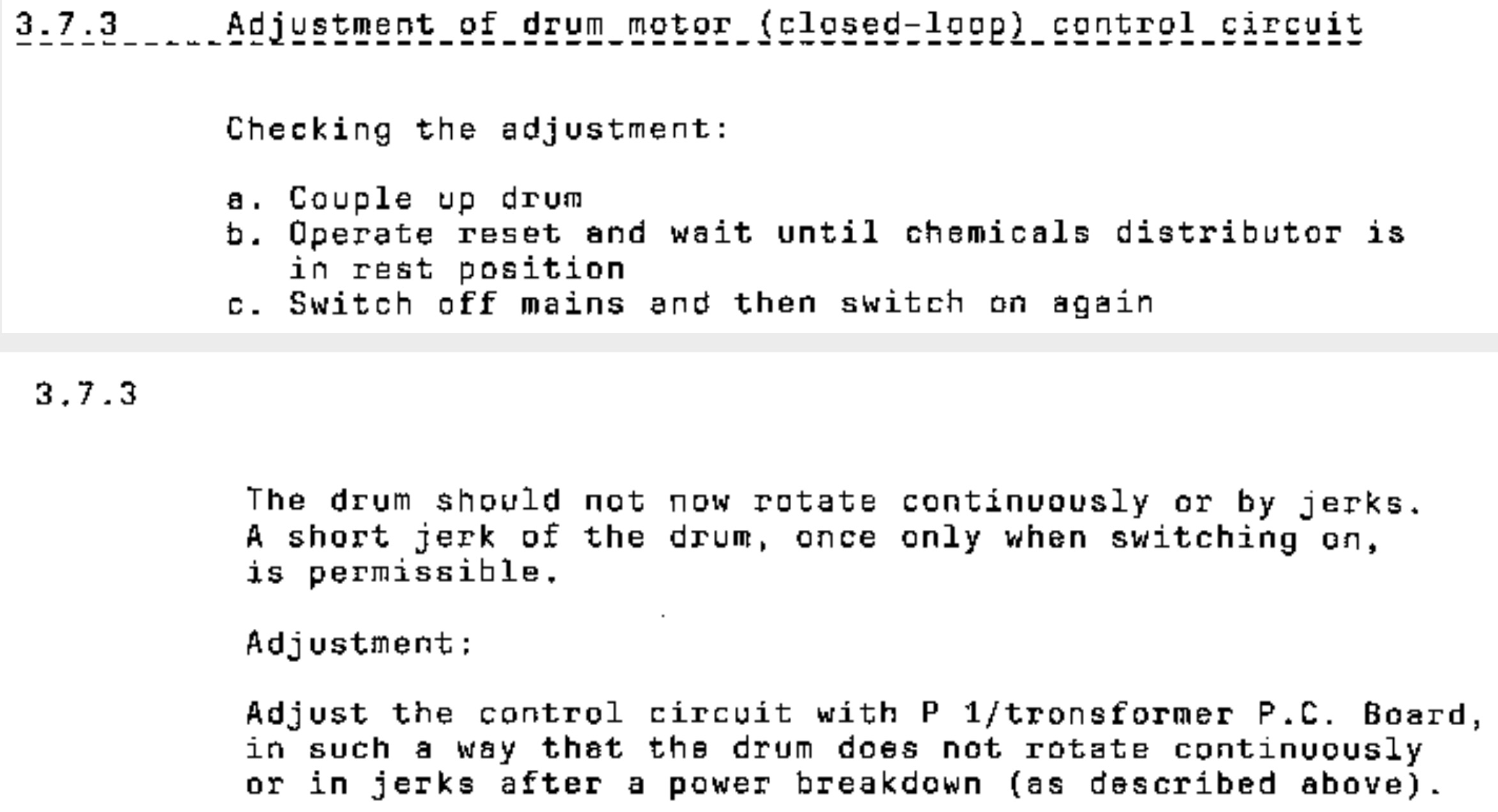

Perhaps it's not working, or perhaps my hasty inferences regarding that circuit are incorrect. It might be helpful if you have any documentation that comments on the function of the 20K potentiometer, P1. Meanwhile, if the transfer gears aka shear pins seem satisfactory as torque limiters, then maybe you can just rely on that!

I have attached the only mention of the P1 pot in an old service manual for the older model.
The boards are close cousins. Some differences but it looks like the motor control section is identical.
The manual is definitely a poor translation from German to English. And the entire section that relates to the transformer board doesn’t exist.
This manual refers to the ATL 2 and 3 which are late 80s machines. There is no mention of it in the service manual that goes with my 2300.
I think you're right that it relates to the stall current but on my machine the way it acts is different.
