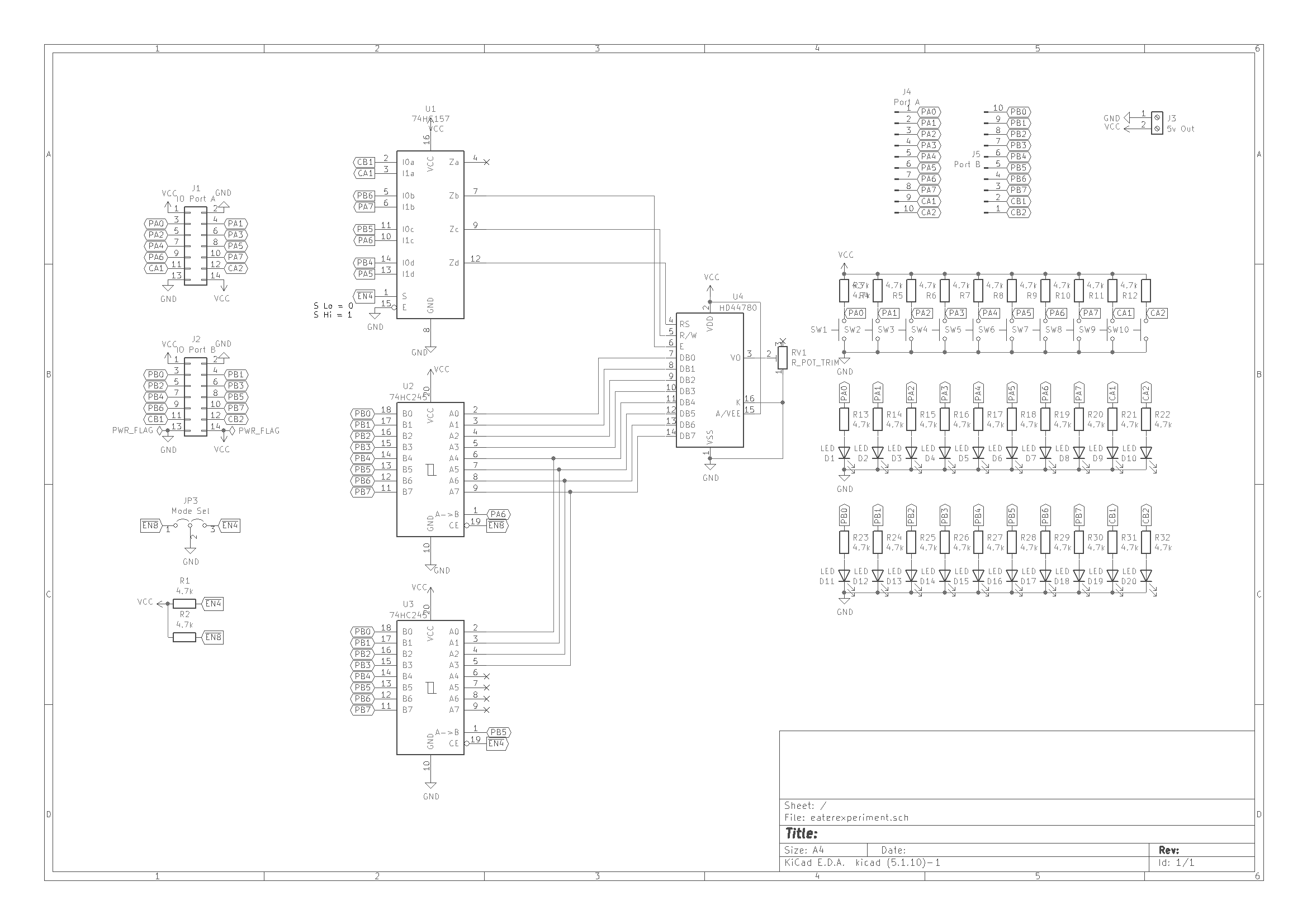

Well, I haven't gotten to the interrupts part yet, but still drew up an initial schematic that I'll probably start from.
an '138 provides PHI2 qualified /RD and /RW for the FT245R, and an /ENSTA (enable status) for the '245 buffering TxE/RxE. Right now input A2 of the '138 is drawn hard connected to A11. For the Wilson style linear decoding I'm using, I'd probably have a set of jumpers on board to pick which of A12-A4 is for the board.

I'll echo what cjs said above - you are unlikely to have any use for a TXE interrupt. Data is sent so quickly relative to the speed of a 6502 that, unless you're clocking the 6502 at 20MHz or more, or the PC pauses for whatever reason and flow controls the device, you'll rarely see TXE deasserted.
Regarding your schematic, note that whereas the RD strobe is active low, the WR strobe is active high. Data is latched on the falling edge of WR, so that needs to be coincident with the falling edge of the 6502 clock.
