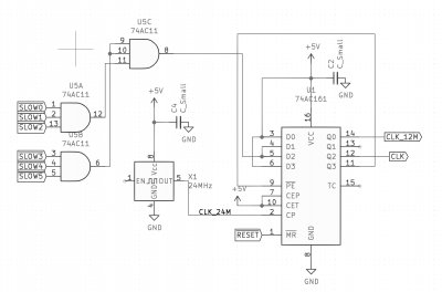

An update on the project: I'm still trying to find a way of having a slower clock for slower peripherals, I've been experimenting on my SBC and not really getting the results I want using the ATF22V10, so I will go back up thread and try some more options that have been proposed.
On the bright I have forth running like a charm via serial. It was my first time trying forth and the elegance is something else. What a pleasure discovering this.
Jonathan Foucher
PostPosted: Sun Jan 10, 2021 12:32 am
Joined: Sun Dec 27, 2020 11:12 pm
Posts: 94
Location: France
Ok, here is what I have so far on the clock stretching front:
I have used the clock stretching with counter method presented here. Here is the schematic for the clock part (bit of a messy draft, sorry).
File comment: Clock circuit schematic
If a base clock of 24MHz is provided, the normal clock will be at 12 MHz and the slow clock about 3MHz if my calculations are correct.
SLOW0 to SLOW5 are individual signals that the expansion cards can send to request a slower clock speed. Each expansion slot has it's own SLOW signal. For example, the CPU board's ROM select is also tied to it's SLOW pin which slows down the clock when the ROM is selected.
I am a bit worried about the time between address setup and the next positive clock edge. From WDC's datasheet it appears the address setup time is 30 ns, but a half period at 12 MHz is 41.6 ns. Even 74AC logic has a propagation delay of about 5ns and the 74AC161 requires I think 8 ns of setup time, giving a total of 43 ns, so it would appear that this scheme would only barely run at 12 MHz. Please do correct me if these calculations are wrong.
The 74AC11 datasheet gives quite a wide range of propagation delays from a min of 1.5 ns to a max of 8ns.
Am i correct to think that depending on the specific chips I get, different speeds will be attainable?
Can I get your feedback on the design of this clock circuit ?
Thanks
You need to reduce the amount of cascaded logic. Instead of running your wait-state selects through multiple gates try a 74ACT11030 (data sheet attached).
You should know I have implement Jeff's circuit on my POC V1.2 unit, which runs at 20 MHz. A basic design rule I follow is to never have more than two gate delays between the address bus and any one chip select. Another basic design rule I follow is to not qualify any chip selects with Ø2. By doing so, I take advantage of the fact that the MPU will present a valid address on the bus while Ø2 is still low, giving the glue logic a "head start." The only signals I qualify with Ø2 are /RD and /WD.
Am i correct to think that depending on the specific chips I get, different speeds will be attainable? Can I get your feedback on the design of this clock circuit ?
Manufacturers post the minimum and maximum timings to account for variations from wafer to wafer, as well propagation delays that will vary with temperature and operating voltage. They guarantee the device will operate in the claimed timing range if the operating conditions conform to specs. If reliability is a primary concern, you design with the assumption that all logic will run at the slow end. In a strictly hobby design you can fudge.
Getting back to your circuit, my curmudgeonly opinion is you are making it too complicated. As I said above, my POC V1.2 unit (65C816-powered) runs at 20 MHz and does so with a single wait-state for ROM and I/O access. The signal to trigger the wait-state (i.e., clock stretch) has only one gate delay and according to the logic analyzer, there is plenty of timing overhead available.
That said, I'm not seeing where you would ever need more than two wait-states. Your design should impose a minimum performance level that must be supported in peripheral cards, same as is done in PC hardware. Given that current WDC microprocessors (that is, ones with TSMC 0.6µ cores) are production tested at 20 MHz, your design should require that peripheral cards be able to function with no more than two wait-states. You don't want to make the clock-stretching circuitry too elaborate, lest you introduce too much cascaded logic and needlessly limit your machine's performance.
Also note that all WDC peripherals undergo the same testing as their microprocessors, and although are rated for 14 MHz, will run reliably at 20 MHz with a proper circuit design and a Vcc of 5 volts.

Hi BDD,
Yes, a minimum performance requirement for all cards sounds like a good idea. And if they cannot meet it then they have access to the RDY pin on the expansion bus to stall the CPU the required amount of time.
I have actually tried the counter method of clock stretching on my prototype board computer, but could not get it to run stably at 10MHz even. I thought I didn't have any JK flip flops in my box, but I actually do have a few 74HC76 (I inverted the clock and the ROM select signal in the 22V10 to let them behave like a 74HC109). This seems to run ok at 12 MHz.
On the scope it appears the address setup time is much lower that what WDC claims (I get a valid ROM select 20 ns after the negative clock edge, minus let's say 5ns from the 22V10, that's 15ns Tads). Is that to be relied on?
Regarding the 74ACT1130, first of all thanks for letting me know about this chip. I was looking for a 74AC30 which does not seem to exist? Would there be a J-K flip flop with non inverting K input and positive clock edge trigger? This combination seems like it would work pretty well.
Jonathan Foucher
Using RDY itself can introduce some interesting problems, especially with the 65C816. This topic expands on that.
The 'HC109 may be part of the problem. Most 74HC logic is no faster than the equivalent 74LS parts, so you may have inadvertently introduced some timing issues that faster logic may cure.
It's been our experience that WDC's timing claims are conservative, as are their output drive claims. Again, if it's a production item you need to design for worst-case. If it's a hobby unit, you can design less conservatively, knowing there may be a case where it won't work.
As far as I know, no manufacturer produces a 74*30 in AC logic. The 74ACT1130 is your best bet. I used one in my POC V1.2 unit in the glue logic and got the desired results (20 MHz operation).
Closest thing would probably be a 74AC112.
