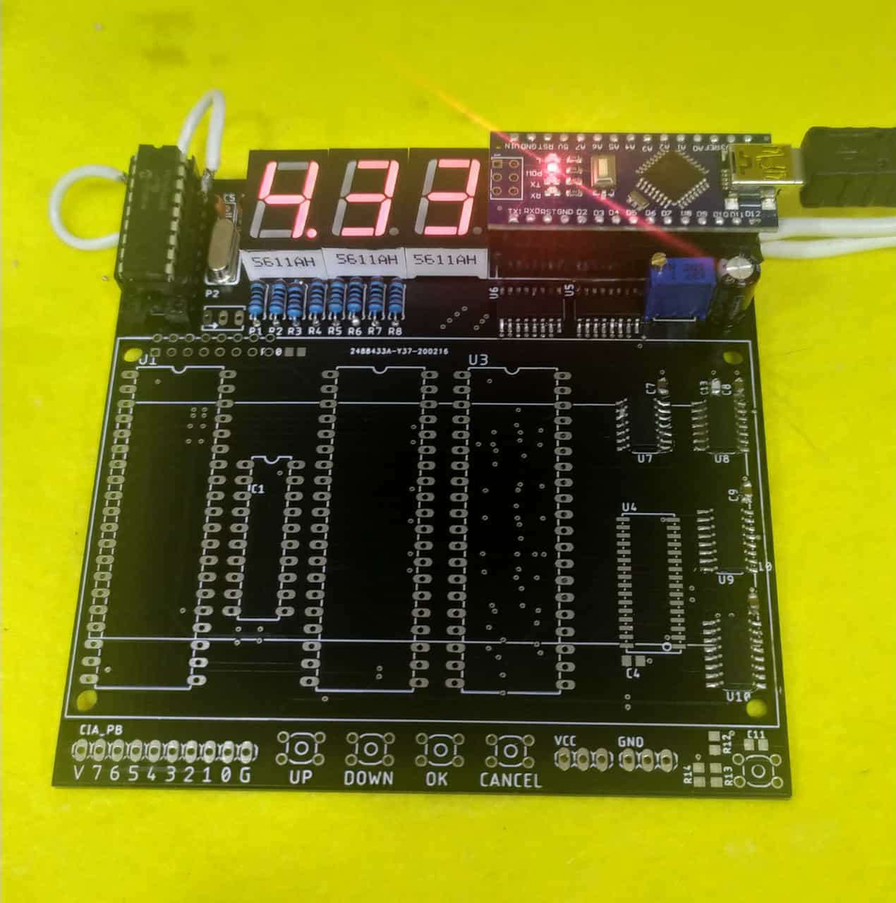

Hi all.
Small update after a long time... but amongst plenty of other things, my little projects have been heavily hit by the coronavirus crisis.
Just a bit of context, for all of those who don't know, I live in Madrid, which has been very affected by the disease. Right now, it's the 43th day quarantined at home, and with my wife and I working from home, I had to dismantle my humble workbench. Also, the postal services have been giving only very limited support, and I'm still waiting for a few components to arrive... so pretty much everything has been on hold.
On the bright side of things, the general situation is improving here, the local hospitals aren't that saturated anymore, and, even though there's still a long way ahead, we can see the light at the end of the tunnel. We've also been lucky, as we're all OK. I may have had the disease... I spent like 10-12 days sick, which is very unusual for me, but even if it was the Covid, I never needed medical assistance and only some paracetamol was needed.
Back on topic, I've managed to find some small gaps in both space and time to continue working on this, thanks to some local suppliers, I've got (almost!) all the components I needed.
Right now, I have in place all of the following:
- Nano + 595 shift registers. It works as expected, when BE is pulled low, the 595 are enabled and I can drive the address bus, data bus and R/W from the arduino.
- Memory decoding (139+138). Working as expected, tested driving the address bus with the Nano
- Clock generator (74 + 14). Also working, I've seen a prety nice square wave up to 7 MHz or something. Beyond that, I'm not sure if is the signal, or my oscilloscope, but it becomes a nasty mess.
- Frequency Meter (7Segment leds, PIC). Beautiful, and working! I can go as low as 600 KHz, and up to 16MHz before it stops giving a stable value. This doesn't mean the clock signal is still good at that speed, but anyway, it's a nice achievement.
I needed a couple botch wires for the PIC, as I had mixed two of it's pins on the board... D'oh! And the power jack didn't fit below the arduino... so it's been moved out of the board. Not pretty, but still works :)
My next steps are,
- Adding the reset circuitry (The SBC can be reset with the reset push button, the Nano also has the ability to reset the SBC, and of course, during startup)
- And then adding the RAM and writing/reading it with the Nano.
Cheers!

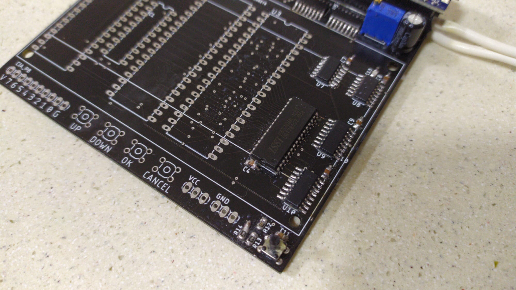

This has to be the most repeated advice on this forum... but anyway... here it goes again.
Don't work with real hardware if you're tired, ever!
In an awesome example of "Don't follow your own advice" I've managed to blow up three arduinos and a couple of IC's last night. Just by inserting the arduino with an offset of one pin... well... 12v flowing where 5v should be! Somehow I repeated it again, and then, the third arduino failed, as far as I can tell, out of nowhere (A Zener diode blew up, can't really spot my mistake there)
But today was a new day, I've managed to Frankenstein-up myself a working arduino out of the 3 failed ones, replaced the two burnt ICs (The clock generator... 74 and 14 went up in smoke) and now I'm back again where I was before this little accident.
Back on track, I've added the reset circuitry, and it works as expected
~250ms negative pulse on power up
A nice low pulse when the reset switch is pushed
And the Arduino can also trigger a reset when needed.
SRAM was the next on the line. Soldering the SOJ-32 has been very difficult, partially because I think the footprint I had wasn't 100% accurate. No matter how hard I tried, I couldn't completelly align the chip.
But, in the end, it's all in place. I've done a very quick Sketch for the Nano, and it seems I can read and write the memory.
Close up of the Reset circutry and SRAM. Yes, C4 solder is a mess... but remember..

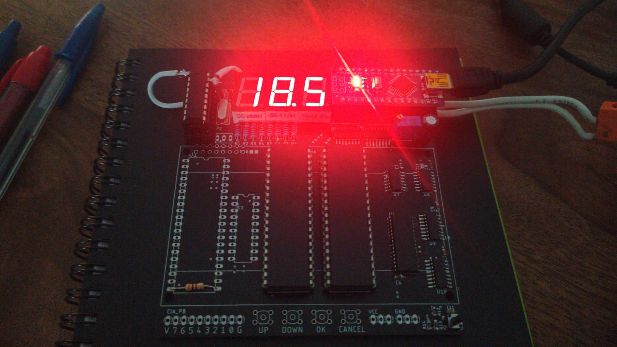

And BTW, 65C22 is also in place now ...
at seems to work at 18.5 Mhz! It may not hold up with more complex code, but it's a wonderful start.
