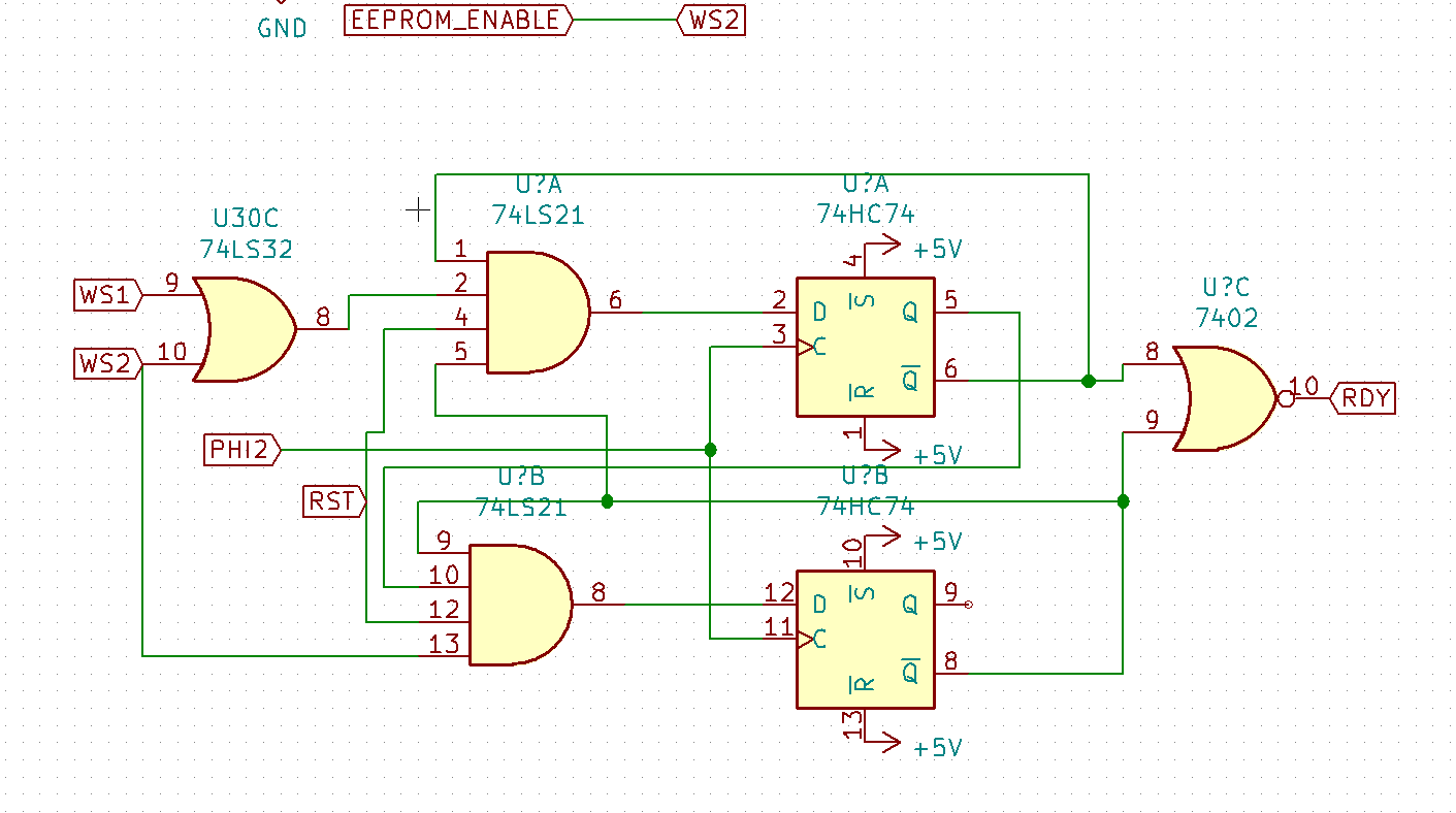

Yet another question: in Daryl's wsg he has OE only enabled if WS1 or WS2 are asserted, is this necessary? I can implement this with a NAND over top of an OR with a leg tied to the original OR input, but if I don't need it I can use a single NOR gate instead, without the OE qualification.

backspace119 wrote:
Another question, since RDY is bidirectional, I should not tie anything directly to RDY, but instead insert a 3.3K resistor between RDY and any input, correct? I already have the resistor, tied to 5v, just making sure I'm still going to be driving this correctly.
The RxC time constant might be a problem with a fast clock. You might need a 20pF or 47pF capacitor across in-line signal resistors (but not pull-up resistors) to remedy that. Post your idea before committing.
Alright, here's my WSG:
and here's my RDY line: (with the added cap you just suggested)
EDIT: that RDY line goes directly into RDY on the '816 after the cap+resistor, sorry for omitting
PostPosted: Wed Feb 13, 2019 11:14 am
Posts: 8510
so if the capacitor goes from pin 10 of the NOR to the RDY input of the processor, that looks good. (We'll see if I still think so after I've gotten some sleep. I've staying up half the night to get the tax stuff ready for the appointment with the accountant in the morning. zzz...)
Are you aware that in WDC parts, the RDY signal is bi-directional?
If you execute the WAI instruction on a WDC 65C02/65C816 then it will drive the RDY line low.
Hopefully you'll never deliberately use that instruction, but a code crash, jump to the wrong location and who knows what may be executed... (I use it both ways on my Ruby 6502 board)
