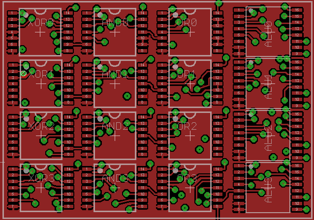

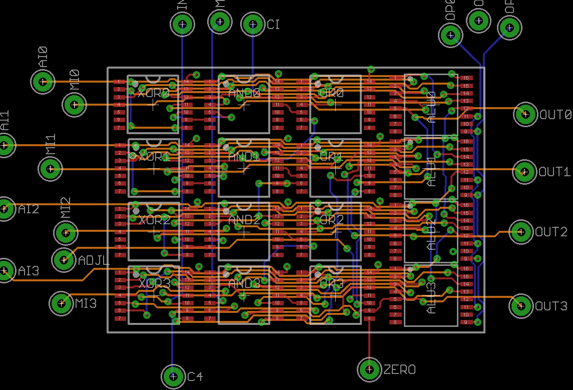

Here is the ALU nibble completely routed (still needs to be cleaned up a bit). The surrounding white box is 32x24 mm. A full ALU should be twice that, so 32x48 mm, which is about 10% of a Eurocard. The green circles are test points. They just serve as place holders for all external connections (input, output and control signals). Inputs are all on the left, outputs on the right, and controls run vertically. The bottom two signals (partial Carry and Zero flag) should propagate to upper nibble.
I think I'll start working on the PC and AB logic next, to get a better idea of how that's going to look. The PC will also get a ripple carry, but only has 1 gate delay per bit, instead of 2. Of course, it will be twice as long, so total delay should be similar, but slightly less than ALU. The rest of the design won't have any more adders or incrementers. A lot of muxes and registers, and some random logic. I'm trying to fit all the logic in half the Eurocard size, and reserve the other half for the PLA. No idea if that's enough, but we'll see it when we get there.
My plan is to draw schematic and do layout for each subsection, keeping them well separated, and then experiment with different placements on the board. If you keep them apart, it's easy to draw a box around a section, and move it around, without dragging all the connections as well.
Had to rearrange the mux inputs a little bit to make routing easier, so I also updated schematic.

Looks great. Lots to learn here from the approach you’re taking. Looks like traces on three layers?
 Post subject: Re: Yet another TTL 6502
PostPosted: Mon Jan 07, 2019 4:29 am

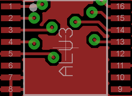

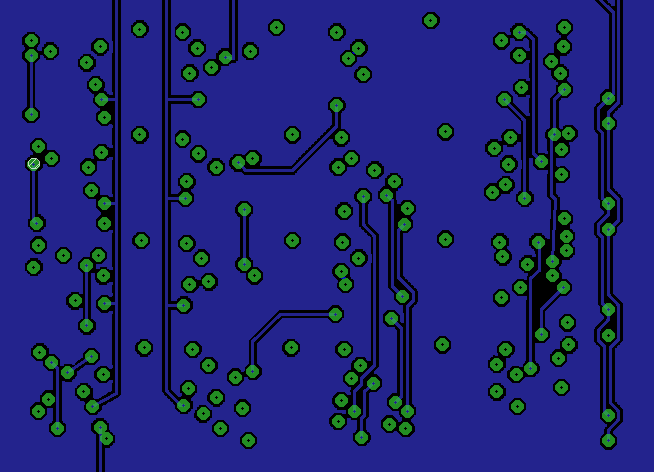

Yes, red is top, blue is bottom, and orange is one of the middle layers (power). There's a 4th layer for ground that I try to keep empty.
There are ground pours on top/bottom, but they've been switched off for clarity. I've added screenshot of the individual layers. On the orange one I've highlighted the VDD signal, so you can see it reaches the vias that it needs for powering the ICs with reasonably fat traces. I'll put a bypass cap near each of the vias.

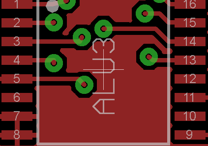

Also, at the last stage, I add a bunch of ground vias to stitch all the ground pours together. Couple of other things I'm trying to do: keep like signals together and avoid empty parts (still need to improve that here). This improves plating reliability. And try to avoid cutting ground plane in distinct regions.
See for example the top layer bottom right. There are two vias close together, interrupting the flow of the ground plane. I don't like that, so I'll go fix things like that.

Fixed the interrupted ground by moving via a bit

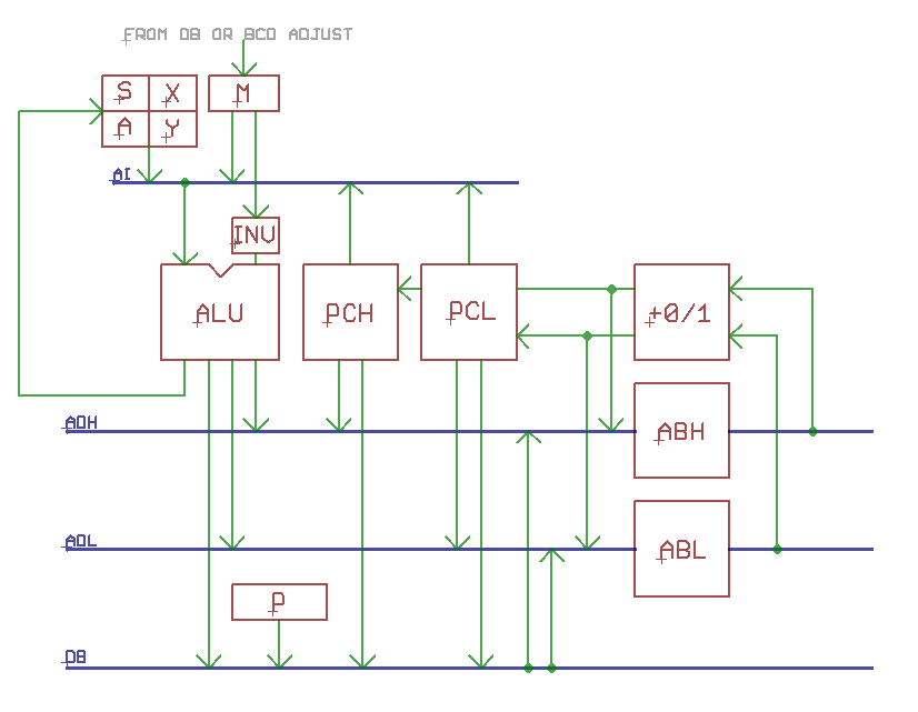

Hello, I've been following along and find myself intrigued, especially when the Verilog code is posted. Would it be alot of work to post an RTL schematic of the code? If it's too much trouble, maybe just once in awhile. Or am I just being lazy? :oops:
PostPosted: Mon Jan 07, 2019 6:35 pm
I'll try to post more schematics soon. The code should crystallize pretty soon, and then I'll start converting more parts to schematic. For now, it's so much quicker to express thoughts in verilog than in schematic. You could try loading the code in ISE and see what it makes of it, but I'm afraid it's going to be an unreadable maze of wires.
Here's a very quick block diagram of the datapath so far.
A, X, Y, S, M, ABH, ABL, PCH, PCL (and IR, not indicated) are all 8 bit registers.
