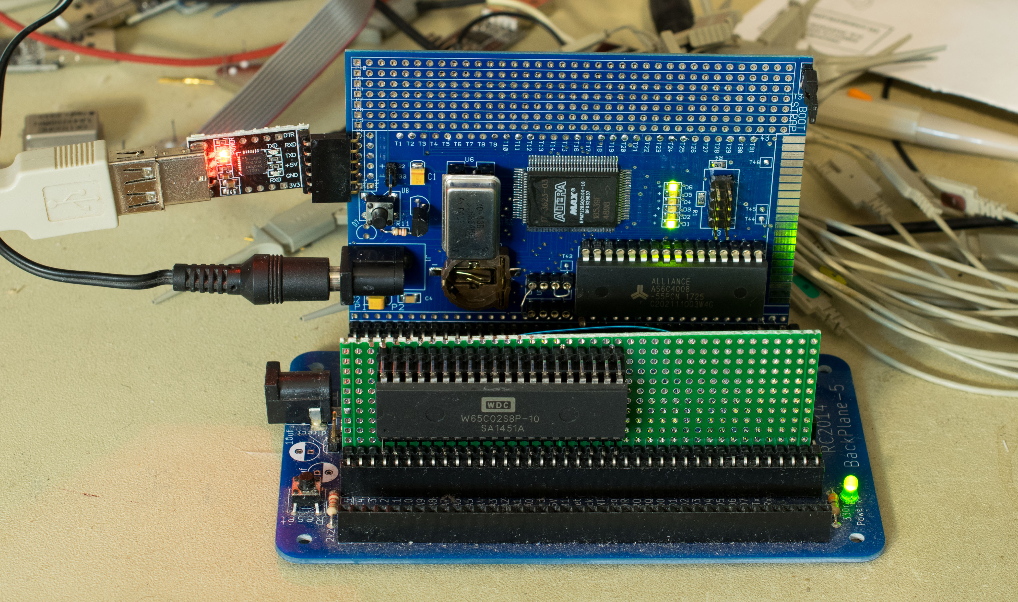

This is the G8PP+6502 as of a couple hours ago. The series resistors on address lines are not yet added in the photo. Clock is 7.37MHz. Signals look reasonably clean on the scope. I think I'm loading serial data into RAM and observing it bootstrapping after 255 bytes, but it is not executing correctly. There are many moving pieces to this puzzle, one of them is that I don't know much about 6502 assembly instructions. Climbing a steep hill but having fun!
You, sir, have a counterfeit part.
First off, the logo is not well-formed, which alone would make me declare it to be a fake. Then there is that date code: SA1451, which means the device was fabricated in December 2014. If that were the case, the device would be rated for 14 MHz, not 10, as WDC has not produced a 10 MHz 65C02 in years. Also, the die would have been cut from a wafer produced in TSMC's foundry, which would be noted in the part number.
The part number on a legit PDIP device that would have been made in 2014 would be W65C02S6TPG-14. The 'S' in the part number means it is a static core device (all WDC 65C02s have been static for more than 25 years), '6T' refers to the device's .6µ fabrication geometry and the TSMC foundry, the 'P' means it's a PDIP-40 package, and the 'G' indicates it is RoHS-compliant.

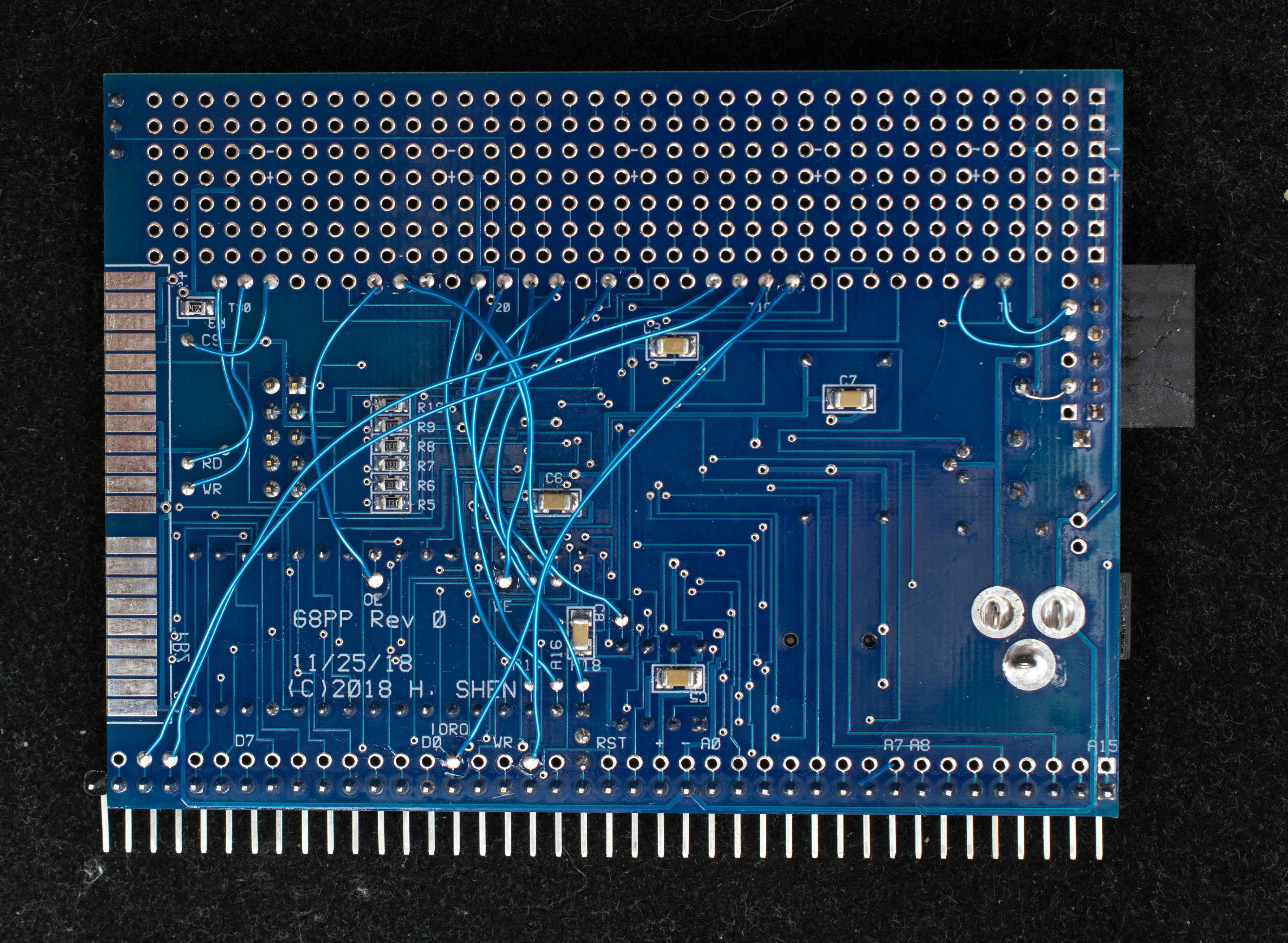

The G8PP platform is designed to accommodate varieties of 8-bit/16-bit processors from 1970's. I have 6 processors in mind: 6502, Z80, 8085, 6809, 68008 and 32008. I've already done the Z80 and 6502 but didn't really want to wire up a single-board G8PP board for every processor, so instead of building all-in-one single-board prototype, I decided I should emulate the RC2014 approach where there are multiple simple CPU boards and a common G8PP baseline board connected via a backplane.
Because each CPU has different control signals and timing requirements, the backplane signal assignments will change depending on the processor used. The addresses and data are the same, so are power/ground, clock, reset, and interrupt. The five Z-80 specific control signals and three spare signals of RC2014 are re-assigned depending on the specific processor. Each processor board is quite simple consists of unbuffered CPU signals connected directly to the 40-pin RC2014 connector.
The common board is the G8PP in baseline configuration. It provides the RESET, clock, battery-backed 512K paged RAM, serial port with bootstrap function, compact flash interface and an Altera EPM7128S CPLD. It also has a prototype area to accommodate additional functions such as RTC, SPI, I2C, etc. The CPLD can be reprogrammed to support different processor's control signals. Such two-board solution has enough functionalities to get CP/M running for the Z80/8085/68008 processors.
Since I've just finished the 6502, I tried out the multi-boards-with-backplane concept on 6502. This is a working configuration with RC2014 Backplane-5.

File comment: Back side of 6502 CPU board
File comment: Back side of G8PP in baseline configuration
File comment: 6502 CPU board & G8PP baseline on RC2014 backplane
