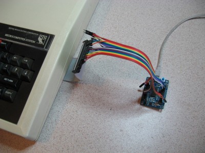

Excellent - so a logic analyser in this case needs only a £15 capture board, and just ten signal lines: the data bus, the clock, and RnW. By sufficient cleverness, you've removed the need for Sync, and so in the case of the Beeb the highly accessible Tube connector is adequate. Other machines will likely have expansion connectors with the right signals too.
(I'm going to borrow your photo, because photos are good:
I'm going to guess that Reset is handy but not essential - handy for triggering - and also that stretched clocks or RDY-stalls might still cause the decoder some desynchronisation??
Concerning RDY:
On the Master 128, ignoring RDY is problematic, at least currently.
On the Model B, RDY is rarely (if ever) used, and clock stretching (which is used instead) doesn't cause a problem.
Concerning RST:
Reset is indeed handy for triggering, and for acquiring immediate lock on the instruction stream.
The Master has a GTE G65SC12 processor, which is one of the few to actually do three writes to the stack on reset. So if reset is omitted, this is actually seen as an interrupt, which works out fine and you get a correct initial value for PC.
The Model B has a Signetics SY6502A, and without reset you tend to see a long stream of BRK instructions, and the initial alignment is somewhat random:
