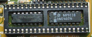

As for room, you can put other ICs under the VIA:
ICs under ICs are slightly visible in this photo also:

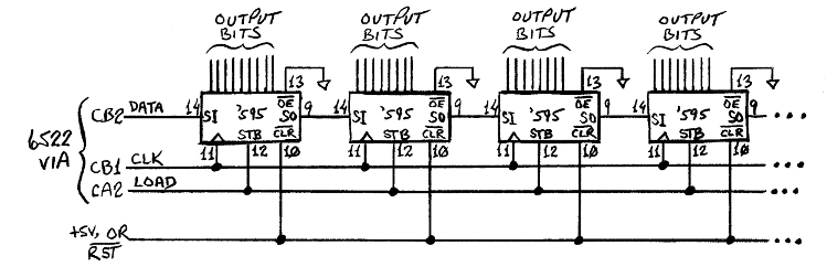

But really, for the amount of work you're going to put into it, the price of a second VIA is peanuts. Using the LCD in its 4-bit interface is easy, and probably won't be any less efficient than trying to manage it through other parallel logic which may slow your maximum clock speed down anyway, and certainly won't be as slow as doing it through SPI if you have to bit-bang it (although I do like SPI, even bit-banged!). Michael's idea using the '595 could be pulled off with the VIA's serial port, shifting at half the phase-2 rate without the processor having to bit-bang. In fact, I've done the following to get well over a hundred output bits from the VIA's SR (shift register):

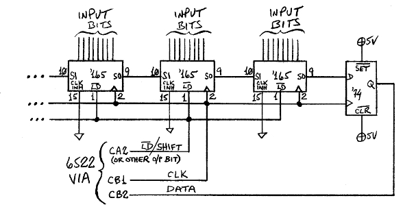

Similarly, you can also use the VIA's SR for tons of input bits:
or even both inputs and outputs on the same VIA SR, at the same time, using a 74xx126 section to stop the final 165's output when you're outputting to the 595's, to prevent contention.
[snip pic]

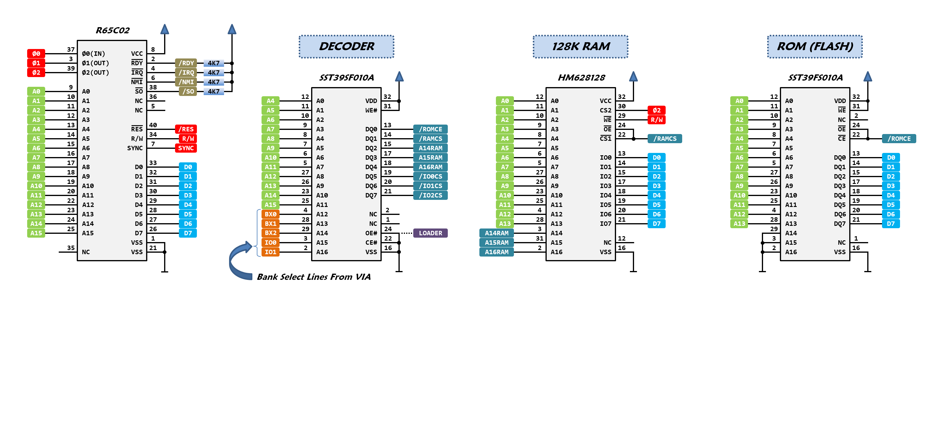

There's been mention in the past of using a ROM or RAM chip for address decoding but I haven't seen it used. Could this be a viable decoder solution for lower speed systems? Could a 55-nS Parallel Flash chip decode fast enough for a 4-MHz system?

In that circuit, there's nothing to mask off the A14-A16 lines from the RAM when accessing the Standard RAM area. You'd need a multiplexer controlled by the decoder ROM, or perhaps sacrifice three of the I/O chip selects in order to "pass through" the A14-A16 lines when appropriate (there's some spare address inputs on the decoder ROM so it could be done). Also I've not come across ROM chips that are that quick, but I assume they must exist.
How are you making these diagrams? they're absolutely beautiful :D

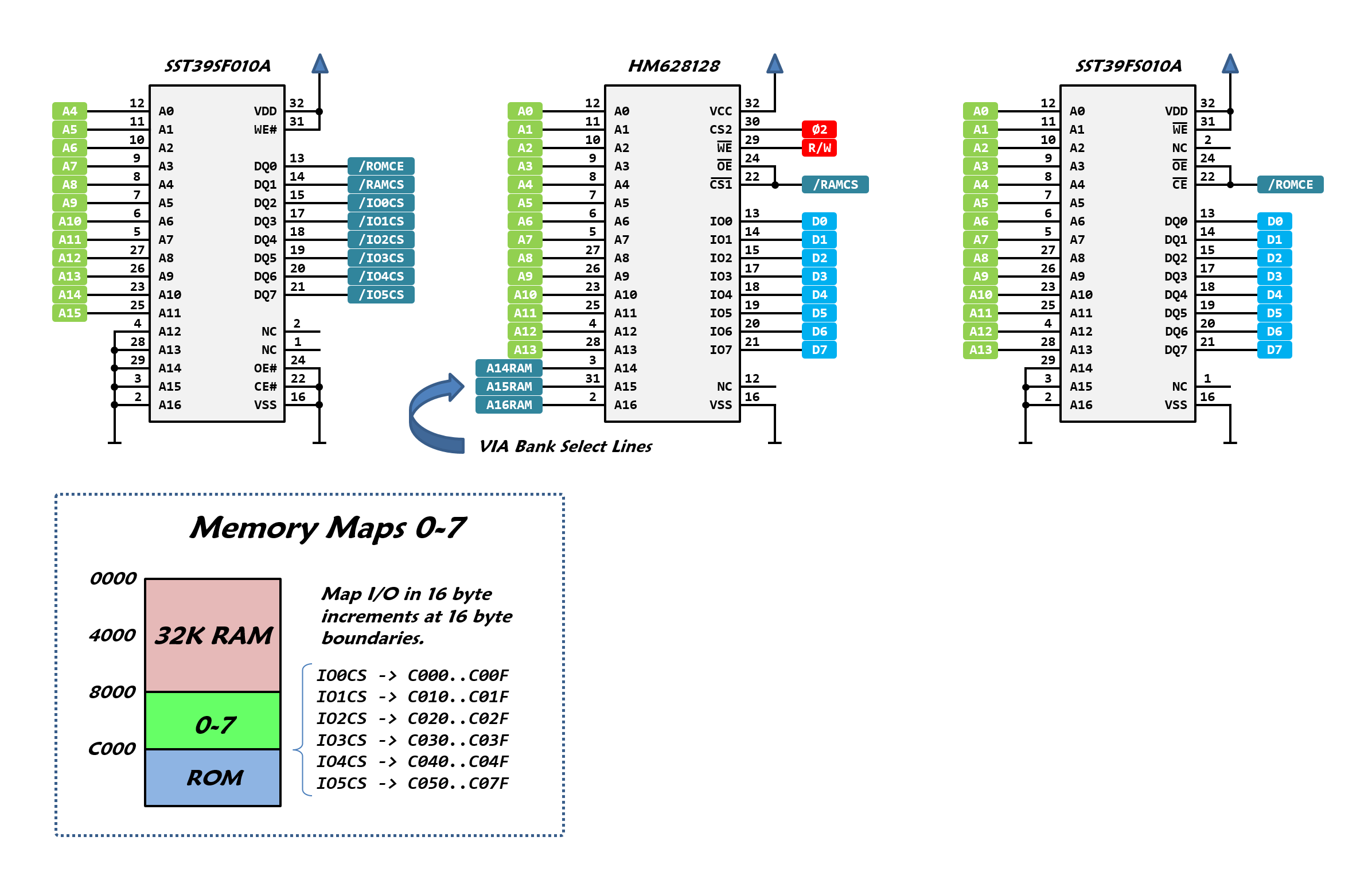

Sorry! The memory map insert was incorrect. That drawing is for your design with two RAM chips so the 128K RAM is only selected when the 6502 addresses the $8000-BFFF block.
* Drawings are from Microsoft Excel

As you noted, supporting a single 128K RAM chip instead of two RAM chips would require giving up some of the decoder I/O chip select outputs...

Such decadance I have to try. Pray explain how Excel can be coaxed into making such images.

Still fleshing out ideas. I wonder if anyone other than Jeff (Dr Jefyll) recognizes the bank select method in the crude design below?
reference: Ultra-fast output port using 65C02 illegal instructions

I recognise it. I did very seriously consider using something like it, but I decided that it was important that the bank bits be readable as well as writable so that subroutines / interrupts can save and restore them. For your CLKGEN is that a PIC?
